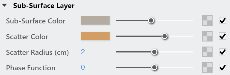

Sub-Surface Layer
Some of the options are available only in Advanced mode.
Sub-Surface Color – Specifies the general color for the sub-surface portion of the material. For more information, see the Sub Surface Color example below.
Scatter Color – Specifies the internal scattering color for the material. Brighter colors cause the material to scatter more light and appear more translucent; darker colors cause the material to look more diffuse-like. For more information, see the Scatter Color example below.
Scatter Radius (cm) – Determines the specular color of the material. For more information, see the Scatter Radius example below.
Phase Function – A value between -1.0 and 1.0 that determines the general way light scatters inside the material. Its effect can be somewhat likened to the difference between diffuse and glossy reflections from a surface, however, the phase function controls the reflection and transmittance of a volume. A value of 0.0 means that light scatters uniformly in all directions (isotropic scattering); positive values mean that light scatters predominantly forward in the same direction as it comes from; negative values mean that light scatters mostly backward. Most water-based materials (e.g. skin, milk) exhibit strong forward scattering, while hard materials like marble exhibit backward scattering. This parameter affects most strongly the single scattering component of the material. Positive values reduce the visible effect of a single scattering component, while negative values make the single scattering component generally more prominent. For more information, see the Phase Function example or the Phase Function: Light Source example below.

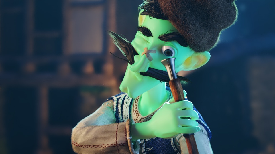

Example: Sub-Surface Color
This example and the next demonstrate the effect of and the relation between the Scatter Color and the Sub-Surface Color parameters. Note how changing the Sub-surface color changes the overall appearance of the material, whereas changing the Scatter Color only modifies the internal scattering component. For all three renders, the Scatter Color is set to green.
Sub Surface Color = Red
Sub Surface Color = Green
Sub Surface Color = Blue

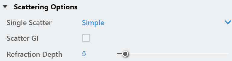

The options in this rollout allow you to control the quality of the final result. This rollout is available only in Advanced mode.
Single Scatter – Controls how the single scattering component is calculated. For more information, please see the Single Scatter Presets example below.
None  No single scattering component is calculated.
Simple – The single scattering component is approximated from the surface lighting. This option is useful for relatively opaque materials like skin, where light penetration is normally limited.
Raytraced (solid)   The single scattering component is accurately calculated by sampling the volume inside the object. Only the volume is raytraced. No refraction rays on the other side of the object are traced. This option is useful for highly translucent materials like marble or milk, which are relatively opaque at the same time.
Raytraced (refractive) – Similar to the Raytraced (solid) mode with traced refraction rays. This option is useful for transparent materials like water or glass. In this mode, the material also produces transparent shadows.
Scatter GI – Controls whether the material accurately scatters global illumination. When disabled, the GI is calculated using a simple diffuse approximation on top of the subsurface scattering. When enabled, the GI is included as part of the surface illumination map for multiple scattering. The latter is more accurate for highly translucent materials but may slow down the rendering quite a bit.
Refraction Depth – Determines the depth of refraction rays when the single scatter parameter is set to Raytraced (solid)
