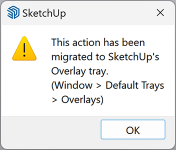

Accessing Scatter Viewport Preview from the V-Ray Toolbar or the V-Ray Menu in Sketchup 2023 or later versions opens the following notification.
SketchUp2023_VRay6.2_Toolbar_Scatter_ViewerNotification
||Window|| > Default Tray > Overlays > Scatter Viewport Preview

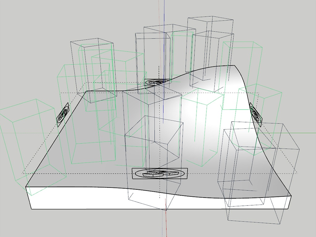

Preview Mode – Changes between a bounding box or point preview for the instances. Note that the origin of the guest determines the point positions. See the Preview Mode examples below.

Example: Preview Mode
This example shows the different preview modes.
Scatter_Guest_Objects
Scatter Guest Objects
Scatter_Host_Object
Scatter Host Object
Point_Preview_Mode
Point Preview
Bounding_Box_Preview
Bounding Box Preview
