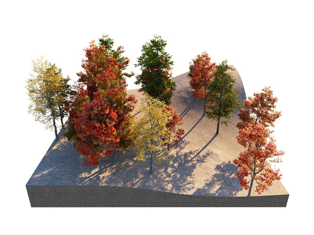

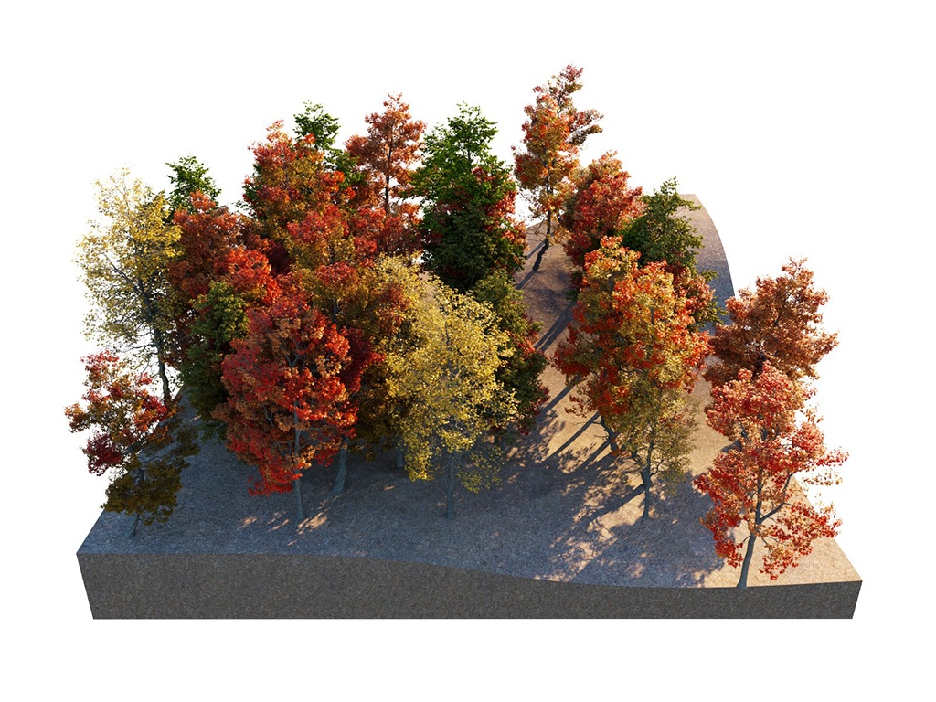

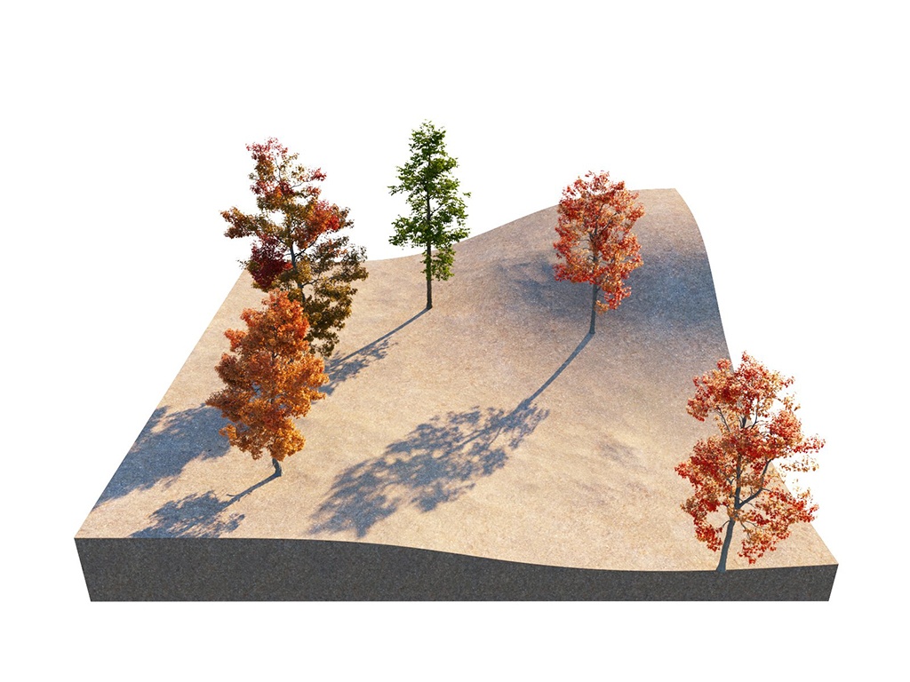

Example: Max Count (Limit)
Max Count (Limit) is a limit to help avoid creating too many instances and overloading the system. This option has no effect if the Instance Count value is lower than the Max Count value. Depending on the hardware, this limit can be adjusted to ensure smooth performance and avoid excessive memory consumption. At Instances Count - 100, the scattered objects do not exceed the Max Count (Limit) - 50 and the render is the same as when the Instances Count is 50. Scattering Mode = 2D On Surfaces; Max Count (Limit) = 50.
02_MaxCount_50_InstancesCount_5
Instances Count = 5
03_MaxCount_50_InstancesCount_25
Instances Count = 25
04_MaxCount_50_InstancesCount_50
Instances Count = 50
