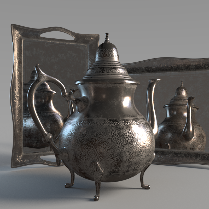

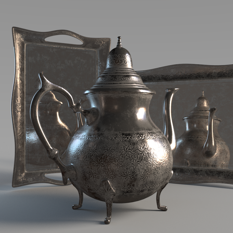

Result Render
The renders below show changes in the reflection of the teapot and the trays, depending on the environment priority value we set. The texture map with the highest priority (2) overrides the global Environment map (which is a Gradient map in this case) as well as the Environment maps of the objects with lower environment priorities 1 and 0. This can be seen in the reflections of the objects with lower environment priorities.
Horizontal Tray = 1, Vertical Tray = 0, Teapot = 0
Vertical Tray = 2, Horizontal Tray = 1, Teapot = 0
