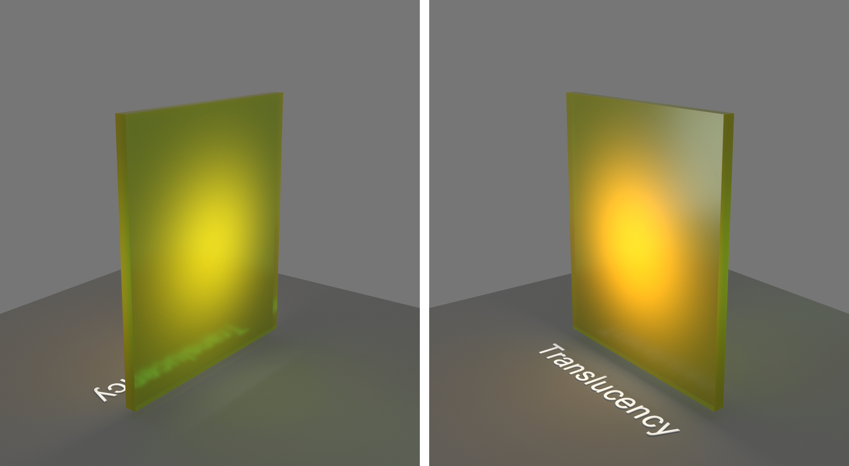

Type – Selects the algorithm for calculating translucency (also called sub-surface scattering). Note that refraction must be enabled for this effect to be visible.

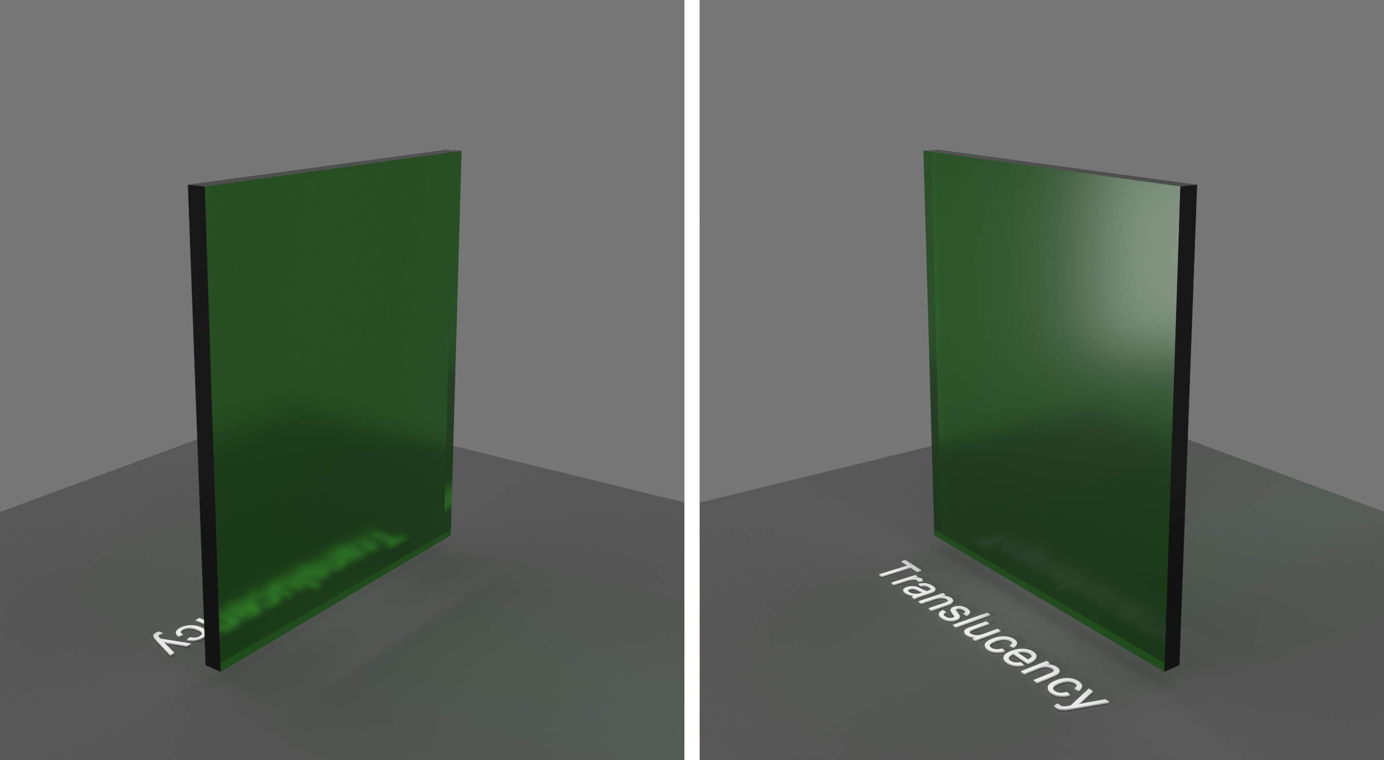

None – When selected, the only available parameters are the Fog Color and Fog Depth. Together with the Refraction Color, they determine the attenuation of light as it passes through the material. In this mode, there is no subsurface scattering.
A material with white refraction color and green fog color tints the rays as they pass through the material but otherwise, there is no light scattering inside.

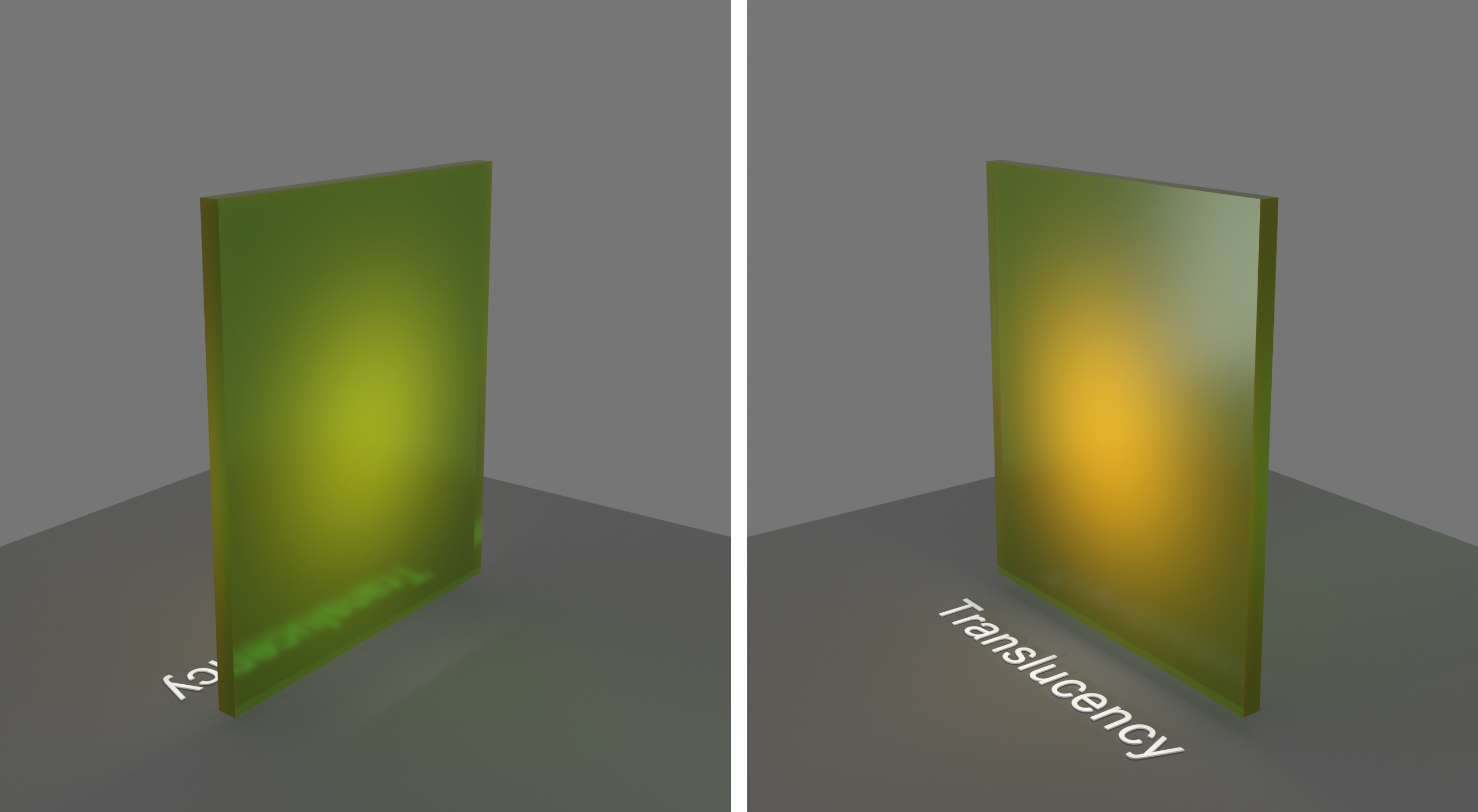

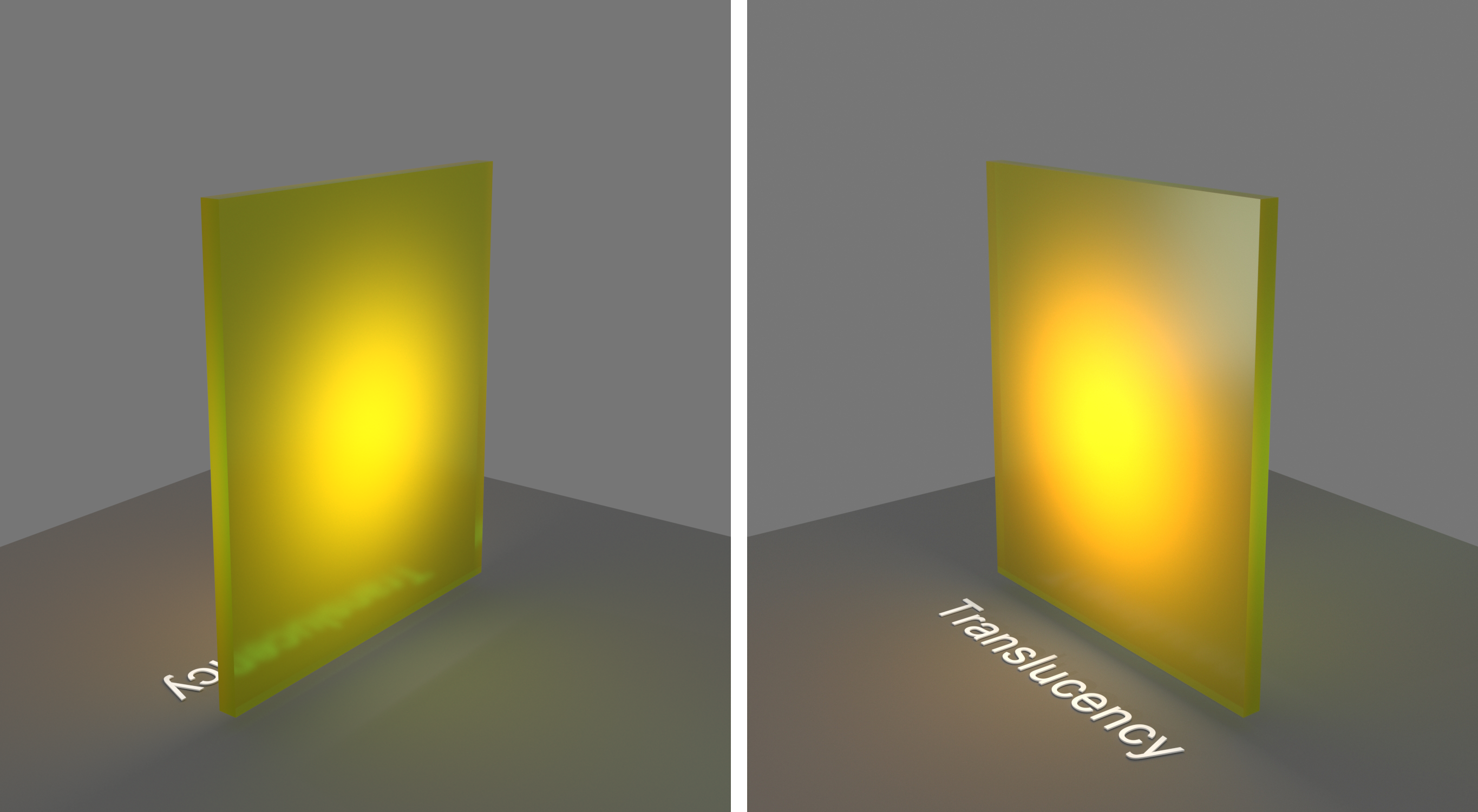

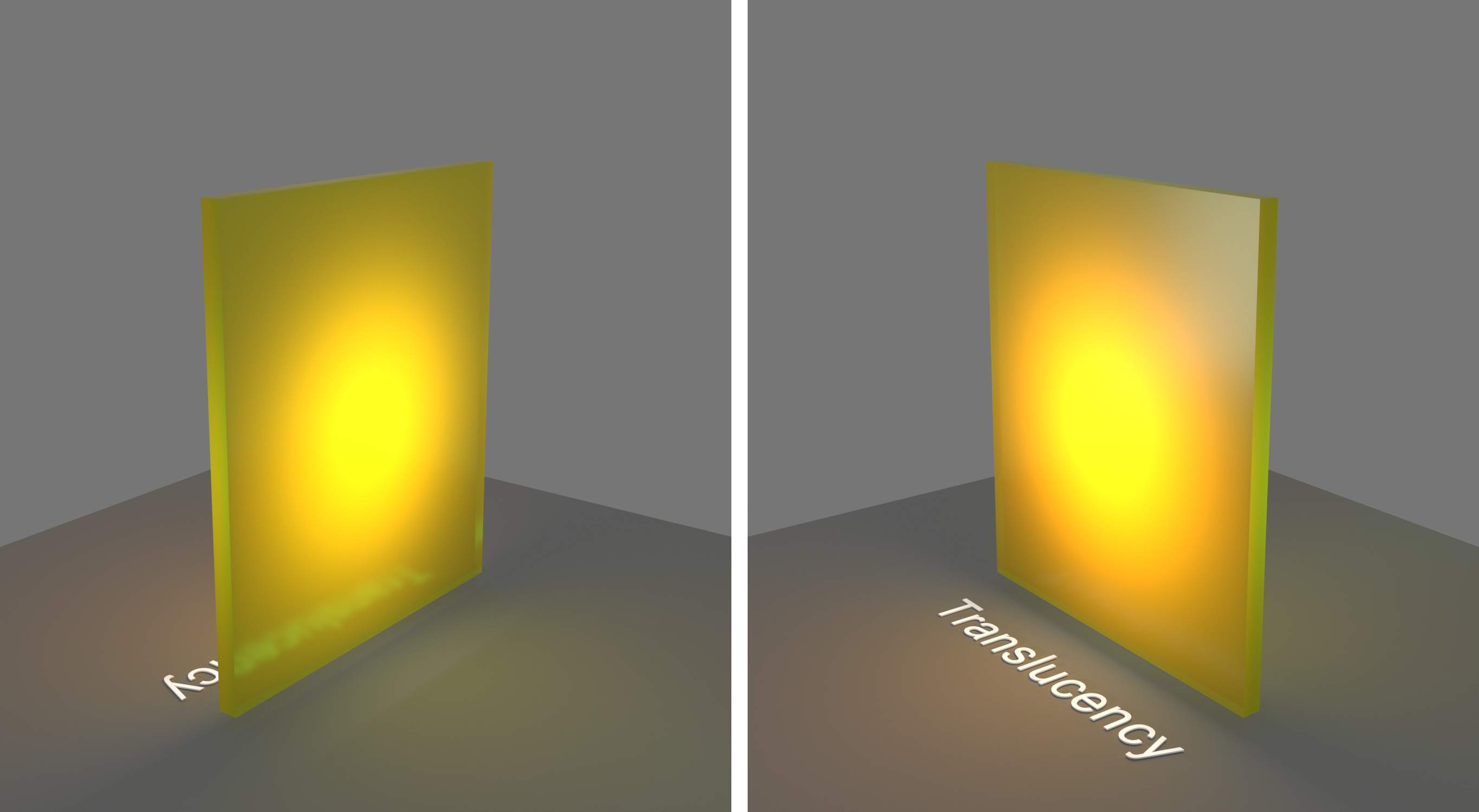

Volumetric – Works together with the Refraction Color of the material to scatter light inside the object. It is useful for liquids and other highly transparent materials. The Refraction Color and Refraction Glossiness determine respectively how much of the interior of the object is visible and how rays interact with the object’s surface.
In this example, you can see the same material as the one in the None mode example but with Volumetric mode enabled with a yellow Scatter Color, at various Amounts.
Amount = 1
Amount = 0.75
Amount = 0.5
Amount = 0.25
Amount =0

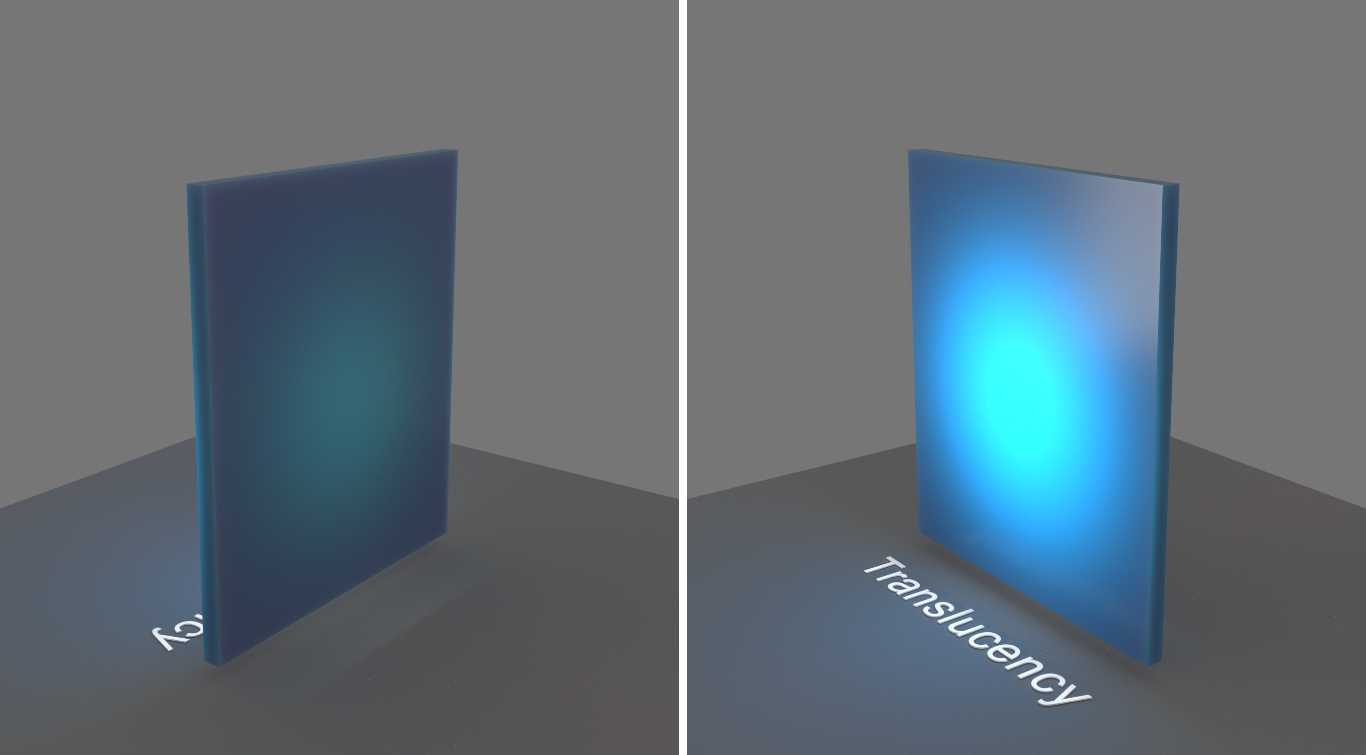

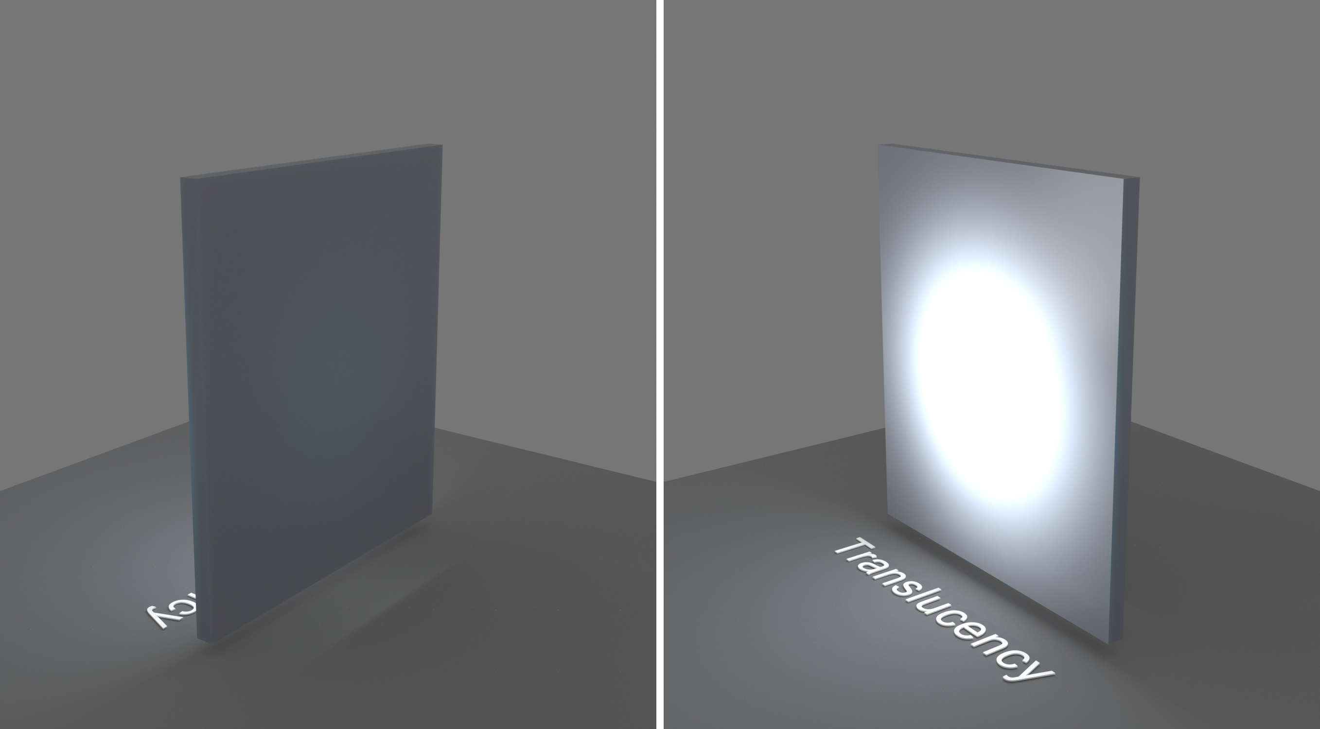

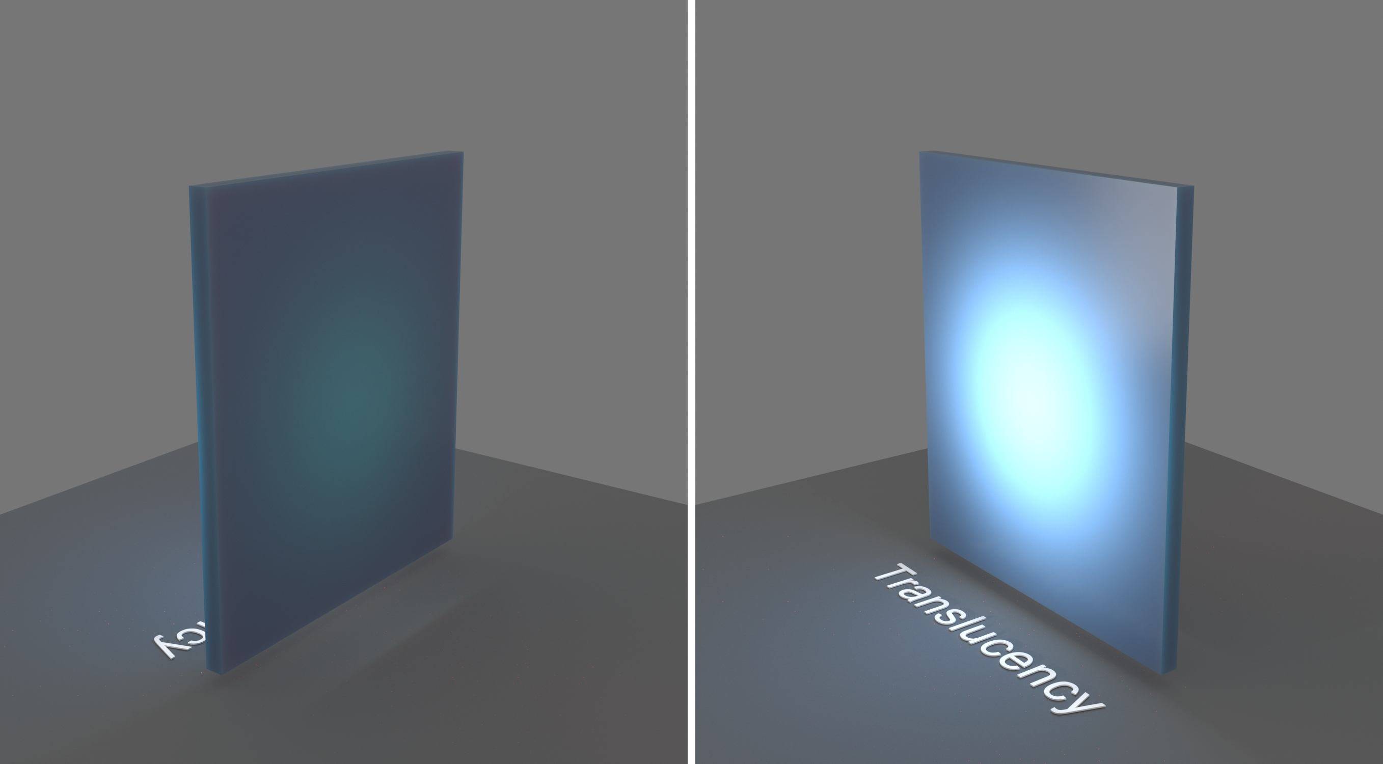

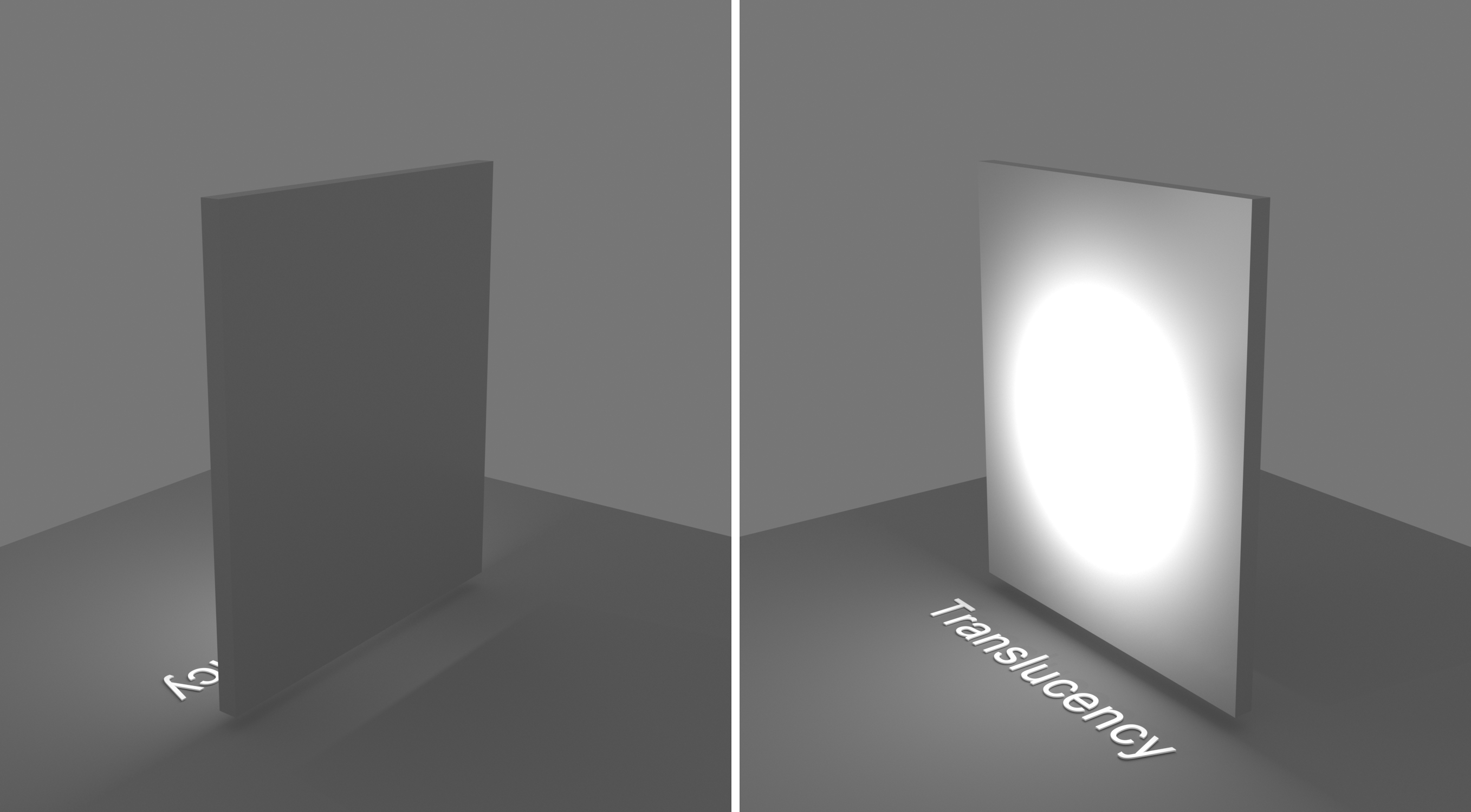

SSS – Works independently of the Refraction Color/Glossiness and is useful for skin, wax, marble and other relatively opaque materials.
A material with no refraction (black color) and light color for the Fog Color is used with blue Scatter Color, which is scattering inside the volume of the object.
Amount = 1
Amount = 0.75
Amount = 0.5
Amount = 0.25
Amount = 0
