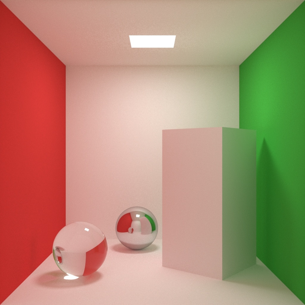

Here is a scene rendered with different GI algorithms in V-Ray. Combining the different GI engines allows great flexibility in balancing time versus quality of the final image.
Note that the render time depends on the hardware, build version, and the scene itself. These are general guidelines to help you find the best method for your specific case.
Brute force GI, 4 bounces
The image is darker because only 4 light bounces are computed. Notice the grain and the long render time.
Render time: 1 min 10 sec
Irradiance map + Brute force GI, 4 bounces
The image is darker because only 4 light bounces are computed. The grain is gone, although the GI is a little blurry.
(see the GI caustics below the glass sphere)
Render time: 0 min 24 sec
Brute force GI + Light cache
There is some grain in the GI, but it is a lot faster than Brute force GI alone.
Render time: 0 min 13 sec
Irradiance map + Light cache
Render time: 0 min 7 sec
Irradiance map + Light cache with GI caustics enabled
Notice the slowdown due to the caustics.
Render time: 0 min 8 sec

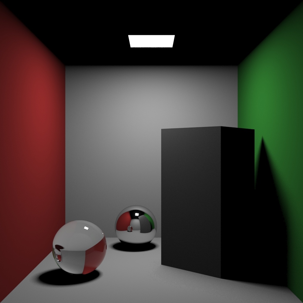

Light Bounces
This example shows the effect of the number of light bounces on an image:
Direct lighting only: GI is off
1 bounce: brute force, no secondary GI engine
2 bounces: irradiance map + brute force GI with 1 secondary nounce
4 bounces: irradiance map + brute force GI with 3 secondary bounces
8 bounces: irradiance map + brute force GI with 7 secondary bounces
Unlimited bounces (complete diffuse lighting solution): irradiance map + light cache

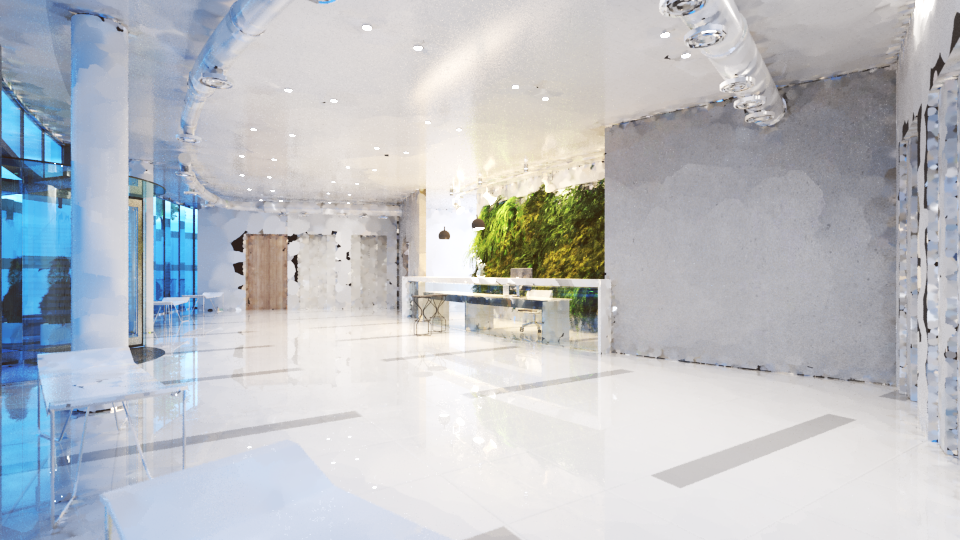

Avoiding flickering in animations
Since the light cache is a biased GI solution, it can introduce some unwanted flickering in animations. Below are some tips to reduce this effect.
  • For flickering due to an animated camera, for short camera moves, an easy fix is to enable the Use camera path option. To remove flickering for longer camera moves where the camera is the only animated part of the scene, precalculate the light cache using Fly-through mode and then use the saved cache for the entire animation.
  • For interior renders or other complicated lighting situations, increasing the light cache Subdivs parameter makes the light cache smoother and more accurate; values around 2000 or 3000 typically work well.
  • The Retrace option helps to reduce light leaks and flickering. For animations, a value of 8.0 works well.
  • Prefiltering also smooths the light cache and reduces flickering. A Pre-filter value of 20 works well.
