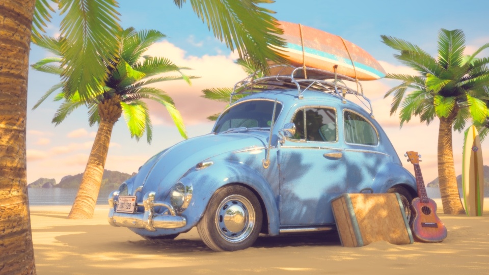

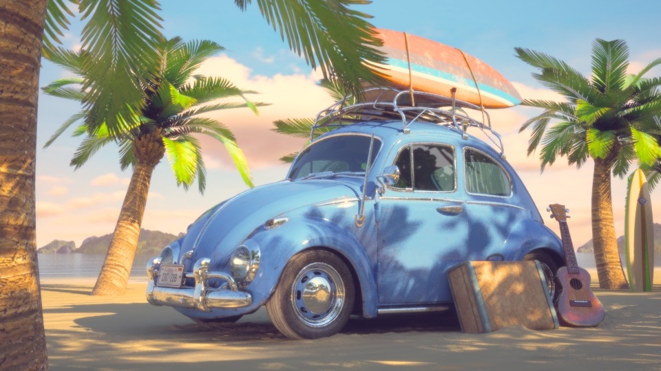

GI texture
A color or map used during Indirect Illumination(GI) calculation. The image on the right is more yellow and brighter than the Sky image override used in the image on the left.
GI Texture set to Sky
GI Texture set to default color (HSV 210, 0.2, 1)
GI texture override effect on GI Render Element
More sky-appropriate lighting coloration seen in Sky texture GI override than in the single default color override.
