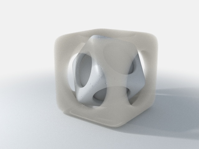

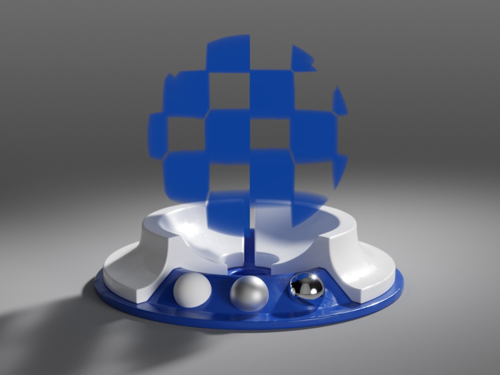

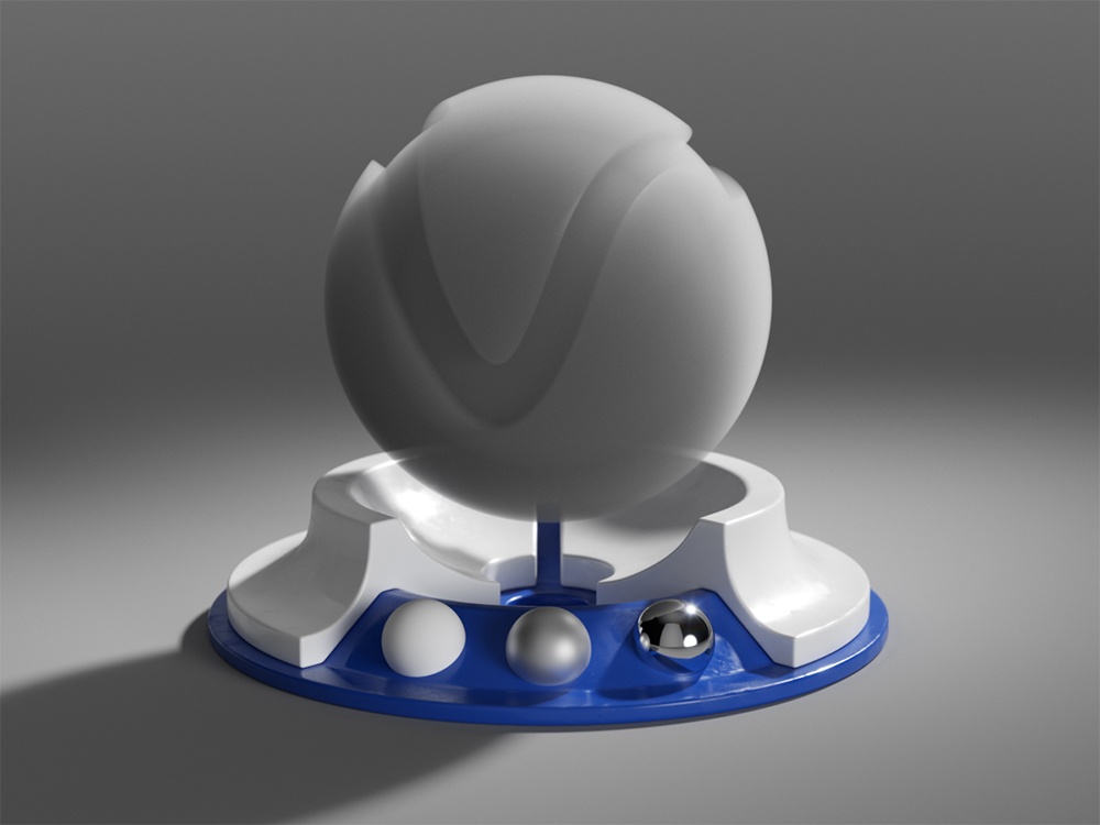

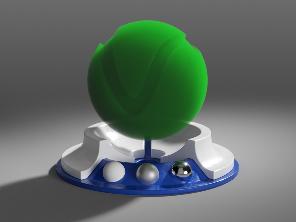

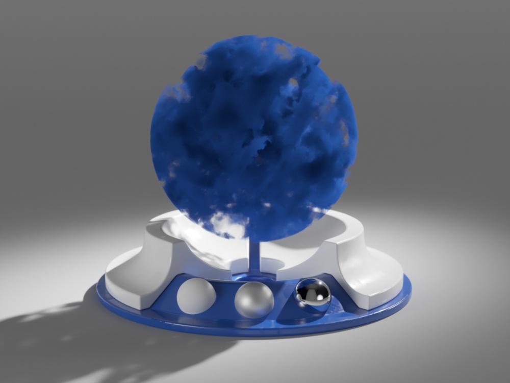

Fog color

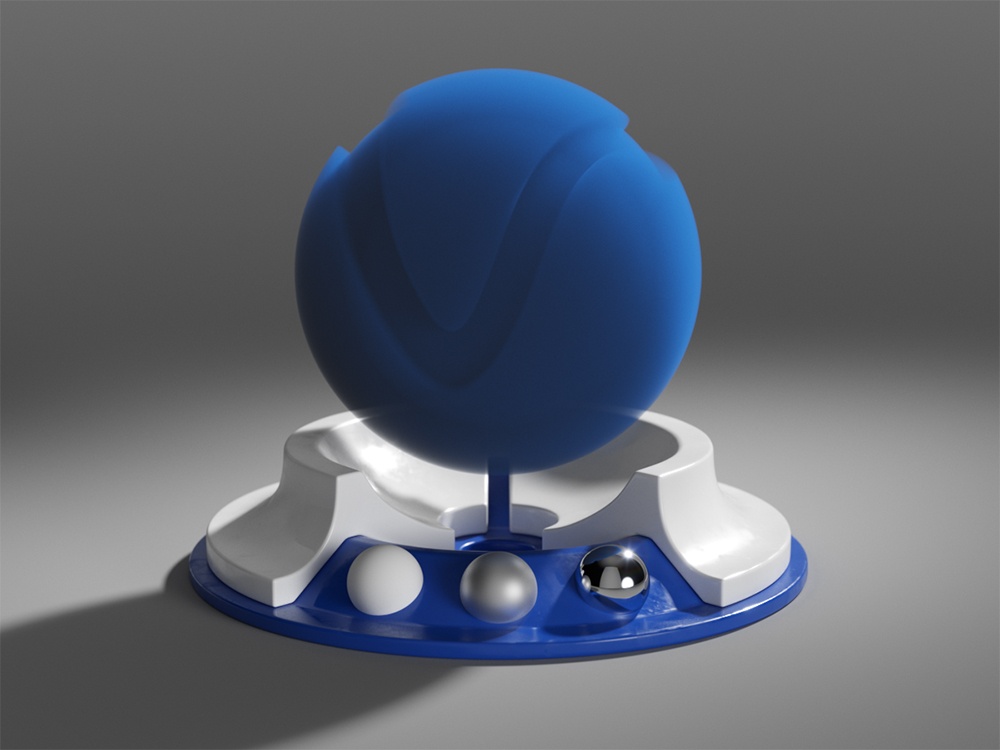

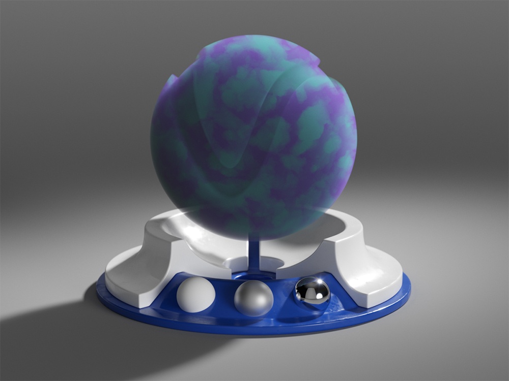

This example demonstrates the effect of the fog Color. Note how color only changes the way the volume reacts to light, and not the volume transparency. A sphere shaped as the V-Ray logo has been used to confine the fog volume with the Environment Fog set as the Volume material in the shading group of the sphere. The opacity of the sphere's Surface material has been set to be 100 transparent by changing its Opacity Map to a black color. This means the Surface material has no contribution to the shading of the sphere, only the Environment Fog material.
For the last 2 images, the fog Color has been mapped with a texture. World XYZ mapping type was used for the textures.
fog color = white
fog color = green

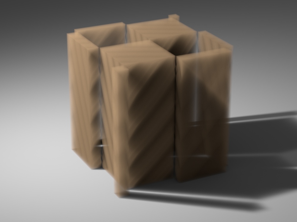

A Gradient Ramp texture with Solid interpolation. The fog density is mapped with a checker texture. |
A Noise texture with Turbulence type
Move the slider to see the example renders. |

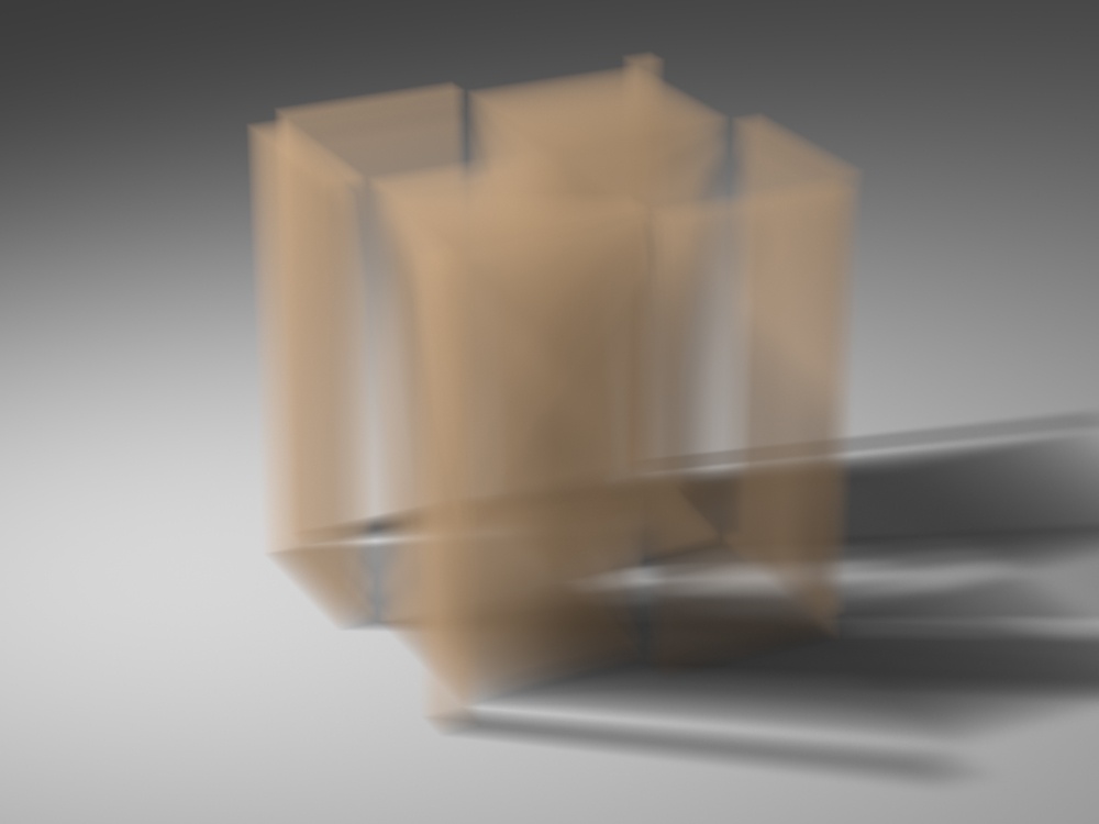

This example demonstrates the effect of the Fog distance parameter. Note how larger values make the fog more transparent. A sphere shaped as the V-Ray logo has been used to confine the fog volume with the Environment Fog set as the Volume material in the shading group of the sphere. The opacity of the sphere's Surface material has been set to be 100 transparent by changing its Opacity Map to a black color. This means the Surface material has no contribution to the shading of the sphere, only the Environment Fog material.
Fog distance is 0.1 Fog density is mapped with a noise texture |
Fog distance is 0.5 Fog density is mapped with a noise texture |
Fog distance is 2.5 Fog density is mapped with a noise texture |

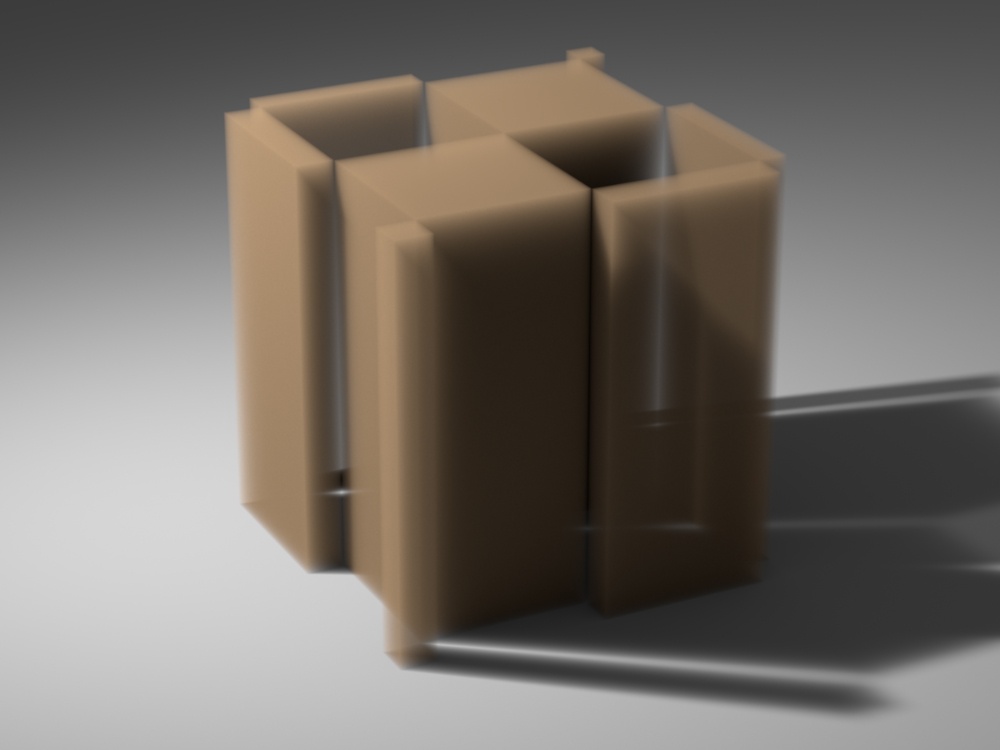

Fog distance is 0.5 No texture in the fog density |
Fog distance is 0.5 Fog density is mapped with a checker texture |

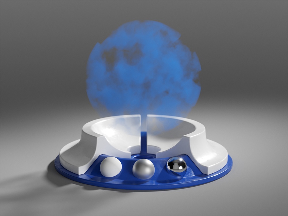

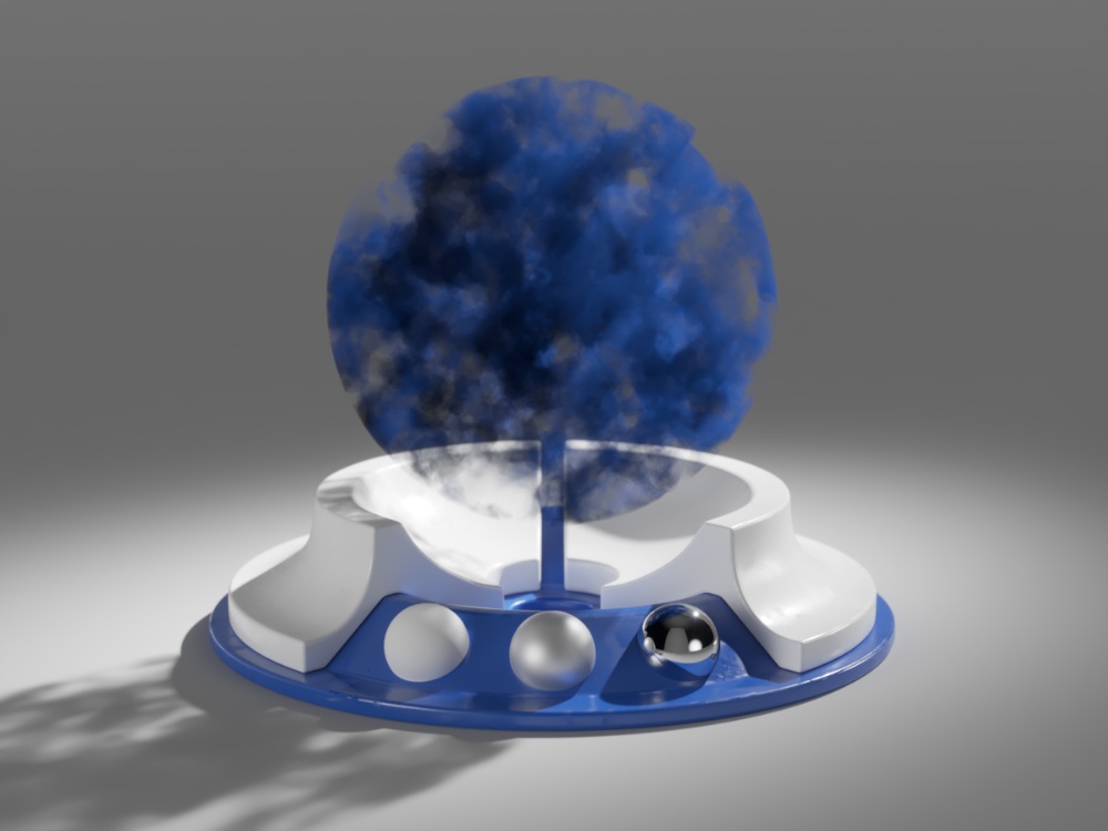

Fog emission
This example demonstrates the effect of the Emission parameter. The Fog color is gray so as to better show the effect of the emission. Note that since we also have GI enabled, the fog emission causes the volume to illuminate both itself and other objects around it. The fog density is mapped with a Checker texture. A sphere shaped as the V-Ray logo has been used to confine the fog volume with the Environment Fog set as the Volume material in the shading group of the sphere. The opacity of the sphere's Surface material has been set to be 100 transparent by changing its Opacity Map to a black color. This means the Surface material has no contribution to the shading of the sphere, only the Environment Fog material.
In the last two renders, the Emission has been mapped with a texture. The Color is gray to better show the light scattering inside the volume, produced by the global illumination.
 Fog emission is black (no emission), Fog color is gray
 Fog emission is dark blue, Fog color is gray
 Fog emission is dark blue, Fog color is black (only the fog emission affects the image)
 Fog emission is mapped with a Gradient Ramp texture Fog color is gray
 Fog emission is mapped with a red Noise texture with Turbulence type Fog color is gray

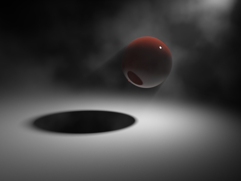

GI scattering is especially important when creating cloud-like volumes. For example, compare the following two images, done with and without GI scattering.
Global illumination is off
Global illumination is on with Scatter GI on and Scatter bounces set to100
The following example shows GI scattering inside a smoke volume. The volumetric textures (density and emission) for this example are provided from a fluid dynamics simulation in the form of 3D textures. Note how GI scattering causes the smoke to be naturally illuminated by the fire in the second row of images.

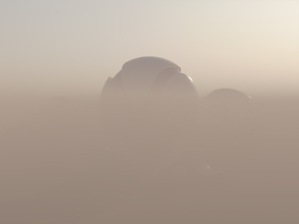

Fog height
When there are no geometry nodes connected to Environment Fog, the volume occupies space downward from a certain height along the scene's up-axis, determined by the Fog height parameter. The following examples demonstrate this. Note that as the Fog height is increased, the scene becomes darker - this is because the sun is blocked by a larger amount of fog. This can be corrected by increasing the Fog distance parameter and thus making the fog more transparent. Note also the sudden decrease of brightness when the camera is included inside the fog volume.
Fog distance = 0 Fog height = 0 |
Fog distance = 50 Fog height = 10 |
Fog distance = 50 Fog height = 15 |
Fog distance = 50 Fog height = 20 |
Fog distance = 50 Fog height = 50 |

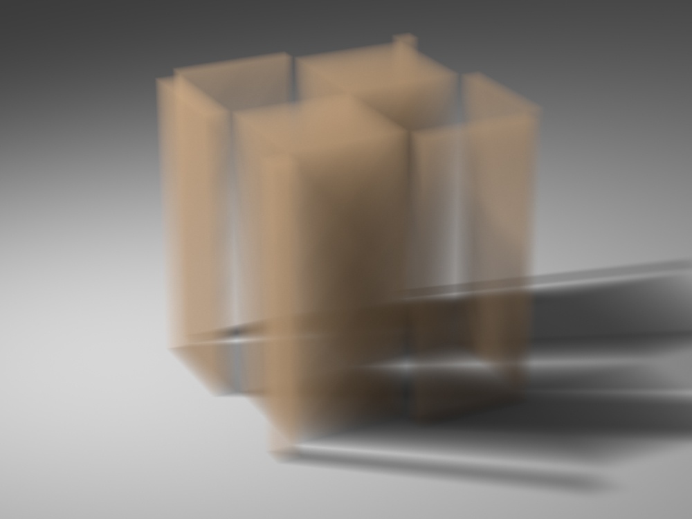

When any of the parameters (density, color or emission) is mapped with a texture, VRayEnvironmentFog uses a raymarching algorithm to compute the intersection of a ray with the volume.

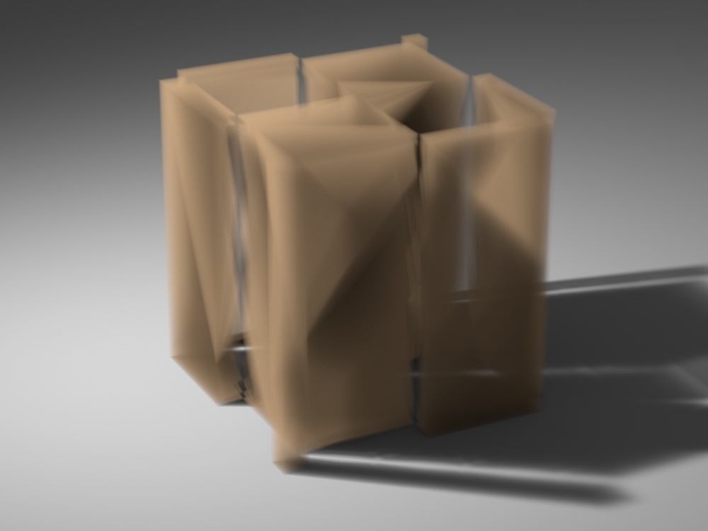

The following examples demonstrate the effect of the Step size parameter. A Box is used to confine the volume, and the density is mapped with a Checker texture. Note how smaller values cause less noise and smoother shading of the volume. Note also that denser volumes require smaller values of the Step size parameter in order to produce a smooth result compared to more transparent volumes. In general, values for the Step size that are 2 to 3 times smaller than the Fog distance parameter work okay in most cases.
Step size is 0.1 Fog distance = 5.0 |
Step size is 0.5 Fog distance = 5.0 |
Step size is 1.0 Fog distance = 5.0 |
Step size is 2.5 Fog distance = 5.0 |
Step size is 5.0 Fog distance = 5.0 |
Step size is 10.0 Fog distance = 5.0 |
Step size is 0.4 Fog distance = 20.0 |
Step size is 2.0 Fog distance = 20.0 |
Step size is 4.0 Fog distance = 20.0 |
Step size is 10.0 Fog distance = 20.0 |
Step size is 20.0 Fog distance = 20.0 |
Step size is 40.0 Fog distance = 20.0 |

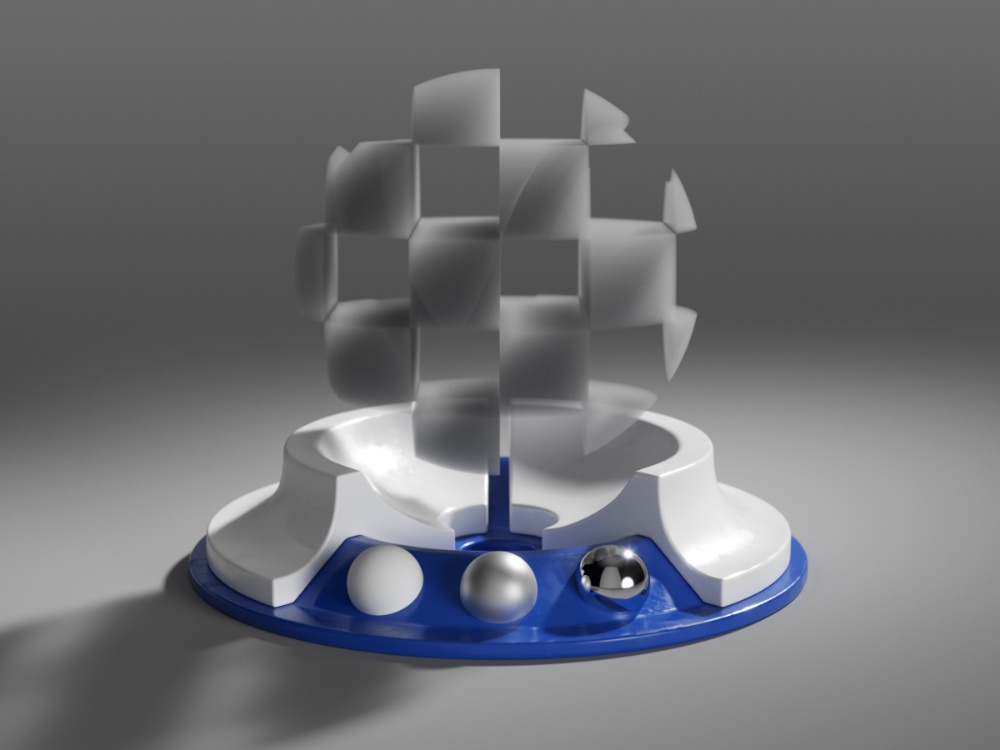

Gizmo nodes
When there are gizmos connected to VRayEnvironmentFog , then the volume is confined only inside the specified atmospheric gizmos and the Fog height parameter is ignored.

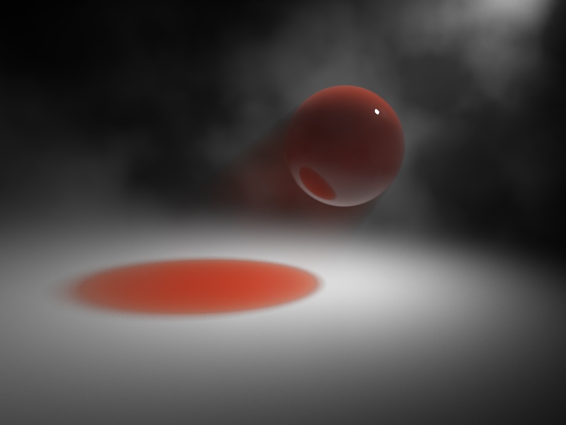

Volumetric caustics
This example demonstrates volumetric caustics and colored shadows with different settings.
Caustics are off, Affect shadows for the sphere material is off |
Caustics are off, Affect shadows for the sphere material is on |
Caustics are on |
Caustics are on, and the Fog density is mapped with a Smoke texture |
The quality of the volumetric caustics depends on the sampling of the volume fog, on the V-Ray caustics settings, and the caustics settings for the light. In both images below, all parameters are same with the exception of the caustics subdivs for the light in the light settings dialogue. Note how the more photons are shot, the more defined the caustics are. In this example, we also have the caustics Max. density parameter set to 0.3 in order to limit the photon density in the caustics map. This saves memory and makes the rendering faster, although it limits the spatial resolution of the caustics (in our case, to 0.3 scene units).
Compare the two examples where the light has 1000 Caustics subdivs (500,000 caustics photons are shot) and 200 Caustics subdivs (20,000 caustics photons are shot).
Note the broken caustics beam in the example with 1000 Caustics subdivs - this is not because there are not enough caustics photons, but because we don't have enough samples for the fog itself.

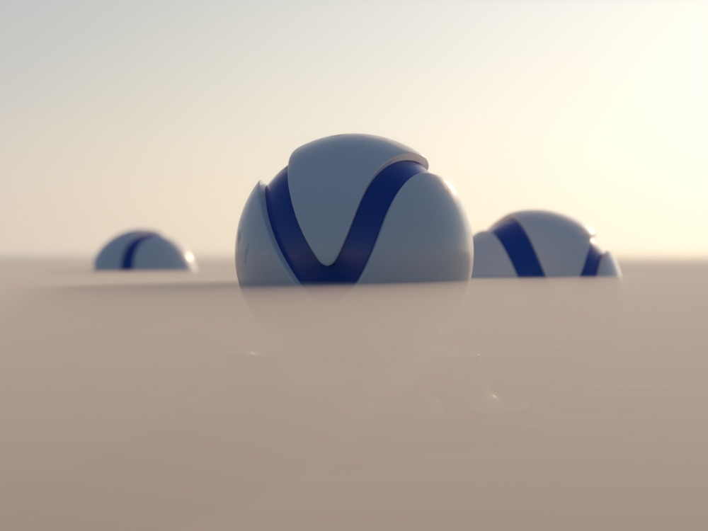

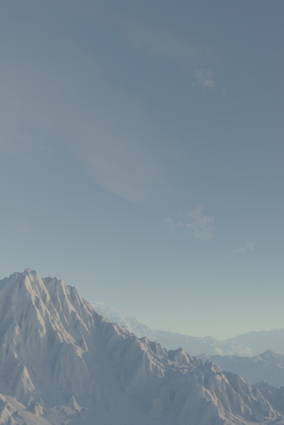

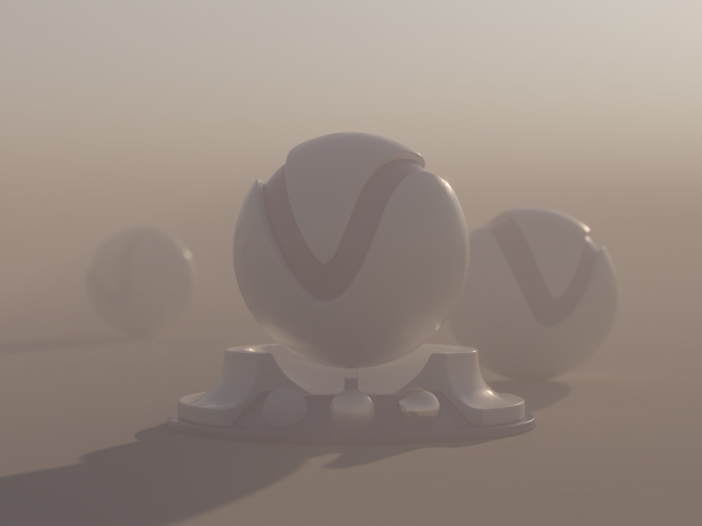

Aerial Perspective
The following example is rendered using this scene. Check the comments inside to understand different parameters of the plugin.
When using EnvironmentFog with weak lights, it may be necessary to turn down the Cut-off threshold parameter of the lights. The default value for this parameter works fine for surfaces, but for volumes, where a lot of weak light contributions are added together, it may produce a visible sharp boundary where the light calculations stop. V-Ray does not have separate global illumination maps for volumetric rendering. Instead, all GI engines (the irradiance map, light cache, global/caustics photon maps) have been modified to support volumetric data. |
