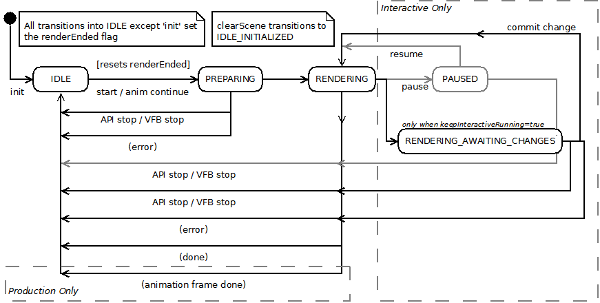

State Changed Event
The state change event is emitted every time the renderer transitions from one state to another, such as when starting to render, when the image is done or when an error occurs and it stopped (see diagram). This is the main point to implement user logic related to initiating and completing renders.
State Changed Diagram
Unless startSync() is used instead of the asynchronous start() method, no changes should be made to the scene and renderer while in the PREPARING state before transitioning out of it. Attempting to make changes will be rejected.
The final image is available when the renderer gets to the IDLE_DONE state. Intermediate images are also available during rendering.

XII. Animations
V-Ray AppSDK supports rendering of animated scenes. Animated scenes contain animated plugin properties. A plugin property is considered animated if it has a sequence of values - each for a specific time or frame number. This defines key frames and in the process of sampling, interpolation is done between the values.
One can obtain the current frame number from the frame property of the renderer and the current time from the time property. The renderer gets into the IDLE_FRAME_DONE intermediate state when a frame is done and there are more frames after it. To continue rendering the next frame, the continueSequence method of the renderer must be called. After the final frame it becomes IDLE_DONE.
void onStateChanged(VRayRenderer& renderer, RendererState oldState, RendererState newState, double instant, void* userData)
