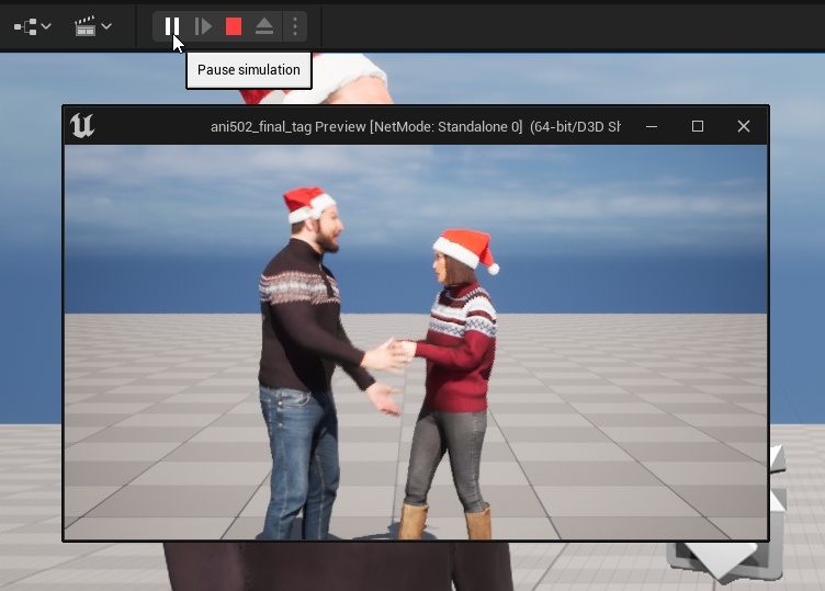

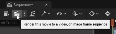

Despite not being previewed as animated when the play button from the Sequencer is used, notice that the actors do appear as animated when the animation is rendered, only the preview is not animated. To verify this, you can make a simple test video using the quick render button from the Sequencer:
You should get something like this:

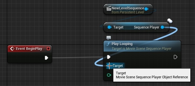

We propose you a 3rd solution that is a bit more complex but also ends up creating a more intuitive workflow, similar to the one you have in standard 3D apps. If you want to get similar behavior to a regular 3D application, please follow this process:

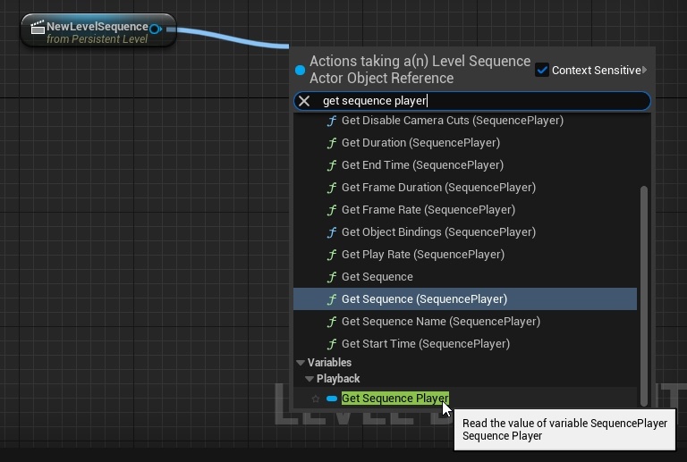

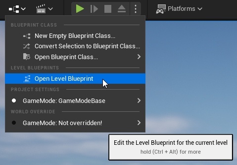

  1. Open the Level Blueprint.

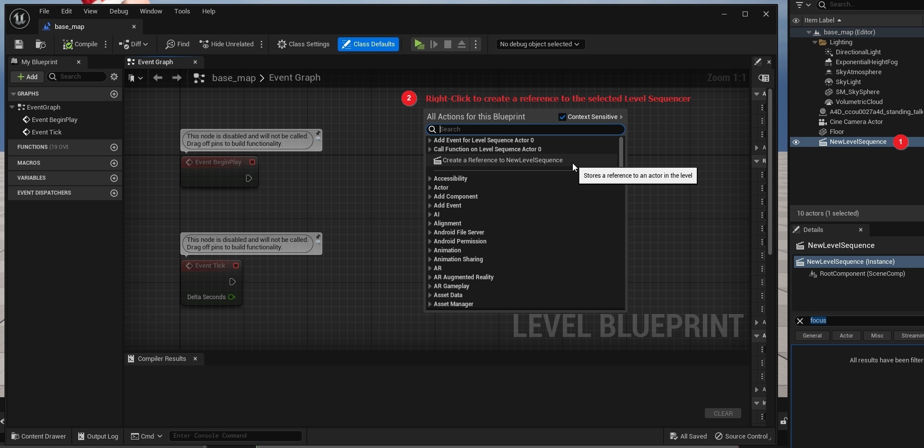

2. Select your sequencer in your World Outliner, where you already have set up all your cameras, and add it to the Blueprint.
3. Once you have it, add a "Get Sequence Player" to its main blue connector:
4. Then go to the "Event BeginPlay" and drag out from that white triangle to add a new function called "Play Looping".You might need to disable the "Context Sensitive" check to be able to see it listed.
5. Now connect the Sequence Player to the Target of the Play looping.

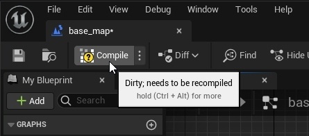

6. Finally, compile and save the blueprint.
And that's it. Now, when you click the Play button from the main toolbar. You will see the animations of the actors through the cameras that you have set up in your Level Sequence.

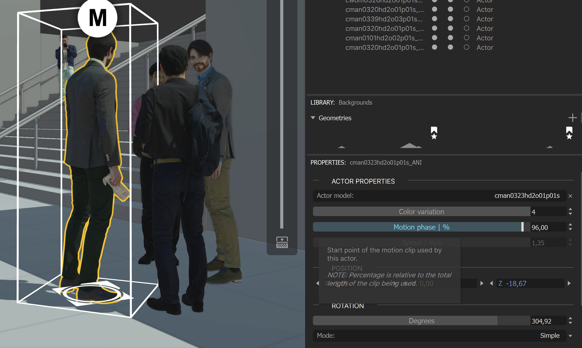

How to Offset the Animation of the 4D Models
You can use the motion clip Phase parameter to offset the animation, either in anima®:

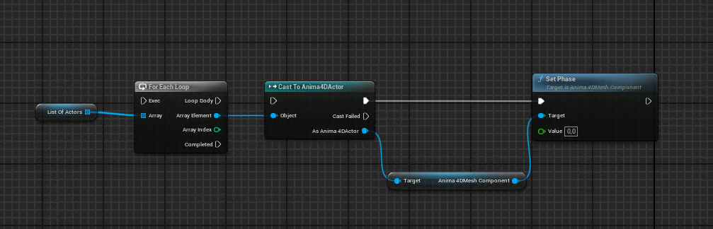

Also, you can use blueprints to automatically apply an arbitrary phase to an array of 4D models:

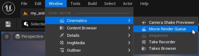

To start using the Movie Render Queue, you just need to enable it in the Plugins window:
After that, you will find it here:

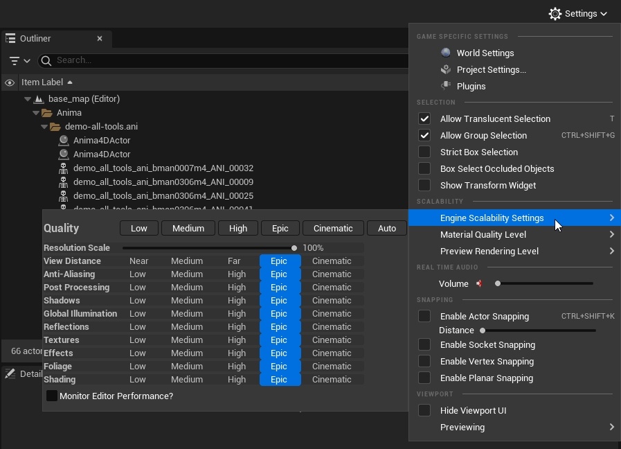

In UE there are different levels of quality in the viewport that can be managed in the Engine Scalability Settings, here:
By default, all viewports are configured to use the Epic mode. However, when you render an animation using the Sequencer, by default UE uses the Cinematic mode to take advantage of the fact that the fast Realtime response is not needed anymore, so it uses extra time to try to generate the best possible quality in the final video.
Our plugin uses the highest possible quality of texture and geometry in the 4D Digital Humans models when it is running in a Cinematic quality viewport, so you should expect slower frame rate times when rendering a sequence than when previewing the same animation in the Editor viewport.

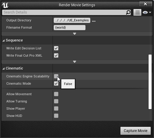

If you need to improve the performance of your sequencer, you can set UE to use the same Epic quality also in the Sequencer. This will decrease the Quality but significantly increase the rendering speed up to the same Realtime response that you can see by default in the Editor viewport. To do this, you must disable the "Cinematic Engine Scalability" parameter in the "Render Movie Settings" dialog that appears when you render your sequence:

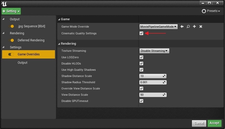

Or, if you are using the Movie Render Queue, it is also possible to disable the Cinematic Quality setting  (enabled by default) by adding a Game Override:
If you want to keep the Cinematic Quality for your environment but you still need an improvement in the render time performance, you can enable the plugin setting "Use 4d LODSystem in Cinematic" and that will dynamically change the Level of Detail of the 4D models as it is done by default when using the Epic Quality.
