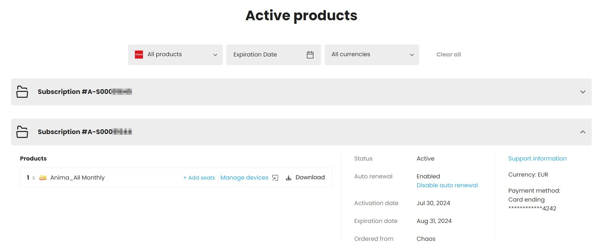

Once you have purchased a Subscription, you will find it on the products section in the MyChaos portal, under Products > Active products:
In there, if you click on the link Manage devices, you will go directly to your subscription admin panel on the AXYZ website:

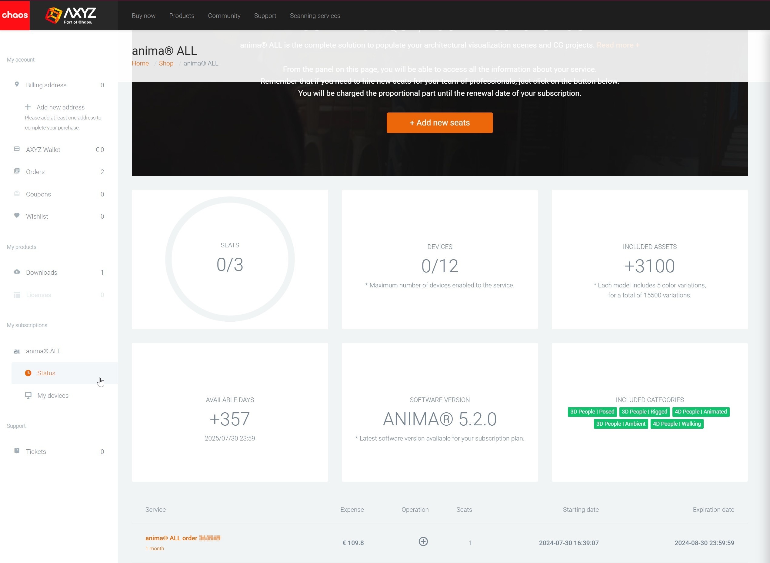

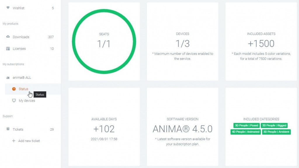

The first one, “Status“, gives you a quick overview of the current state of your subscription. Let’s see what exactly represents each of the 6 cells of this table:
SEATS
A seat is what was commonly known before as an anima® PRO license. We have changed its name to make it clear when we are talking about a PRO perpetual license or a PRO license that is actually linked to an anima® ALL subscription plan.
Please notice that all the plugins are also using the same license verification, so you will be occupying a seat either using the standalone application or rendering with any of our native plugins (3dsMax®, Maya®, Cinema4D®, or Unreal Engine®).
DEVICES
A device is a computer where you have installed a seat, that is, an instance of anima® ALL (formerly known as PRO) or any of its plugins.
INCLUDED ASSETS
This represents the current number of metropoly® models available in all the categories included in your subscription plan. Please notice that we are constantly adding new models to this library, so this is an approximate number that will be increased on a regular basis.
AVAILABLE DAYS
This is the number of days that remain on your subscription. The date that is shown below represents when your subscription will expire. Please note that, for more comfortable management, all your seats will always expire on the same date.
SOFTWARE VERSION
This shows the latest available version of anima® ALL. All the new versions of anima® will be automatically included in your subscription plan, always.
INCLUDED CATEGORIES
At this moment we only offer 1 subscription plan which includes all the types of models (categories) available in our metropoly® library. However, in the mid-term future, we are open to increasing the diversity of our subscription plans and offering different options including other combinations of categories.

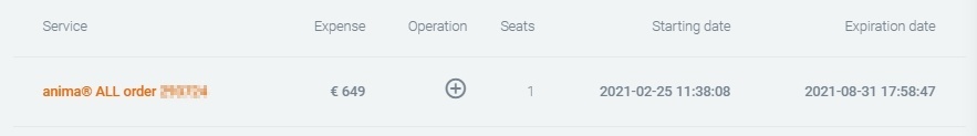

PURCHASE HISTORY
Below the 6-cell status table, you will find a transaction history that includes a list of all subscription-related Orders you have placed in your account.

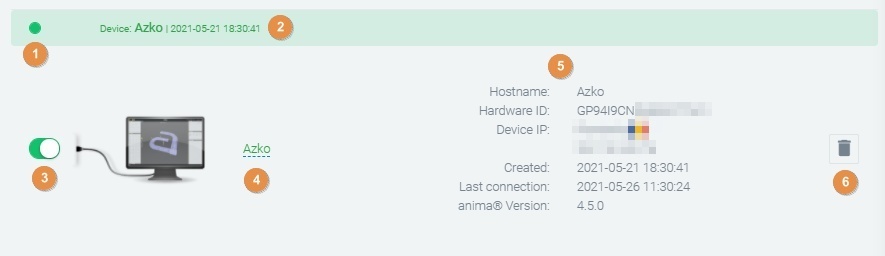

Connected Device
When anima® ALL device is being used in a device, it appears as connected in the list:
- This green dot means that the device is connected at this moment and occupies one of the Seats of the account.
- The title of each device includes the Hostname and the date when it was activated for the first time. The title is also shown in green when the device is using a seat.
- This switch will let you LOCK a device. In the LOCK section below you will find more information about why and when you might want to use this option.

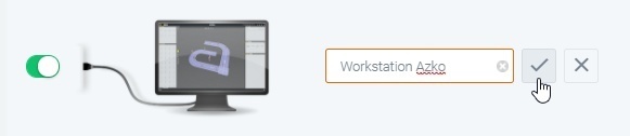

This is the custom name that you want to give to your device. By default, the hostname is shown, but you can modify it by just clicking the name.
- In this section, you will see the details of the device, including Hostname, Hardware ID, IP, creation date, last connection, and anima® version.
- Finally, the trash bin will let you remove this device from the account.

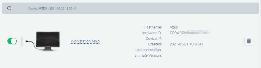

Disconnected Device
Once you close your instance of anima® ALL the device will appear as disconnected, with an empty dot and the title bar in grey.
