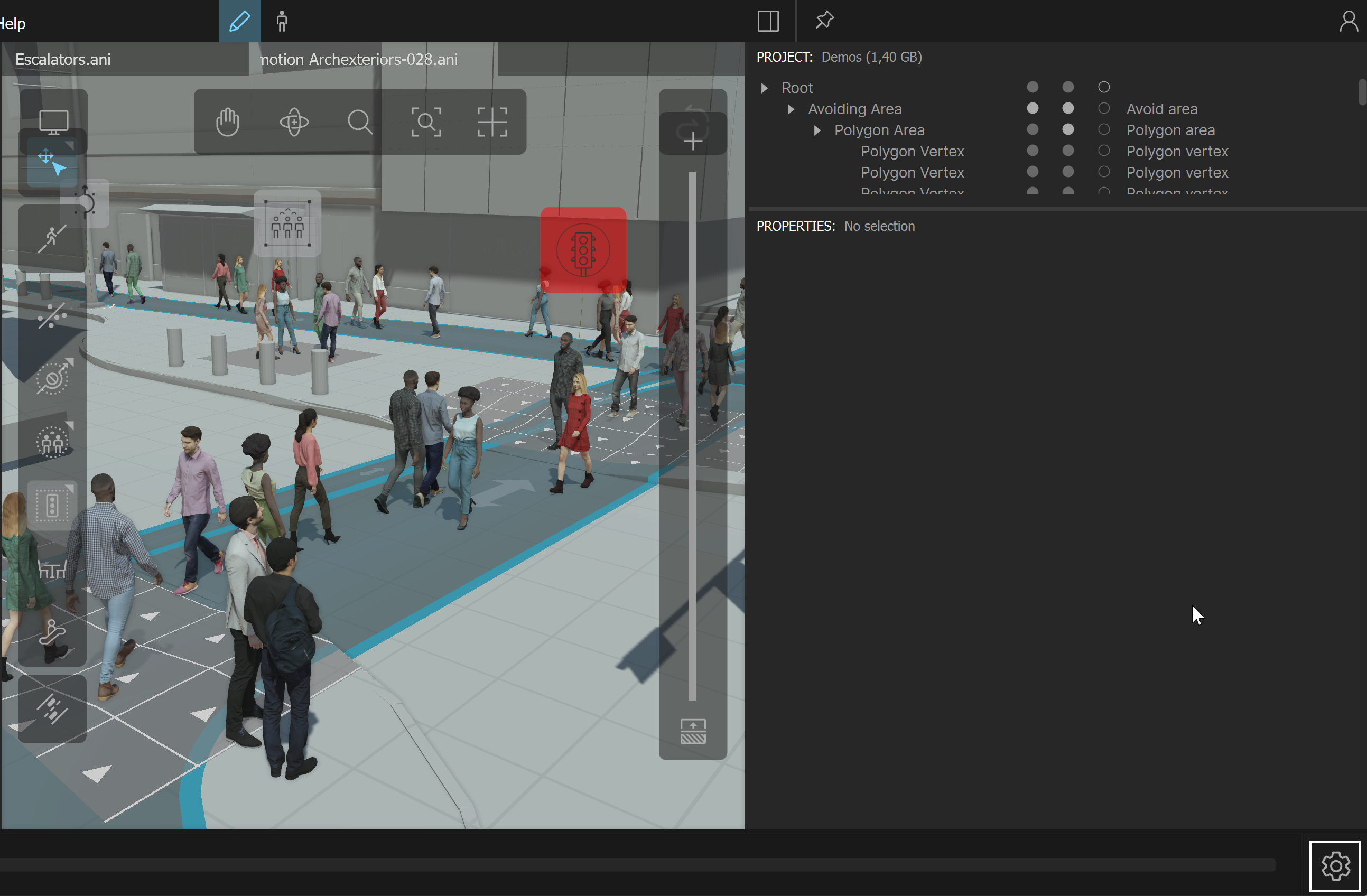

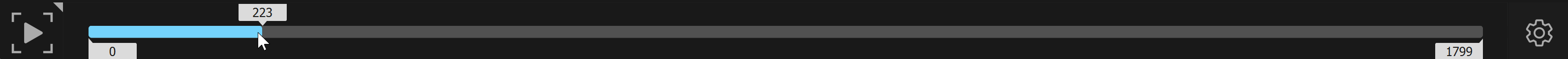

The time bar is found at the bottom of the interface. It has all the controls you need to play and simulate your animation, set the time span of the simulation, the framerate, and the playback speed. This interface can also be used to generate preview videos.
Play Click on the play button to preview the animation.
Playback Range Start - Click and drag this marker to set the starting point of the playback range. When previewing the animations will loop within the range set using these markers.
Current Frame Marker Shows the current frame number and position. Click and drag this marker to scrub playback.
Playback Range End – Click and drag this marker to set the starting point of the playback range.
Time Setup options Click this button to open the Time Setup options. Use these to set framerate, duration, playback speed, and preview render size.

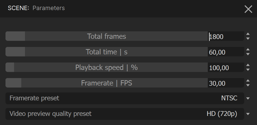

Time Setup
Total Frames Use this parameter to set the animation’s duration in frames. When you adjust this property the Total Time value will also update based on the current framerate.
Total Time Use this parameter to set the animation’s duration in seconds. When you adjust this property the Total Frames value will also update based on the current framerate.
Playback Speed Use values larger than 100% to speed up the animation and values less than 100% to slow it down.
Framerate Set a custom framerate.
Framerate Preset Choose a framerate from a list of common standardized presets.
Video Quality Preset Choose the resolution of the preview file produced when using Compute and Generate Video mode. Options are low (360p), medium (720p), high (1080p) and UHD (4k).

Go to the Time Setup options located in the lower right corner of the Anima screen.
Click the Settings icon and the Time Setup window will appear.
To achieve the desired effect, you can adjust the Playback Speed by dragging the slider or entering a specific number for greater precision.
The default value 100% will always play back at normal speed.

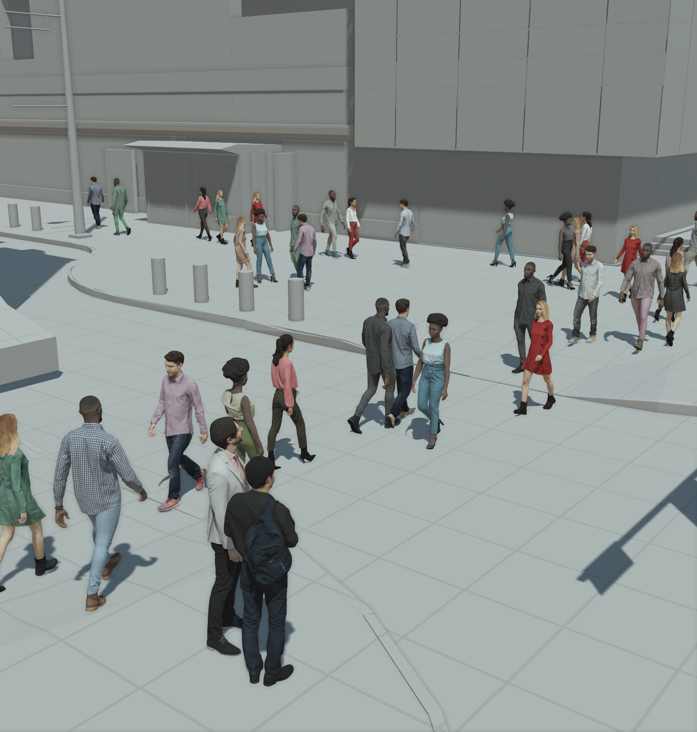

Reducing the value below 100% creates a slow motion effect. In this example the playback value is set to 10%.
Increasing the value above 100% will create a time-lapse effect.  In the above image we have set the playback value to 500%.
