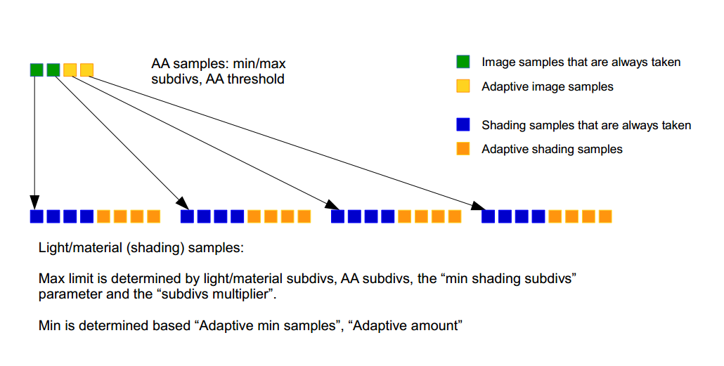

V-Ray is an adaptive sampling engine. This means that whenever V-Ray needs to compute a value, like the color of a pixel, or the light reflected from a surface, V-Ray will take a varying number of samples for that value, depending on the context. The adaptive algorithm that V-Ray uses is very straightforward: for any effect that requires several samples, V-Ray first computes a small amount of samples, and then, if the variance of the samples is too big, it continues to take more samples until the result is good enough.
The samples that V-Ray needs to compute can be broadly classified as image samples and shading samples. Image samples are those directly related to pixel values that compose the final image, including depth of field and motion blur effects. Shading samples are those taken to compute effects like glossy reflections, global illumination, area lights etc. V-Ray employs adaptive sampling in both of these cases. The picture below shows one possible way that a light or a material may be sampled within a given pixel.
For each value that must be sampled adaptively, there is a certain minimum number of samples that V-Ray always computes, a maximum number of samples, and a noise threshold that controls how many samples between the minimum and the maximum would be actually computed. The minimum number of samples are needed because, like every adaptive algorithm, V-Ray's DMC sampler needs to gather a bit of information about the particular value that is being sampled before it can make any assumptions about it.
For image sampling, the three values - minimum samples, maximum samples and noise threshold - are directly specified by the user. The VRaySampleRate render element can show how many samples were actually performed, as a percentage of the maximum. However, for shading effects like glossy reflections, area lights, GI, it would be too cumbersome to have to specify the three values for each effect separately. To simplify the setup, V-Ray allows the user to specify the maximum number of samples using the various subdivs parameters for lights, materials and so on (although importance sampling may modify this maximum number depending on the expected contribution of the value). The noise threshold is specified globally for all values with the DMC noise threshold. What remains then, is to figure out the number of minimum samples that must be taken for a given value:
  • The minimum number of samples may be specified directly with a fixed number. This is not a bad approach, however, it means that increasing the subdivs value for a shading effect might not always lead to improved quality, contrary to what users typically expect.
  • The minimum number of samples could be specified as a percentage of the maximum number of samples. This approach ensures that increasing the subdivs value always results in better quality, but if the maximum number of samples are too low to begin with, it may mean that there is not enough information in those samples for the adaptive algorithm to work reliably.
The V-Ray DMC sampler combines both strategies and takes the bigger value to determine the actual minimum number of samples. Those strategies are controlled by the DMC min. samples parameter and the DMC adaptive amount parameter respectively. Once the minimum number of samples are taken, the DMC sampler continues taking more samples either until the noise threshold is reached, or the maximum number of samples are taken.

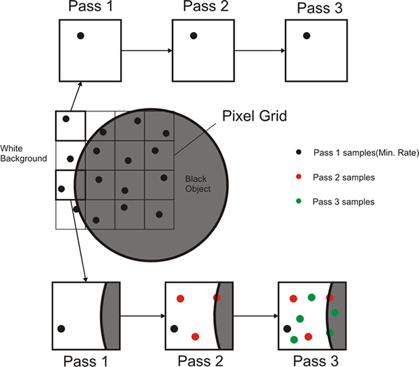

This sampler makes a variable number of samples per pixel based on the difference in intensity between the pixel and its neighbors. This is the preferred sampler for images with lots of small details (like fine hair, for example) and/or blurry effects (DOF, motion blur, glossy reflections etc). It also takes up less RAM than the Adaptive subdivision sampler.
The following diagram shows visually the way V-Ray is placing samples when using the Adaptive sampler. The black squares represent the pixels of the image while the dots represent the individual samples. In the first pass, V-Ray always places the minimum number of samples determined by the Min subdivs parameter. Then, the color of samples is compared and more are added where needed in the following passes.

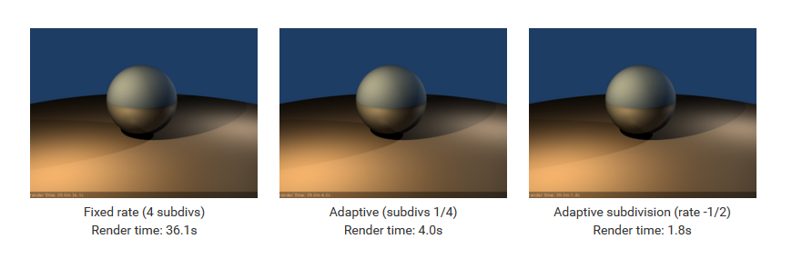

Here are some examples demonstrating the quality vs. speed of the image samplers. All the samplers were set to produce approximately the same image quality. The first example is a normal smooth image (no blurry effects), click the images for a larger view:
Both the adaptive and the adaptive subdivision samplers are substantially faster than the fixed rate sampler.

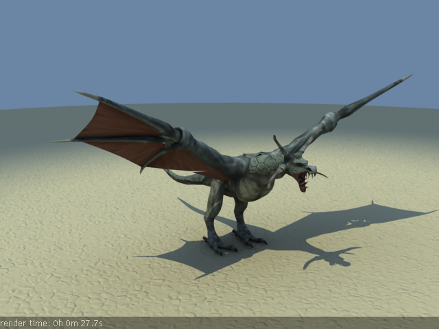

Here is a more complex example with some fine textures (lots of fine bump mapping) and an area light; this example uses a pre-calculated irradiance map - the render times are for the final rendering only.
The Sponza Atrium model was created by Marko Dabrovic (http://www.rna.hr) and was one of the models for the CGTechniques Radiosity competition. The Athene model was a free model from the DeEspona Infografica model bank.
In this case, the Adaptive sampler performed best, and the Adaptive subdivision method performed the worst. Why is that? Here is the non-antialiased image, to give an idea of what the image samplers had to deal with.
Some parts of the image are quite "noisy" because of the fine bump map. Lots of image samples were required to smooth this out. Furthermore, each image sample was quite costly to compute - there is an irradiance map and an area light, which (especially the area light) need a lot of computations. With the Fixed and Adaptive samplers, V-Ray knows in advance how many image samples will be taken for a pixel; therefore, it can optimize the computation of some values (the area light for example) so that the final image result is similar, while actually those values are computed with lower accuracy (i.e. tracing fewer shadow rays) for the individual image samples. This cannot be done for the Adaptive subdivision sampler - it does not know in advance how many samples will be computed for a pixel; therefore it needs to maintain a constant (high) accuracy. Constant accuracy is also required in order for the sampler to adapt correctly to the image. This is why, in this example, the Adaptive subdivision sampler performed worse than the other two methods.
