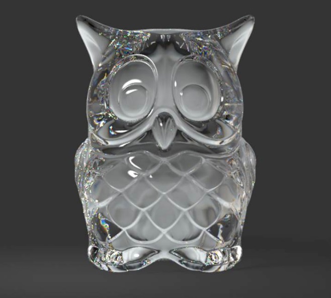

In this chapter, we'll talk about caustics. According to Wikipedia: "А caustic or caustic network is the envelope of light rays reflected or refracted by a curved surface or object, or the projection of that envelope of rays on another surface. The caustic is a curve or surface to which each of the light rays is tangent, defining a boundary of an envelope of rays as a curve of concentrated light. Therefore, in the image to the right, the caustics can be the patches of light or their bright edges. These shapes often have cusp singularities." Caustics are an extremely important phenomenon, which contributes to the photorealism a lot.
In comparison to the unbiased render engines, V-Ray doesn't handle caustics automatically. The V-Ray renderer still supports the rendering of caustics effects. In order to produce this effect, you must have proper caustics generators and caustics receivers in the scene (for information on how to make an object a caustics generator/receiver, see the Parameters section). The settings in this parameter section control the generation of the photon map.
In order to calculate the caustics effects, V-Ray uses a technique known as photon mapping. It is a two-pass technique. The first pass consists of shooting particles (photons) from the light sources in the scene, tracing them as they bounce around the scene, and recording the places where the photons hit the object surfaces. The second pass is the final rendering, which is when the caustics are calculated by using density estimation techniques on the photon hits stored during the first pass.

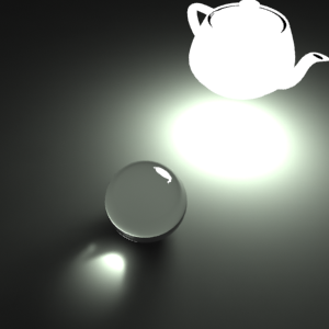

This example shows GI caustics generated by a self-illuminated object:
