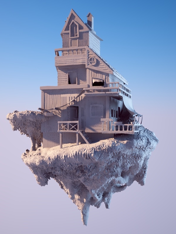

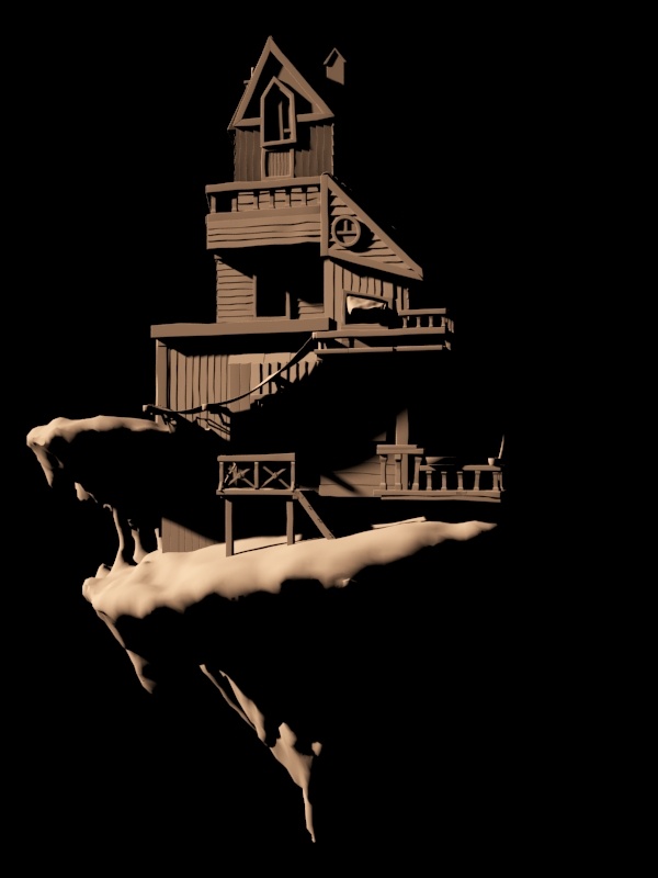

Exterior
Here we see the direct and indirect lighting broken out to help see what areas are contributing to the final result:
Before
After
Here's the final result:

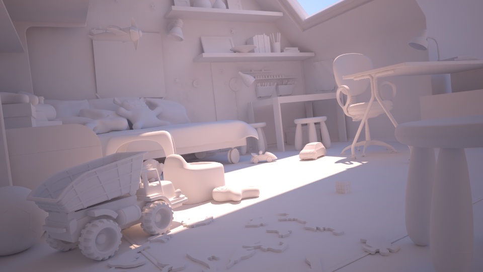

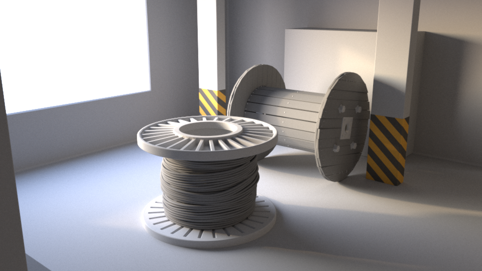

Interior
Here again we see the direct and indirect lighting separately:
Lighting
GI
Here we see render times of different combinations of GI engines:
BF + LC (accurate) at 75%  Render Time: 7min 55sec
IM + LC (fast) at 75%  Render Time: 2min 30sec
