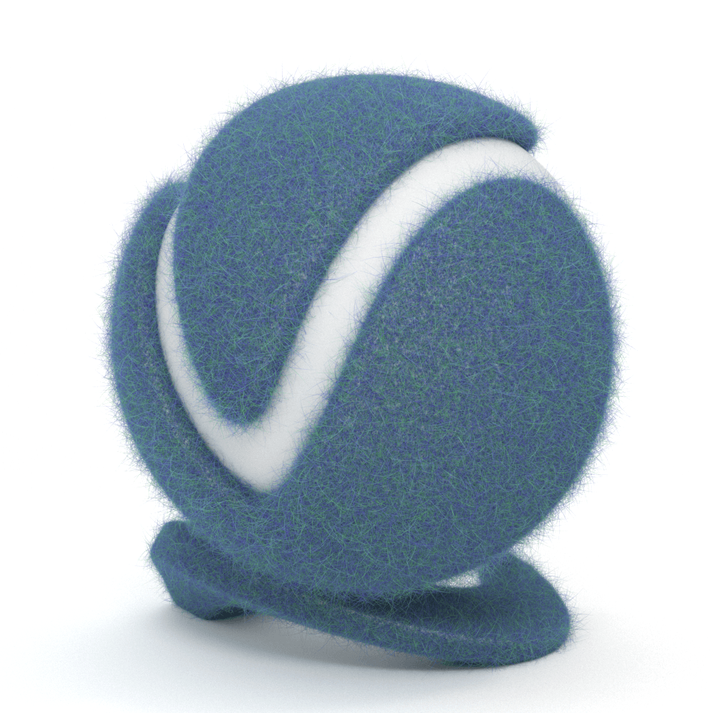

Example

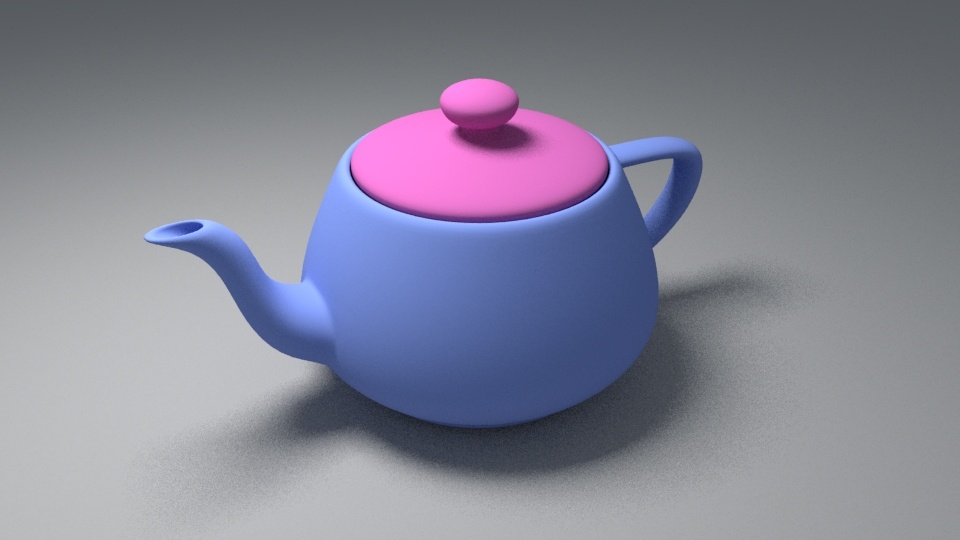

The following scene is rendered by using the scene bundle and uncommenting "vrscenes/map_12 TexMulti.vrscene".

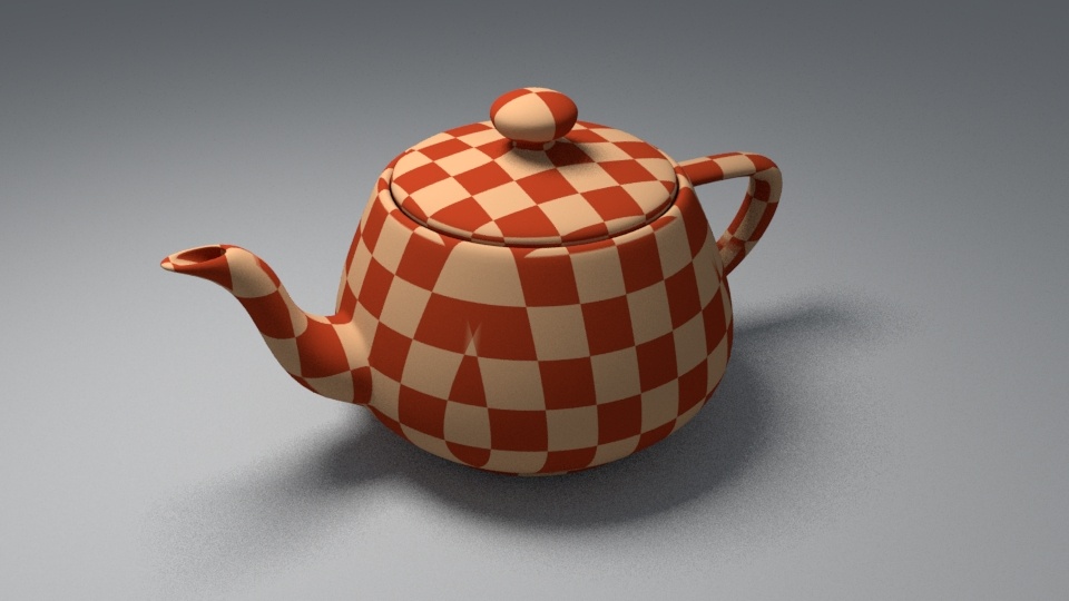

The following scene is rendered by using the scene bundle and uncommenting "vrscenes/map_06 TexTriplanar singleTexture.vrscene".

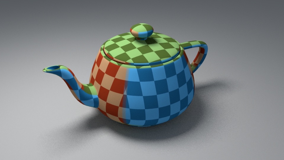

The following scene is rendered by uncommenting "vrscenes/map_07 TexTriplanar XYZ_Textures.vrscene".

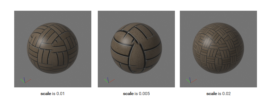

Scale

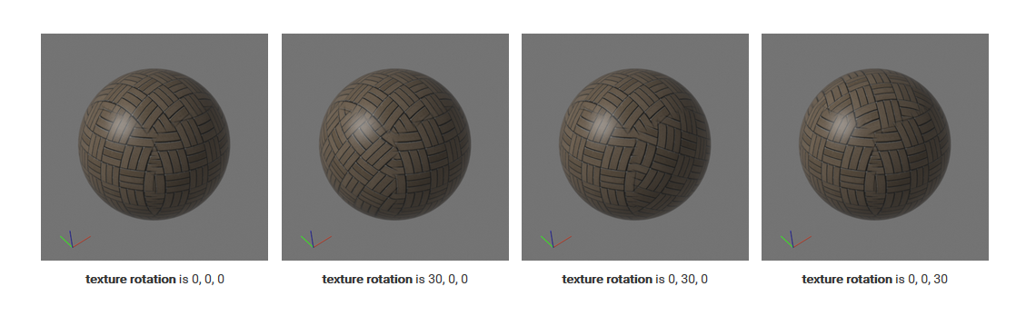

Texture Rotation
