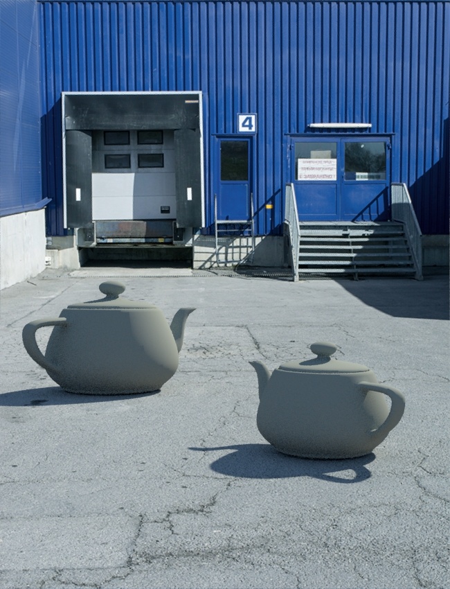

Example
The following picture is rendered using this scene. Take a look at the comments inside the included "wrapper.vrscene".
