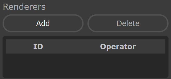

Renderers
Renderers can be added and removed with the "Add" and "Delete" buttons. The options shown to the right of the list apply to the currently selected renderer.

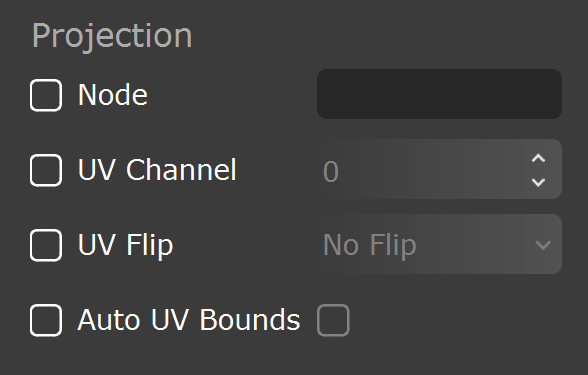

Projection
Settings for the stage geometry projection mesh. Ignored on operator instances.
Node Scene name of the projection node to be used. Required for each render instance.
UV Channel The projection mesh UV channel to be used. If not specified, the default UV channel is used according to the DCC that exported the scene (for example, 1 for 3ds Max, 0 for Maya and Blender).
UV Flip Optional UV flip of the projection mesh in one or both of the dimensions.
Auto UV Bounds If enabled, the UV bounds of the projection geometry are automatically computed. If disabled, the UVs are assumed to be in [0, 1]. The UV bounds determine the mapping of the output image in UV space. Enabled by default.
The Node field is case sensitve. Please ensure you use the correct capitalization.

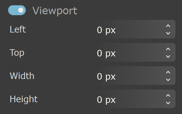

Viewport
Viewport bounds: Left, Top, Width, Height in screen pixels. Allows transformations of the output image rectangle in the output window, which allows rendering on just part of the screen but still outputting a full-screen image with proper synchronization. The area outside the viewport is rendered black. The render resolution is adjusted according to the viewport area. By default the viewport covers the full window. Useful when the physical display is mapped to just part of the output image.

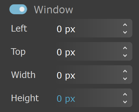

Window
Window bounds: Left, Top, Width, Height in screen pixels. Defines the bounds of the borderless window. Allows splitting a single screen into multiple instances in combination with the Region option. By default the window takes the entire screen (borderless windowed full-screen rendering). Note that rendering on part of the screen with this option can cause synchronization issues and doesn't support the NVIDIA Quadro Sync option. It's mostly useful for testing purposes.

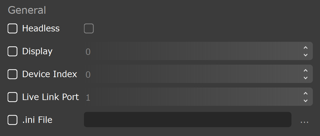

General
General options for the render instances.
Headless – If enabled, the rendering should be full-screen, otherwise it should be windowed. By default it's full-screen for the render instances and windowed for the operator instances.
Display – Index of the screen on which to start the renderer. 0 is the primary screen, the rest are 1, 2 and so on. By default Vantage starts on the last screen it was started on, taken from the Vantage configuration file.
Device Index – Specifies a single GPU to be used for rendering. Useful for running multiple render instances on the same machine in a multi-GPU setup. The indices are in the same order as in the "Select Render Devices" dialog in Vantage, starting from 0. They're also listed in the beginning of the Vantage log.
Live Link Port – Live link port override. Useful for running multiple render instances on the same machine, for example in a multi-GPU setup, or to resolve any other port conflict. Note that the renderer also uses the subsequent port number, for example specifying 20705 will also use 20706. Also note that port number 20702 is internally reserved and cannot be used.
.ini File – Path to an Arena Renderer configuration file (.ini file) to use. If not set, the default values for all options are used.

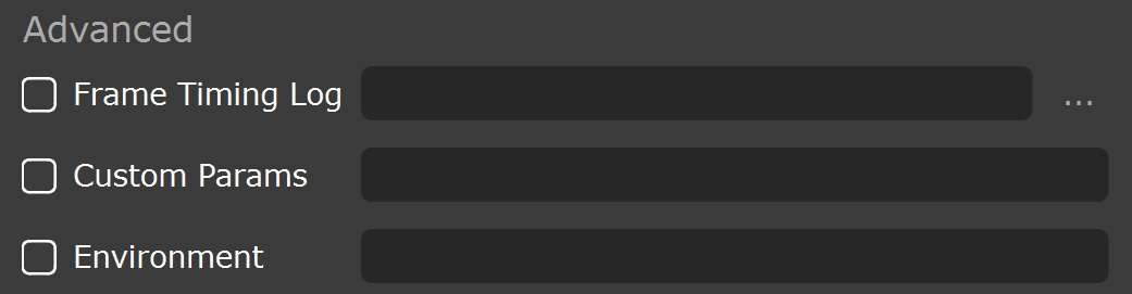

Advanced
Advanced options.
Frame Timing Log – Path to a .csv file to be written, containing debug frame timing data for the CPU part of the rendering. Not set by default. Useful for debugging.
Custom Params – Custom parameters, directly passed as command-line argument to the renderer as a string. Not set by default. Useful for debugging.
Environment – Additional environment variables to be set on the renderers (K1=V1;K2=V2;...). By default the renderers inherit the environment of the spawners. Useful for debugging.
