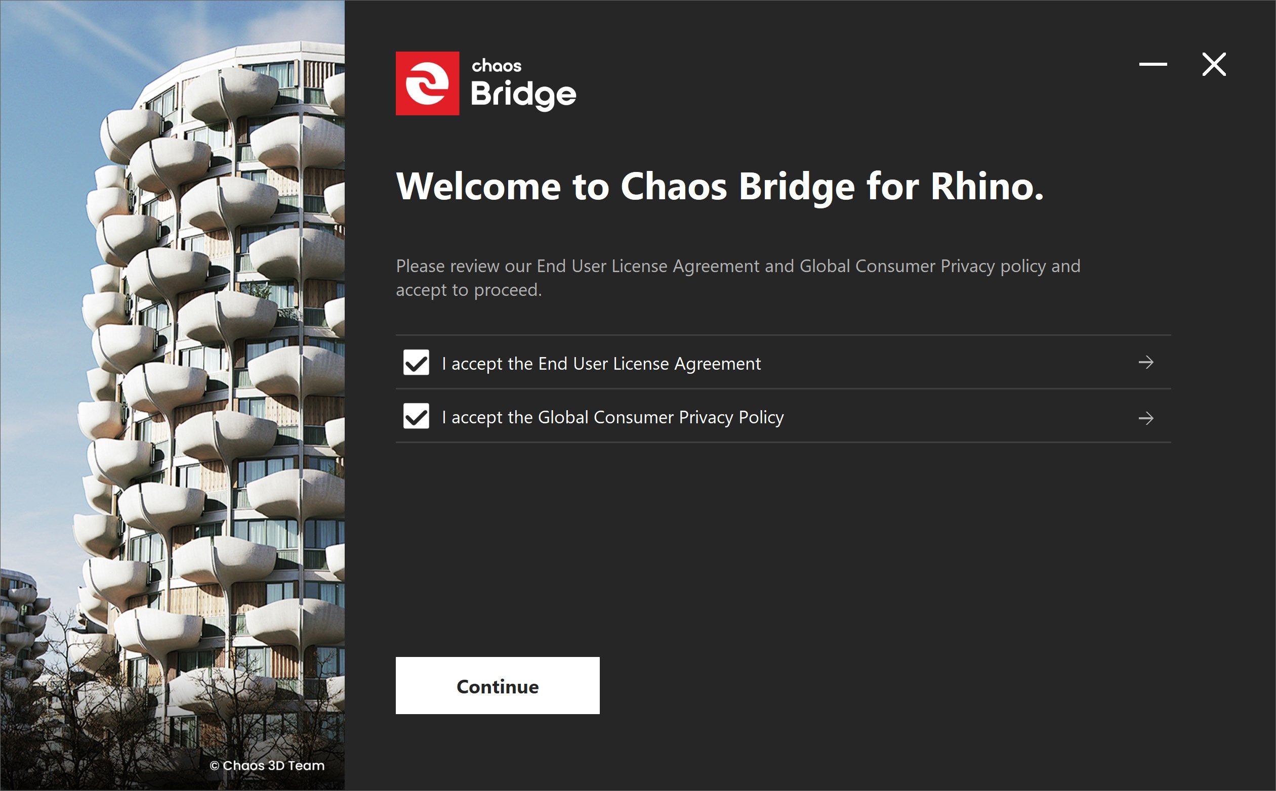

Welcome
Carefully read the End User License Agreement and the Global Consumer Privacy Policy. Click the I accept buttons if you agree to the terms.
Proceed to click the Continue button.
