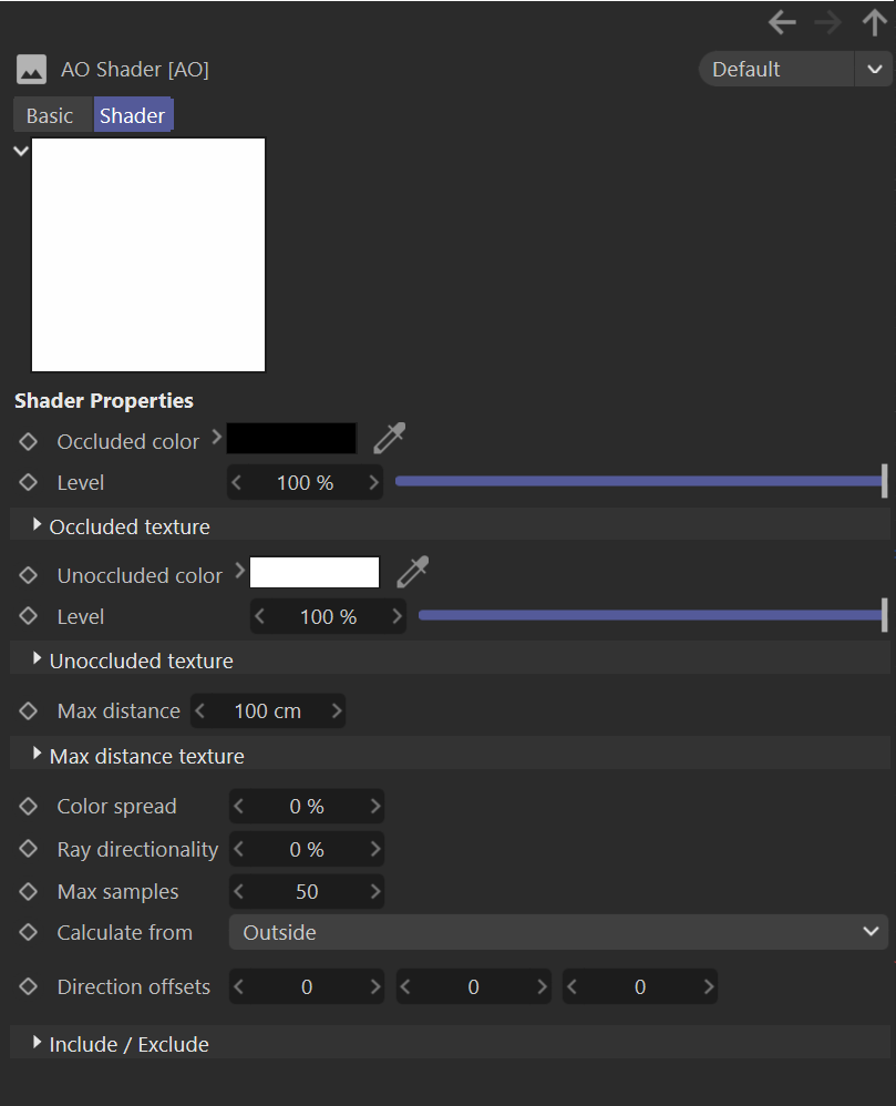

Shader properties

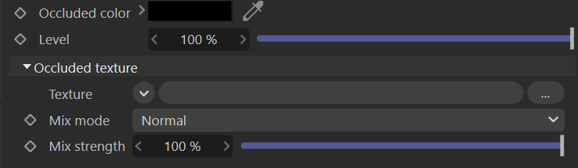

Occluded color – This is the color that is used for occluded areas of the geometry.
Level – This is the intensity (also considered as the visibility) of the occlusion.
Occluded texture – Using this option, the occlusion can be controlled by a texture map or shader.
Texture – Defines the texture map or shader that will be used for AO.
Mix mode – Controls the blending mode of the texture map or shader.
Mix strength – Controls the intensity of the texture map or shader that is being used.

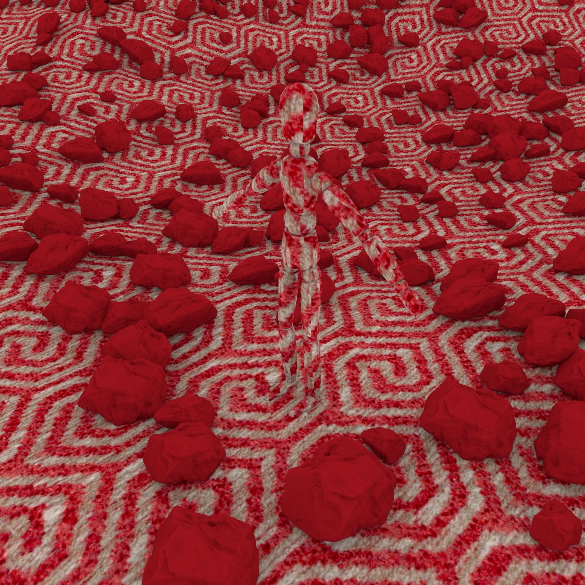

Corona AO Occluded color
Occluded color = Black
Occluded color = Red
Occluded color = Green
Corona AO Occluded color - Level
Level - 0%
Level - 50%
Level - 100%
Corona AO Occluded Texture
No texture/shader
Texture map
Texture map

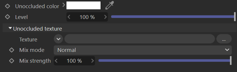

Unoccluded color – This is the color that is used for unoccluded areas of the geometry.
Level – This is the intensity (also considered as the visibility) of the color used for unoccluded areas.
Unoccluded texture – Using this option, a texture map or shader can be used to control unoccluded areas.
Mix strength– Controls the intensity of the texture map or shader that is being used.

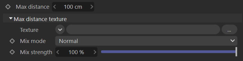

Max distance – This is the distance used for the transition between occluded and unoccluded areas.
Max distance texture – Using this option, a texture map or shader can be used to control the transition between occluded and unoccluded areas.

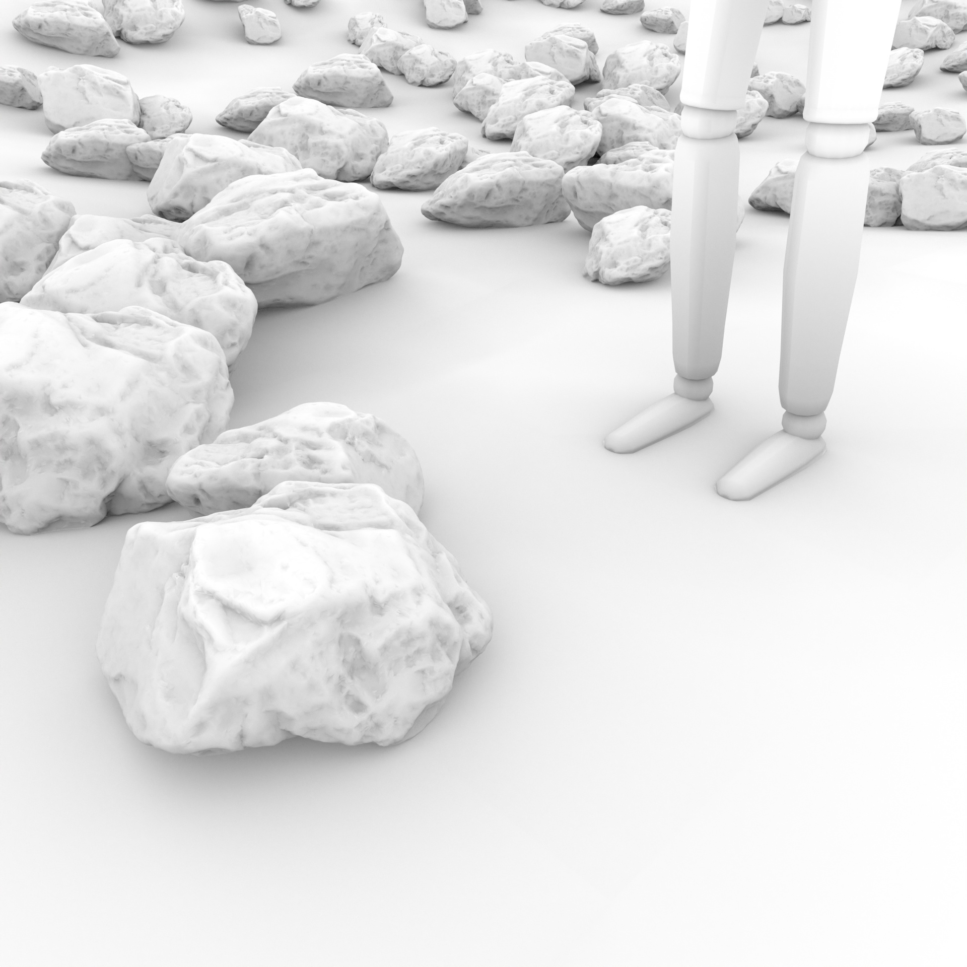

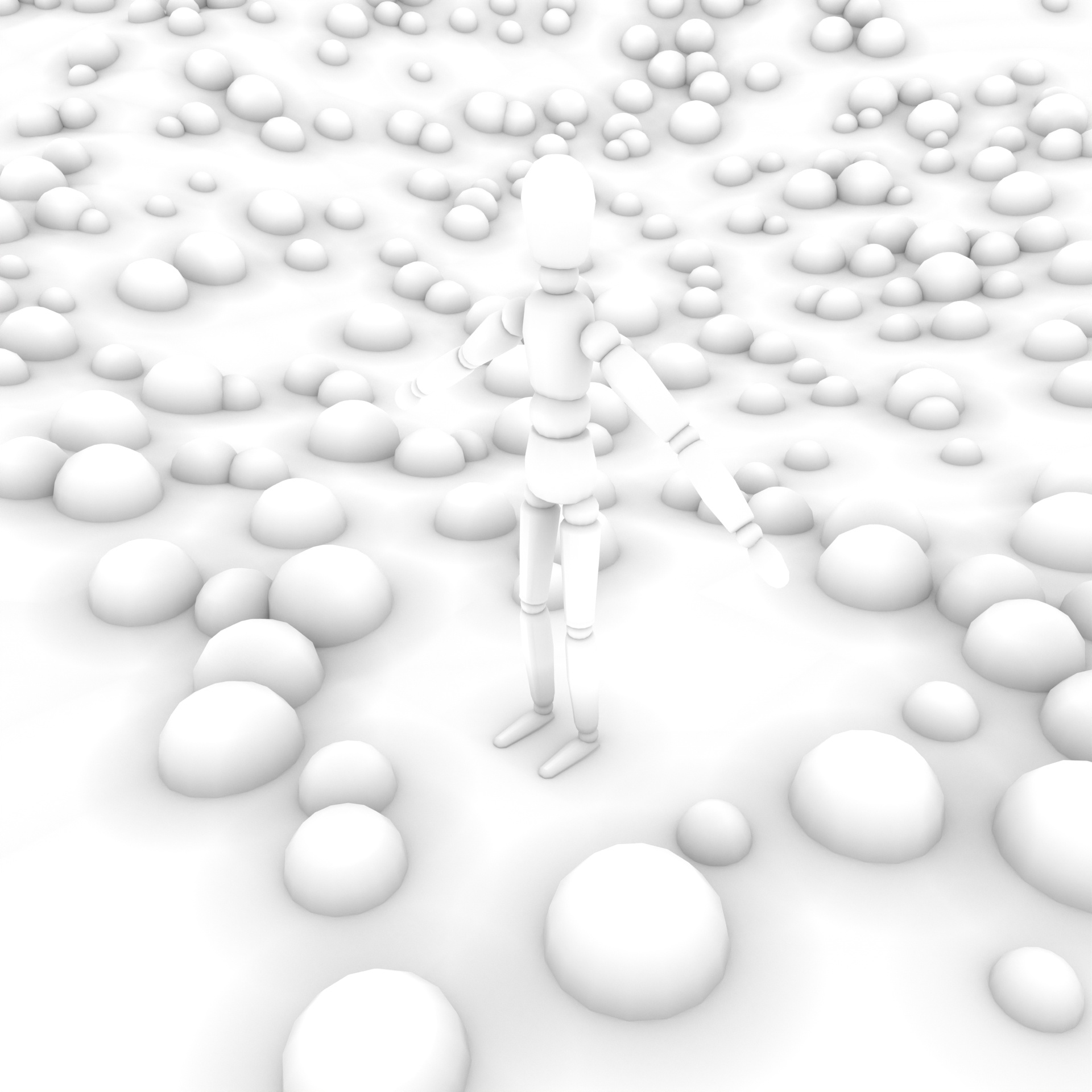

Color spread – Makes the effect of occlusion stronger and more apparent when using higher values.
Ray directionality – Controls the distribution of the rays around the object's normals. Lower values result in uniform ray distribution around the geometry normals. Increasing this value causes the rays to focus on the occluded areas only.
Max samples – Controls the number of samples used to calculate AO. Increasing the number of Samples provides a cleaner render (less noise) in a shorter time at the cost of other effects such as GI and anti-aliasing. Lower values render faster but look noisier.
Usually, there is no need to change the default value.
Calculate from – Provides different calculation methods for the AO.

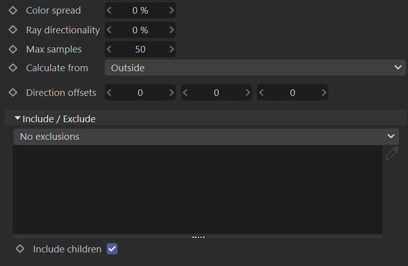

Direction offsets – These values control the axis where the rays are going to be distributed. From left to right, X, Y, and Z axis can be used separately or combined.
Include/Exclude – A list of scene objects that can be used to include or exclude specific objects from being considered for AO calculations.
Available modes for the include/exclude list:
No exclusions – This mode is selected by default and disables the use of the include/exclude list.
Use include list – This mode considers only the objects in the list for AO calculation.
Use exclude list – This mode excludes only the objects in the list from AO calculation.
Only other objects occlude – This mode considers only the...
Only the same object occludes – This mode only considers the...
Include children – When enabled, it includes nested objects (children objects) from those specified in the above list.

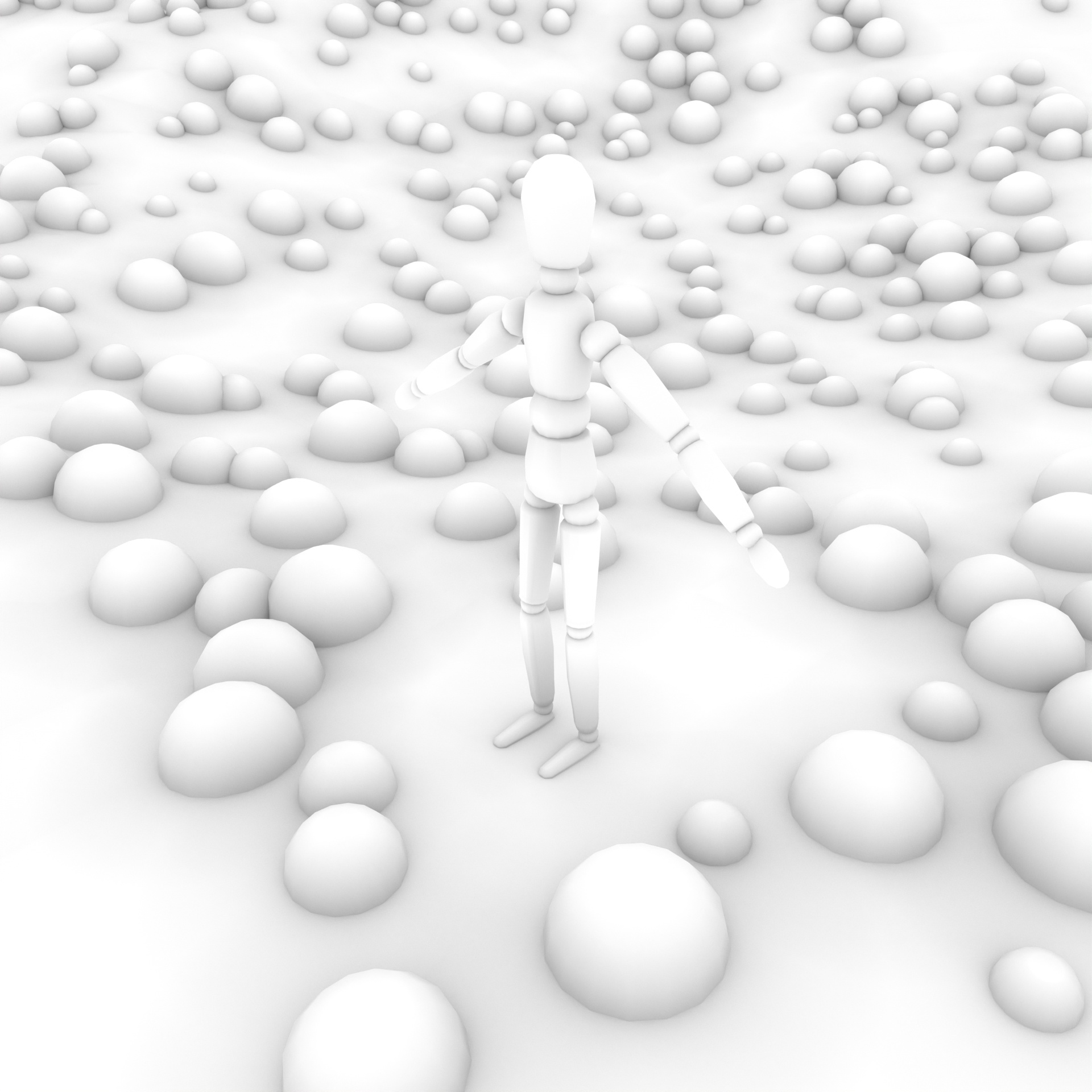

Corona AO Color Spread
Color spread = 0%
Color spread = 50%
Color spread = 100%
Corona AO Ray directionality
Ray directionality = 0%
Ray directionality = 35%
Ray directionality = 70%
Corona AO Max samples
Max samples = 5
Max samples = 20
Max samples = 50
