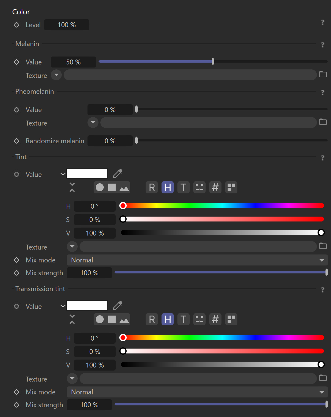

Color
Color
Level – This is the intensity (also considered as the visibility) of the color.
Melanin
Value – Controls the absorption inside hair fibers by setting the total amount of melanin pigment in the hair. This sets the overall color of hair. A value of 0% (no pigment) leads to white hair, while a value of 100% leads to completely black hair. The values between them give physically plausible human hair color.
Texture – Defines the texture map or shader that will be used to control the melanin value instead.
Pheomelanin
Value – Controls the relative amount of reddish pheomelanin pigment among the hair pigments and hence the hair redness. A value of 0% leads to 100% of eumelanin (brown pigment), and a value of 100% leads to 100% of pheomelanin (reddish pigment causing ginger coloration).
Texture – Defines the texture map or shader that will be used to control the pheomelanin value instead.
Randomize melanin – Controls the randomization of pigment amount between different hair strands. 0% means no randomization, while 100% means completely random amount of hair pigment for each hair strand.
Tint
Value – Controls the absorption inside hair fibers. Setting this value to black leads to total absorption within the hair and hence black hair with only reflection. This value is not used on its own, it only tints the color calculated from (pheo)melanin. For natural human hair color, it is recommended to leave the tint at white, where it does not modify the color calculated from (pheo)melanin. It can, however, be used to simulate hair dyes, textile fibers, etc.
Texture – Defines the texture map or shader that will be used to control the tint color instead.
Mix mode – Controls the blending mode of the texture map or shader over the color.
Mix strength – Controls the intensity of the texture map or shader that is being used.
Transmission tint
Value – Colors the light transmission through the hair fibers. For physically plausible results, it is recommended to keep this value as pure white.
Texture – Defines the texture map or shader that will be used to control the transmission tint color instead.

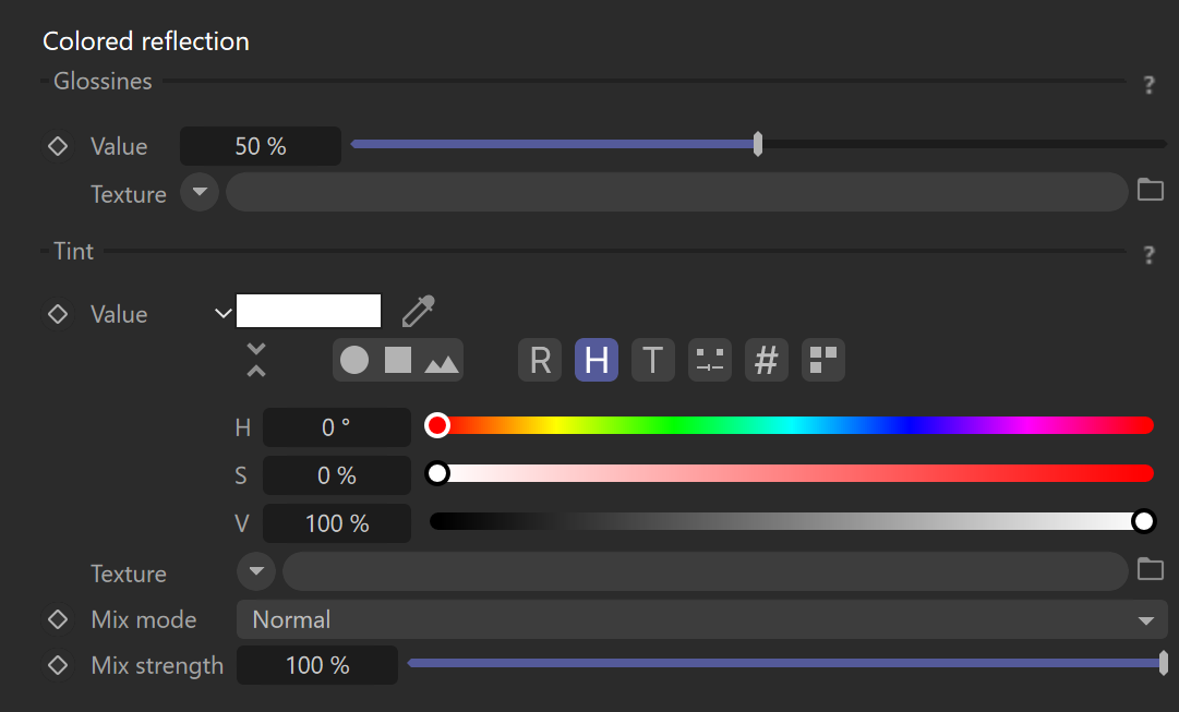

Colored reflection
Glossiness
Value – Controls the glossiness of hair in the direction of the hair length. A value of 0% leads to very rough/diffuse hair, while a value of 100% leads to the shiniest hair.
Texture – Defines the texture map or shader that will be used to control the glossiness value instead.
Tint
Value – Color tint of the secondary (colored) reflection on the hair fibers. For physically plausible results, it is recommended to keep this value as pure white.

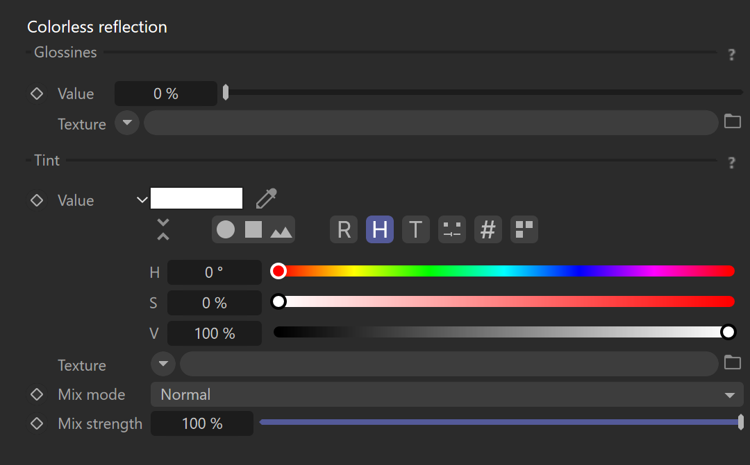

Colorless Reflection
Glossiness
Value – Multiplier of glossiness parameter for the primary (colorless) reflection lobe. Increasing the value leads to a sharper primary (colorless) reflection lobe compared to other lobes (colored reflection, transmission).
Tint
Value – Color tint of the primary (colorless) reflection on the hair fibers. For physically plausible results, it is recommended to keep this value as pure white.

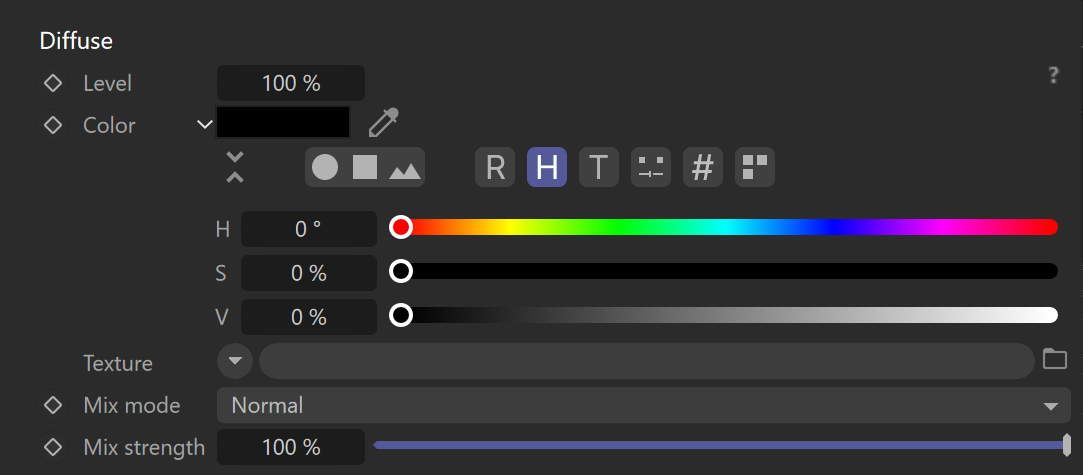

Diffuse
Level – Diffuse component multiplier.
Color – Adds a diffuse component to the hair. Clean hair does not have this component in reality, so it should be used only in very special cases (dirt in hair, non-hair objects, etc.).
Texture – Defines the texture map or shader that will be used to control the diffuse color instead.

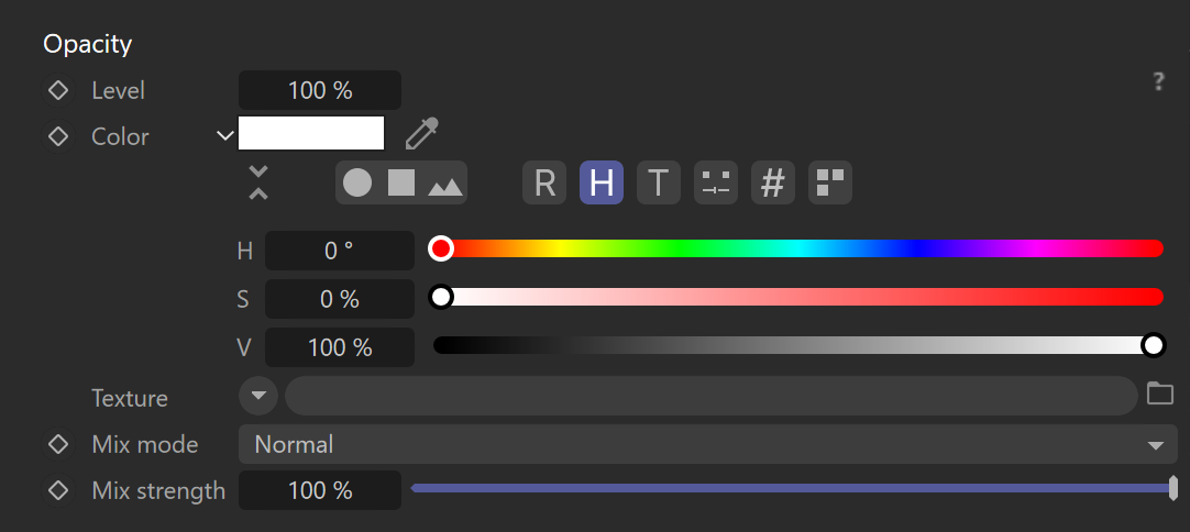

Opacity
Level – Specifies the opacity level. Both the opacity constant color and texture map are multiplied by this number. Setting 50% and using white color is equal to using 50% gray color or using a texture map with output level of 50%.
Color – Specifies the opacity of the material. It can be set as a constant color or mapped by a texture map.
Texture – Defines the texture map or shader that will be used instead of the above color.

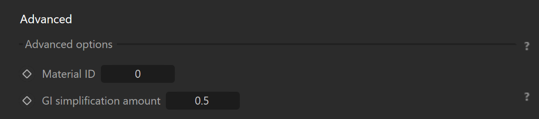

Advanced
Material ID – Defines an ID for the material that can be used in the Corona Compositing tag or in the Corona Data shader.
GI simplification amount – When set to non-zero values, less precise global illumination is computed for this hair material. This leads to significantly less noise but also more unrealistic results.
