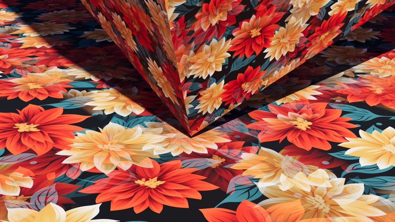

Textured objects often show obvious repetitions, which instantly gives away that the scene is computer-generated. You can use the Corona Mapping Randomizer shader to quickly randomize textures on multiple objects or object parts, making the image appear more realistic.
The Corona Mapping Randomizer shader allows you to apply random offset, rotation, and scaling to texture maps and shaders assigned to one or multiple objects. It works similar to the Corona Multi Shader. For example, you can randomize a wood texture applied to a set of planks so that each plank has a different look in the final render. You can also apply a blending effect to the randomized texture tiles, which makes them appear even more natural.
To enable the randomization, plug any texture (be it a texture map or a shader) into the Corona Mapping Randomizer shader input slot and then plug its output into any material property. You can then adjust the texture transformations and other options to the desired values. You can use the Corona Mapping Randomizer shader with any material property, including the bump channel, RGB normal maps, and displacement.

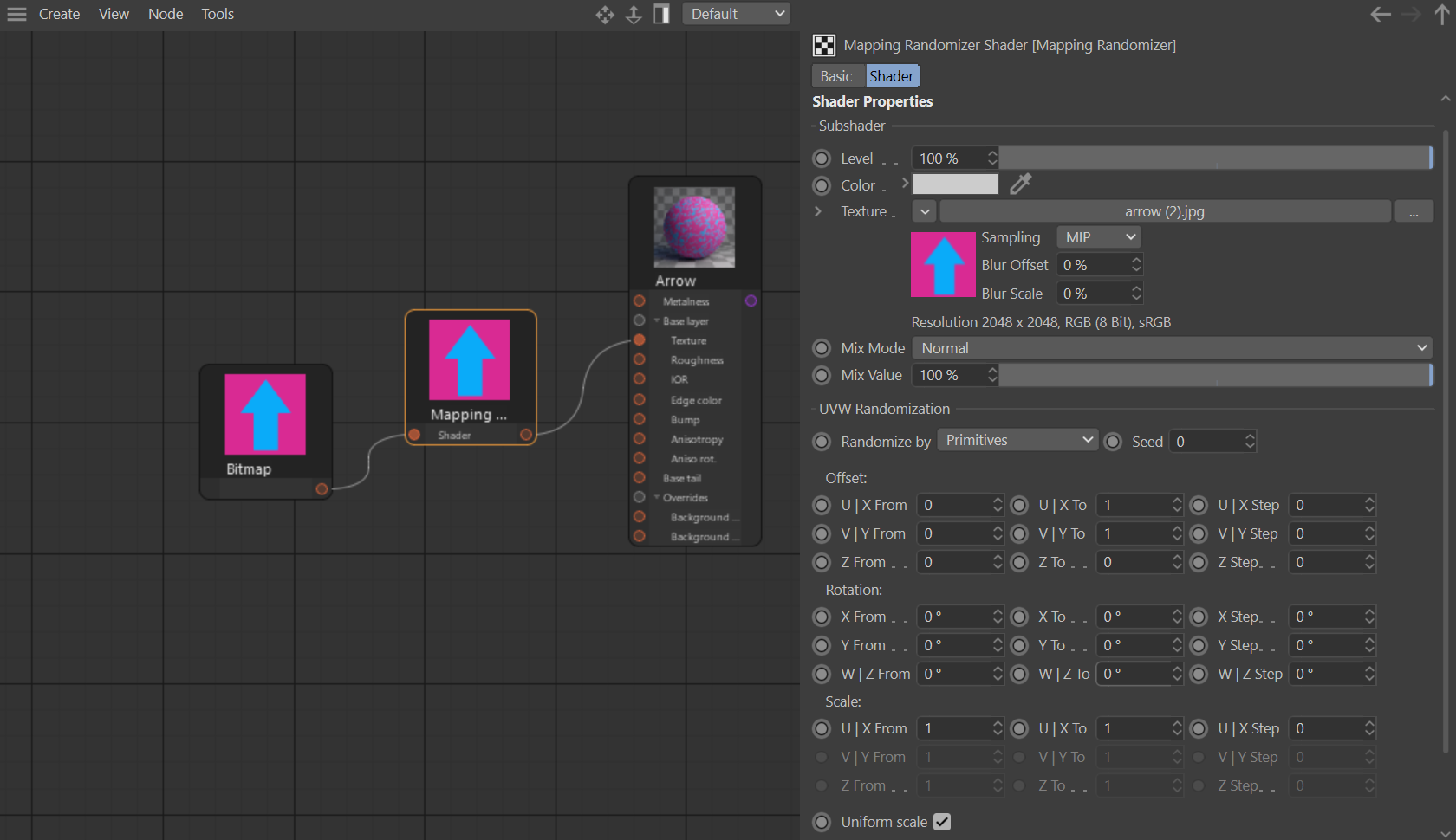

Shader Properties
Level – Defines the intensity of the entire shader parameters.
Color – Sets a solid color to use as the source.
Texture – Sets either a texture map or a procedural shader to use as the source.
Mix mode – Defines how the texture map or shader combines with the Color parameter.
Mix value – Defines the percentage of the texture that is mixed with the Color parameter. It works like opacity for the shader's texture.
UVW Randomization
Randomize by – Selects between different randomization modes.
Primitives – Randomizes the texture map or shader by different primitives which are triangles, hair strands, etc.
Sub-primitive – Randomizes by different sub-primitives, which are displacement micro triangles or hair segments.
Material name – Randomizes the texture map or shader by different assigned materials. The materials must have different names.
Objects – Randomizes the texture map or shader per each object. You can even use this mode with Cloner objects.
Material tag index – Randomizes the texture map or shader based on the object's material tag position. Polygon selection tags can be used in combination with this mode for each material tag assigned.
Material ID – Randomizes the texture map or shader based on the Material's ID. The Material ID can be located and set in the Advanced properties for each material.
Object buffer ID – Randomizes the texture map or shader based on the object's buffer ID. The buffer ID can be located and set in the Corona Compositing tag of each object.
Mesh Element – This mode randomizes the texture map or shader by different connected mesh elements, which are groups of polygons connected by edges.
Polygon – Randomizes the texture map or shader by different polygons, which are groups of triangles (e.g. quads).
Decal – Randomizes the texture map or shader by different distinct decal objects. This randomizes only the decal layer, not the object it is projected onto. Note that this tracks decals by their names, so the result changes if a decal is renamed.
Tile ID – Randomized by different tiles if Corona Tile Map is used.
Multiple properties – Allows using different randomization modes at the same time.
The Sub-primitive, Polygon, and Multiple properties randomization modes are available starting with Chaos Corona 8. The Decal randomization mode is available starting with Chaos Corona 9.
Seed – This value makes random permutations of the UVW randomization results.
Offset
U From – Sets the initial position of the shader texture in the U coordinate.
U To – Sets the end position of the shader texture in the U coordinate. The shader can randomly use any value between the U From and U To parameters.
U Step – Determines the offset increment for each texture variation in the U coordinate. It works like the Quantize Move Step tool in Cinema 4D.
V From – Sets the initial position of the shader texture in the V coordinate.
V To – Sets the end position of the shader texture in the V coordinate. The shader can randomly use any value between the V From and V To parameters.
V Step – Determines the offset increment for each texture variation in the V coordinate. It works like the Quantize Move Step tool in Cinema 4D.
Rotation
W From – Sets the initial rotation of the shader texture in the W coordinate.
W To – Sets the end rotation of the shader texture in the W coordinate. The shader can randomly use any value between the W From and W To parameters.
W Step – Determines the offset increment for each texture variation in the W coordinate. It works like the Quantize Rotate Step tool in Cinema 4D.
Scale
U From – Sets the initial scale of the shader texture in the U coordinate.
U To – Sets the end scale of the shader texture in the U coordinate. The shader can randomly use any value between the U From and U To parameters.
U Step –Determines the offset increment for each texture variation in the U coordinate. It works like the Quantize Scale Step tool in Cinema 4D.
V From – Sets the initial scale of the shader texture in the U coordinate.
V To – Sets the end scale of the shader texture in the V coordinate. The shader can randomly use any value between the V From and V To parameters.
V Step – Determines the offset increment for each texture variation in the V coordinate. It works like the Quantize Scale Step tool in Cinema 4D.
V scale same as U – When enabled, the V and U axis use the same values for scale, rotation and offset. If this checkbox is not active, it allows you to set different scale values for each axes.
Tiling
Randomize each tile – When enabled, tiles the texture on each surface it is applied to, and is randomized using the Offset, Rotation, and Scale values.
High quality blending – This option is enabled by default and results in a better quality of the random tile blending, at some performance cost. The specific performance impact depends on the material's complexity. In case of visible rendering slowdown, it is advised to disable this option.
Number of tiles – This parameter sets the number of tiles to be randomized when the Randomize each tile checkbox is enabled.
Blending – This parameter controls how the individual tiles of the randomized texture are blended with each other. Higher values blend the tiles further together and make the texture appear slightly more blurry and uniform. Lower blending values reduce the areas where the tiles are blended together and make the texture sharper.

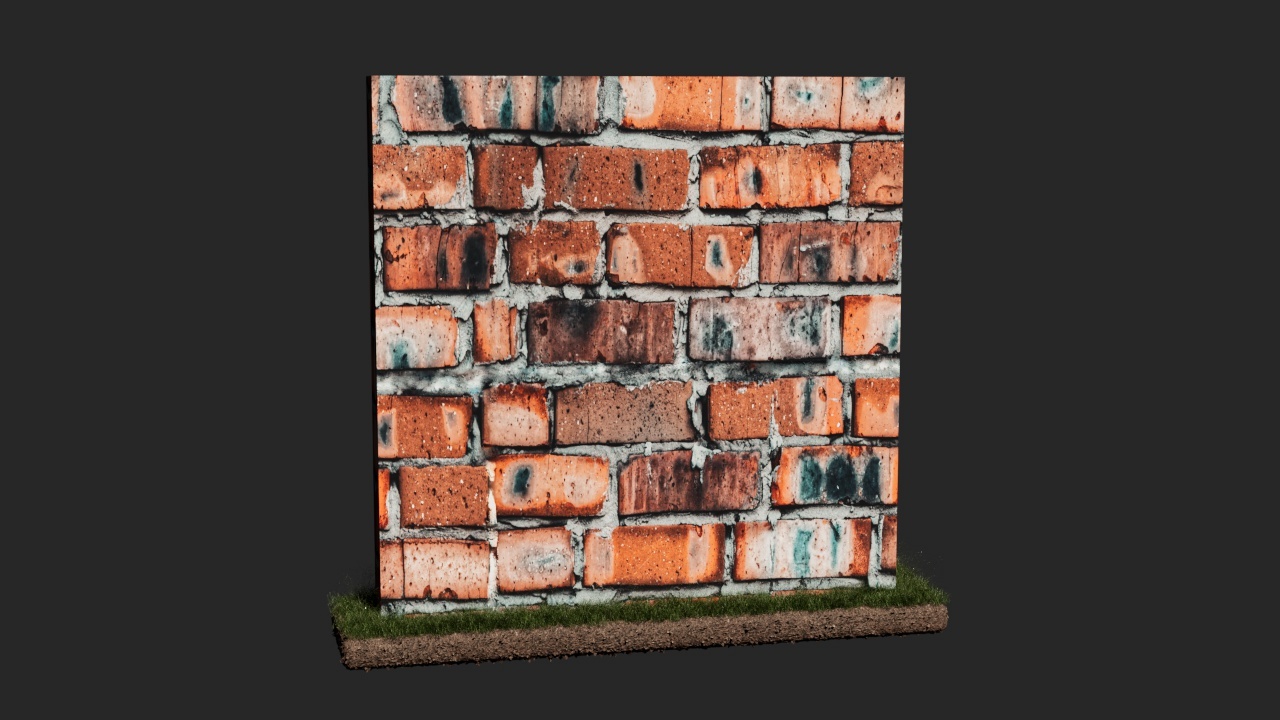

Example: Randomizing a Brick Wall
We can start with a few objects with a brick wall texture without any randomization whatsoever.
In this case, we want to randomize the U and V positions per object, but we also want to have them tiled on every single object in a random way. This can be done with the Mapping Randomizer.
Note that in addition to U and V offset variation, we also enabled the Randomize each tile option and set Number of tiles to 4. This tiles the texture on each surface it is applied to, and the tiling is then randomized using the Offset, Rotation, and Scale values.
The remaining issue here is that while the randomization works well, the bricks are not aligned in straight horizontal rows anymore because of the full V offset randomization.
We can fix that by enabling the Step option. The Step value decides the interval, at which the texture is moved. Leaving it at 0 results in unrestricted, random movement. Setting it to 1 means that we only allow the offset to be 1, 2, 3, and so on, resulting in no visible randomization whatsoever. Setting the value to 0.5 allows offsetting the texture by half its height. In this case, a single segment of our brick wall texture consists of 7 rows of bricks. To calculate the desired Step value, we need to divide 1 by the number of rows or columns. In case of our brick wall 1 / 7 = 0.143, so let's use this value.
As you can see in the image, the bricks are still randomized, but at the same time they are now arranged in horizontal rows, thanks to the 0.143 Step value.
The last thing left to do is to add displacement to the brick material. That is also possible with the Mapping Randomizer shader. Clone the Mapping Randomizer shader, so that the diffuse texture and displacement texture randomization is the same, plug the grayscale displacement map into it, and plug the result into the material's displacement slot.
