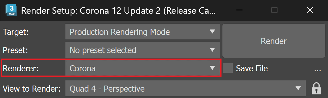

Start 3ds Max.
Go to Render Setup > Renderer and set Corona as your active renderer.

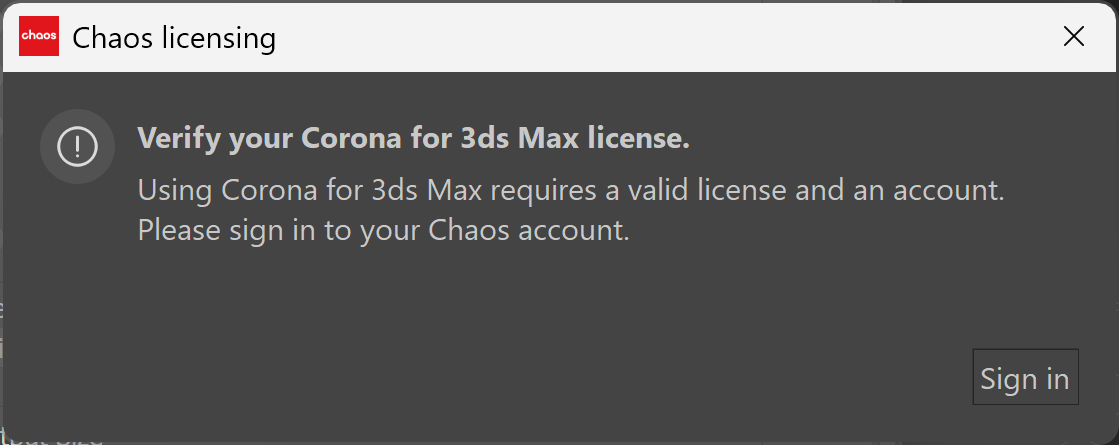

If you are not logged into your Chaos account, a notification pops up prompting you to sign in.

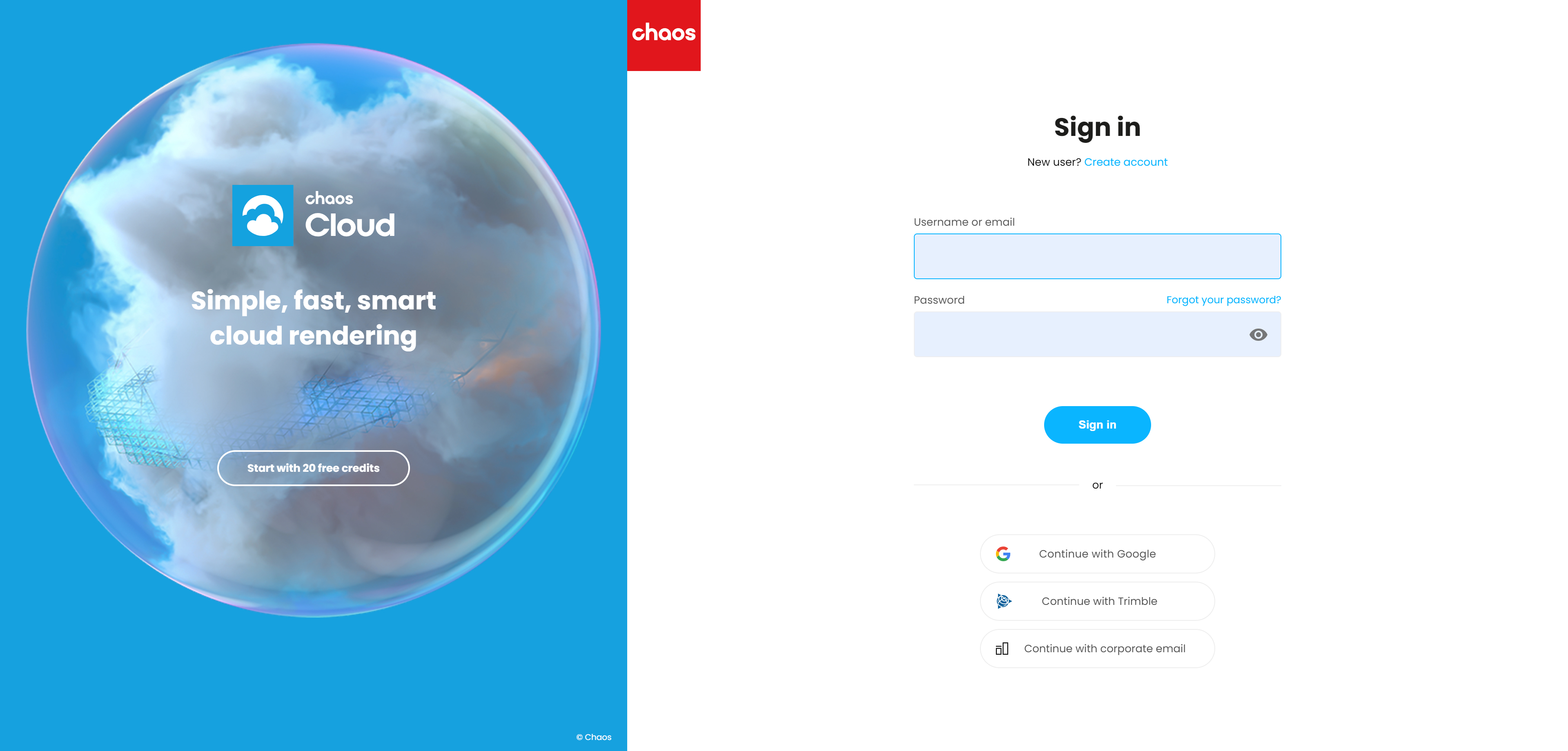

Click Sign in.
Sign in with your Chaos email and password.

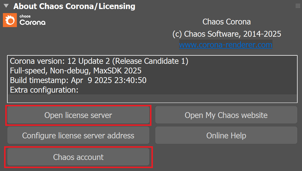

To access the License Server or your Chaos account, go to Render Setup > System > About Chaos Corona/Licensing and select Open license server for access to the Chaos License Server, or Chaos account for access to your account.

Start 3ds Max.

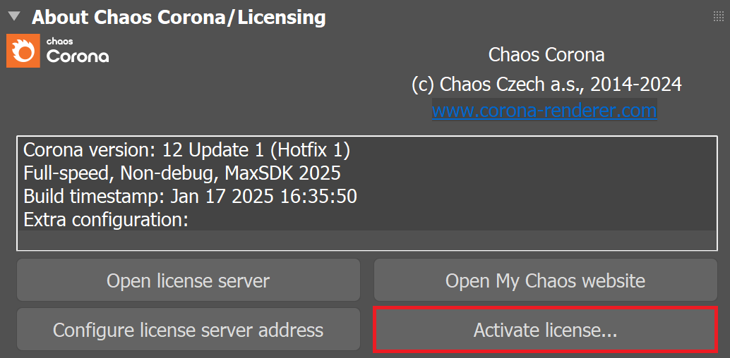

In the Render Setup window, go to System > About Chaos Corona/Licensing.

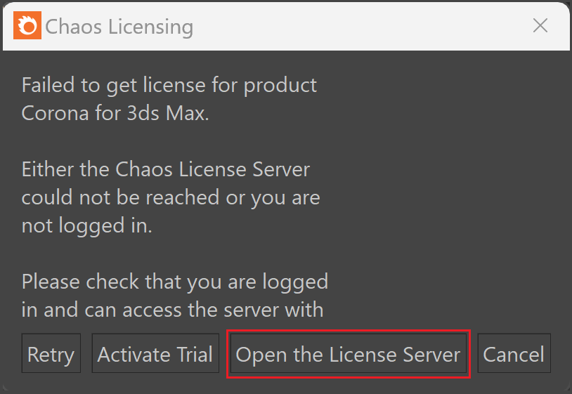

Click Activate license.... A window with multiple options opens.
Click Open the License Server.

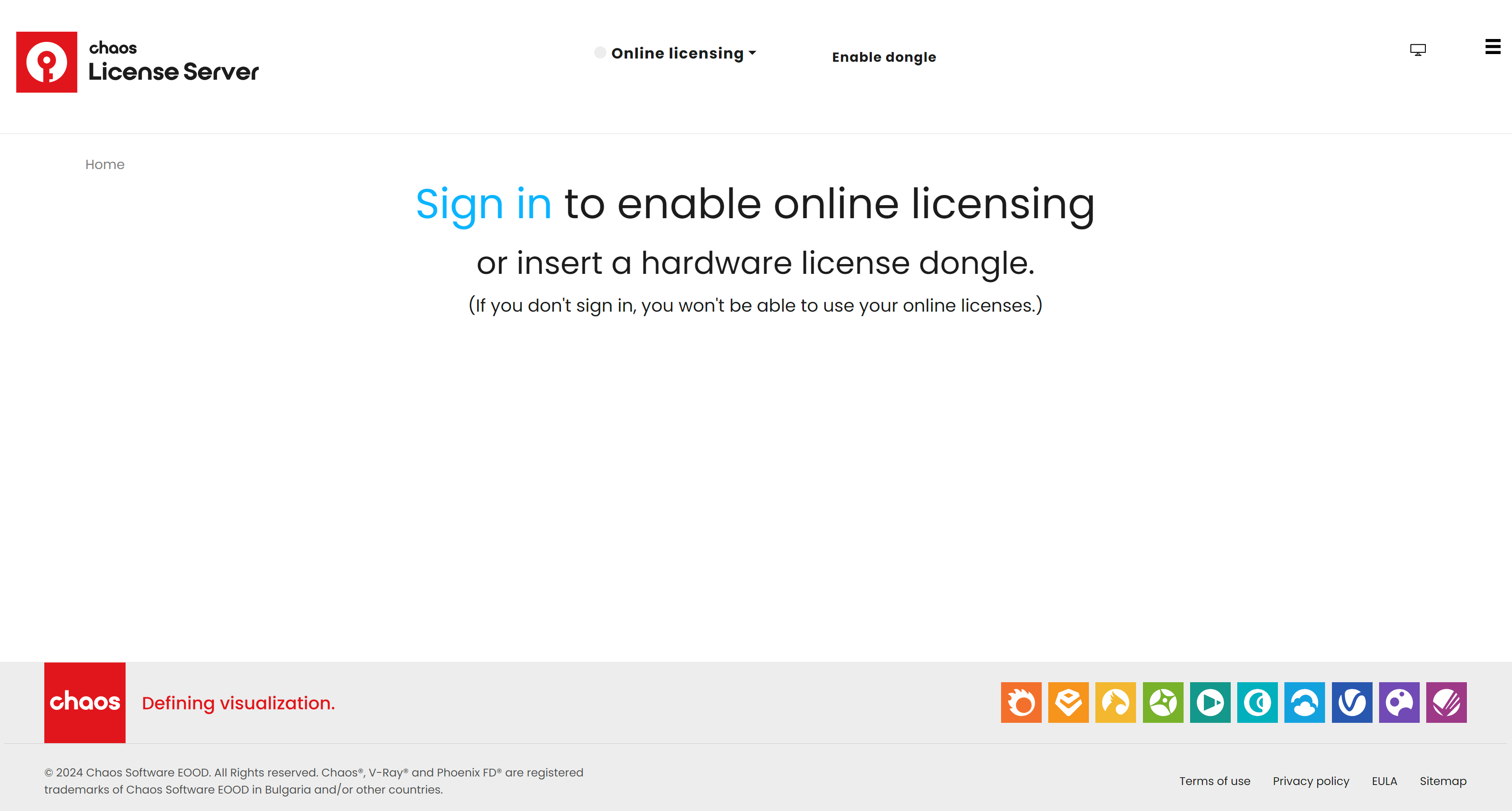

The Chaos Licensing page opens in your internet browser. Click Sign in.
Sign in with your Chaos email address and password.
If you have an active Corona subscription, you are done - your license is now activated! You can just return to 3ds Max and start rendering right away.
