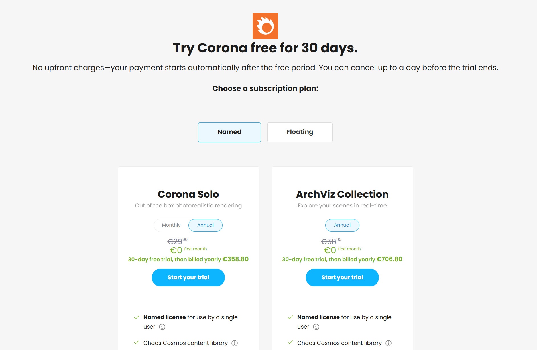

Chaos offers a free trial of Corona for 3ds Max before purchasing. The trial period has no restrictions within the software such as watermarks. This means that what you see in the trial is exactly what you will get if you have a paid subscription.
The Corona Free Trial activation consists of the following steps:
  • Register a new account or sign into an existing one at www.chaos.com.

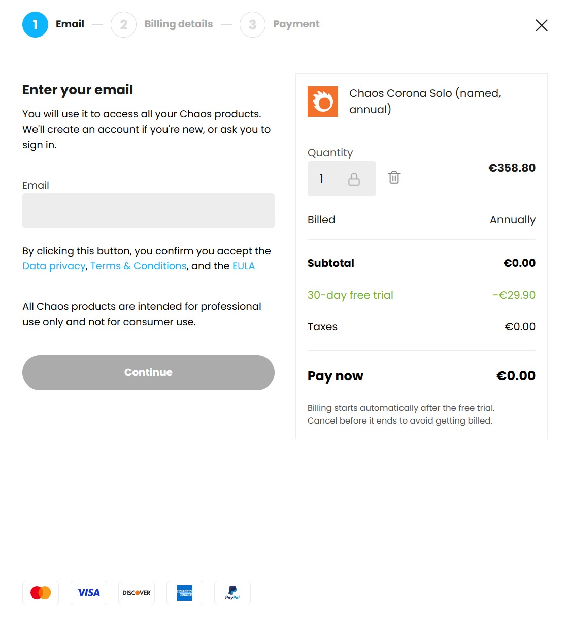

Create an Account
Register an account in order to use and activate the trial, or use an existing Chaos account. For new users, please use this link to register an account: https://accounts.chaos.com/register
Once registered, you will receive an email from Chaos to confirm your account. If you do not receive the email, please check your spam folder in case it has been filtered there. If you still cannot find the email from Chaos, please contact the Chaos support team for further assistance using this link: Contact Support

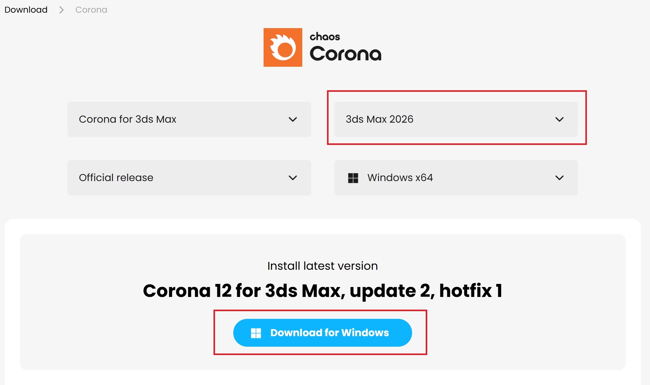

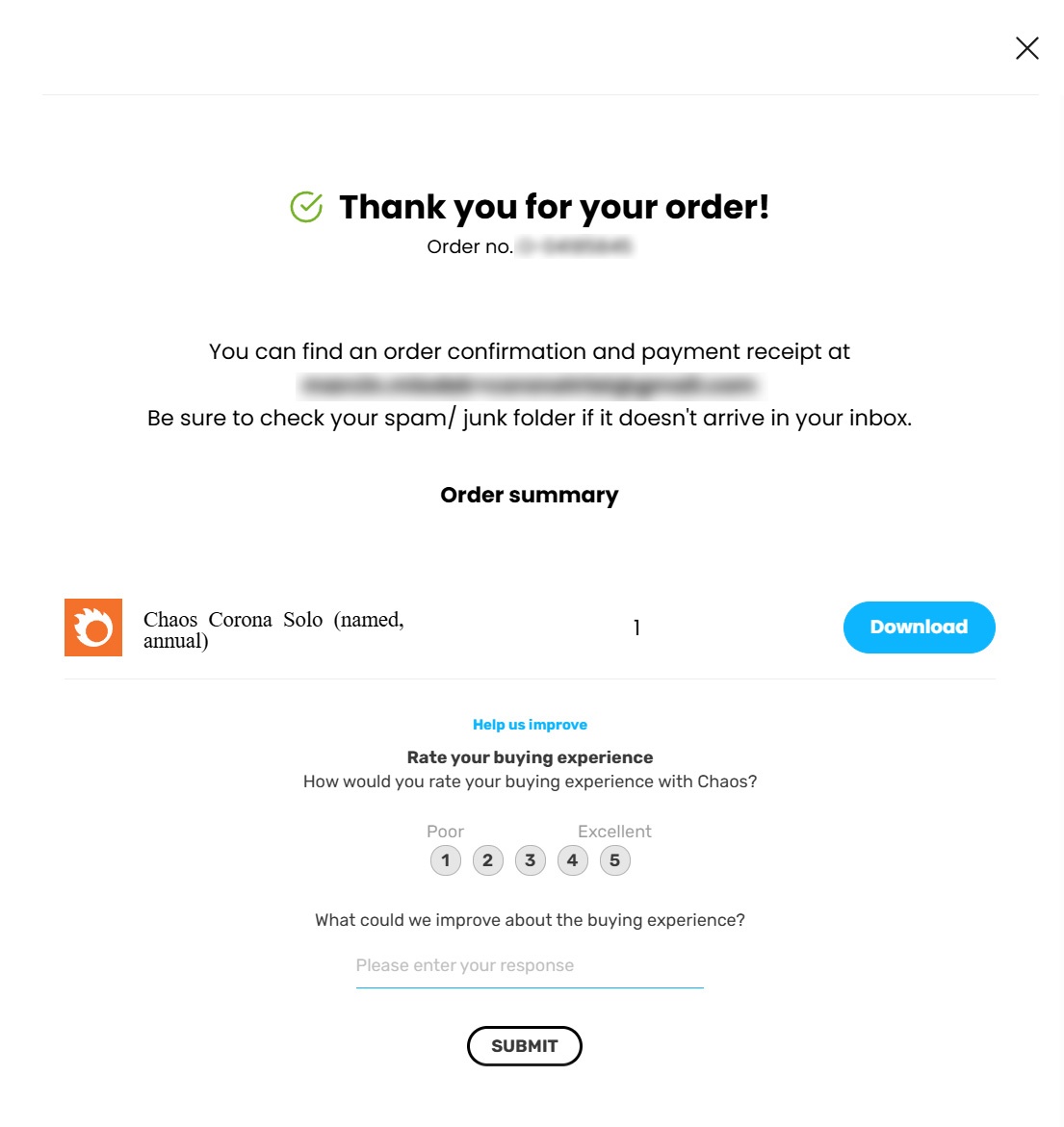

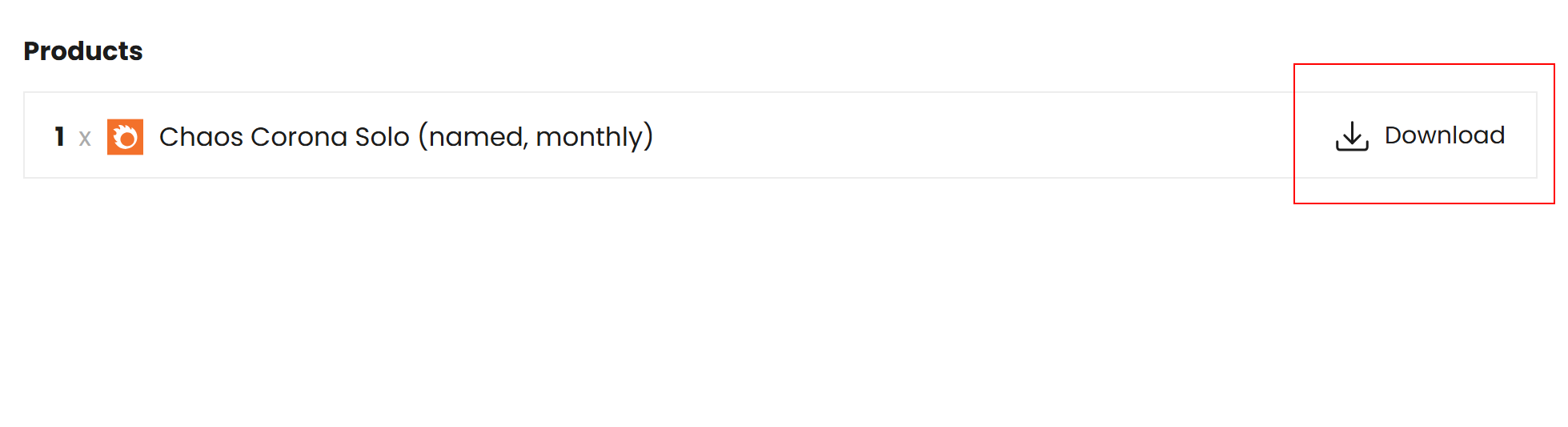

Download Trial Product
Go to the Chaos download page to download the latest release. This can be found here: https://my.chaos.com/download/build?product=Corona

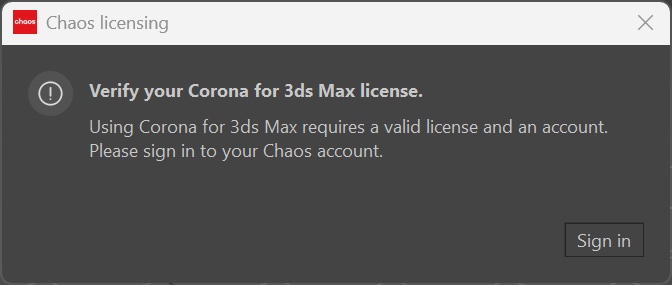

Go to the address http://localhost:30304/ and:
  • If you see a green dot next to Online licensing and a Corona icon listed under your products - you are good to go!
  • If you see a Sign in button - click on it and proceed with the sign in process.

Open up 3ds Max and set the renderer to Corona. You are presented with a pop-up window.
Click Get a free trial and follow the prompts.

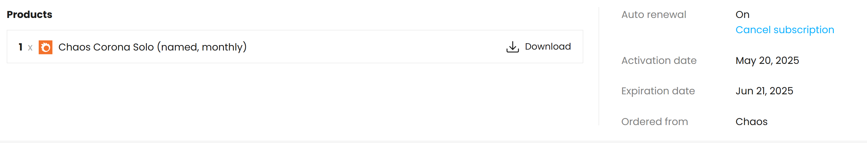

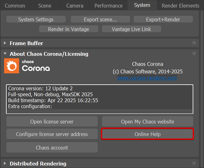

Chaos Corona for 3ds Max is now active on your system. You can confirm this from the Render Setup > System > About Chaos Corona/Licensing rollout.
A successful activation switches the "Activate license" button to the "Online help" button.
Alternatively, you can also check the status of your license in the Chaos License Server
Go to the Chaos download page to download the latest release. This can be found here: https://www.chaos.com/corona/download

Chaos Corona for 3ds Max is now active on your system. You can confirm this by going to Render Setup > System > About Chaos Corona/Licensing. If your license is active, you will see the Online Help button instead of the Activate license... button.
