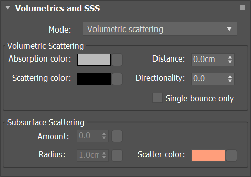

Volumetrics and SSS
Mode –  Switches the volumetric medium computation of the material between volumetric scattering and subsurface scattering(SSS). Volumetric scattering is better for translucent, thin liquid, fog, or smoke-like media. SSS is better for very thick, opaque media, inside solid objects, such as skin or marble.
Volumetric Scattering
Absorption colorAbsorption is controlled by setting the color that an originally white ray has after traveling the specified distance in the medium. Lower distance values make the effect stronger. Distance of 0 is a special value that disables the effect completely.  It can be set as a constant color or mapped by a texture map.
Distance (Absorption)Specifies the traveling distance of an originally white ray after which the ray has the Absorption color. Lower distance values make the effect stronger. Distance of 0 is a special value that disables the effect completely.
Scattering ColorStrength and color tint of the volumetric scattering inside the material. Setting a non-black value enables volumetric scattering/SSS effects for the material. Every time the light scatters inside the material, it gets multiplied by this value. It can be set as a constant color or mapped by a texture map.
DirectionalitySpecifies directionality of scattering. A value of 0 produces isotropic (diffuse) scattering positive values produce forward scattering and negative values produces backward scattering. The default value of 0 is suitable for most media, with the exception of clouds, where a higher positive number produces the effect of a silver lining. A value close to 1 or -1 increases the amount of image noise.
Single bounce onlyWhen enabled, only a single bounce(direct lighting) is scattered in the medium. This results in a biased (darker) but fast rendering. Useful e.g. for rendering god rays.
Subsurface Scattering
AmountControls how much the material color is defined by subsurface scattering as opposed to diffuse reflection. A value of 0 results in no subsurface scattering, while a value of 1 results in full subsurface scattering and no diffuse component. It can be set as a numeric value or mapped by a texture map.
RadiusDefines the subsurface scattering radius, i.e. how far the color scatters from a place that was hit by a light beam. It can be set as a numeric value or mapped by a texture map.
Scatter colorDefines the scatter color of subsurface scattering, i.e. the color that can be observed in the shadowed parts of the material. It can be set as a constant color or mapped by a texture map.

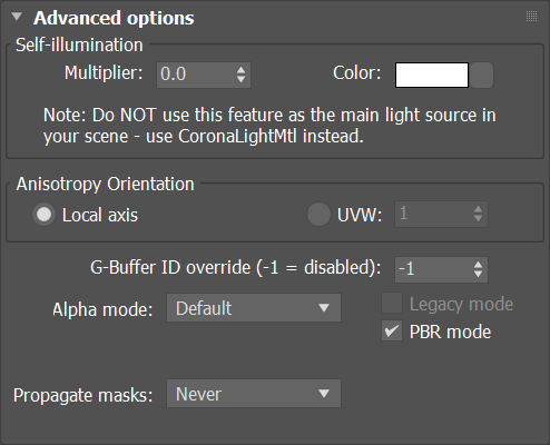

Advanced Options
Self-Illumination
MultiplierControls the emission property of the material. Useful to create emissive surfaces like LED text, cellphone displays, etc.
ColorSpecifies the emissive color of the material. It can be set as a constant color or mapped by a texture map.
Do not use self-illumination as the main light source in your scene. Use the Corona Light Materials or Corona Lights instead.
Anisotropy Orientation
Local axisThe highlight direction rotates around the local object Z-axis. It sticks with the object when it is rotated/moved.
UVWThe highlight direction follows the direction of the U or V mapping coordinate on the object surface. The mapping channel used for this is explicitly specified.
G-Buffer ID overrideIf set to anything other than -1, this value overrides the 3ds Max property. This allows you to set values outside of the 0-15 range permitted in the 3ds Max property.
Alpha modeSpecifies how the objects with the material are visible in the alpha channel:
DefaultThis is the default mode. In this mode, the material alpha value is derived from its opacity and refract components.
Always blackIn this mode, the material alpha value is black (material shows as transparent).
Always whiteIn this mode, the material alpha value is white (material shows as opaque).
PBR modeProvided for backward compatibility, should always be enabled, except when working with old assets. Disabled is the old (Corona 1.4 and older) and Enabled is the new (1.5+) shading mode for Corona materials. The old mode had clamped glossiness range and bright highlights on specular surfaces with a low glossiness range and no edges darkening or brightening with low glossiness, making it easier to use and compliant with emerging industry standards.
Propagate masksSpecifies the propagation of non-shading render elements (masks) after interaction with the material.
NeverRender elements are never propagated through the material, i.e. the material is always visible in masks.
Through reflectionRender elements are propagated through the material, if reflection occurs.
Through refractionRender elements are propagated through the material, if refraction occurs.
AlwaysRender elements are always propagated through the material, i.e. the material is never visible in masks.

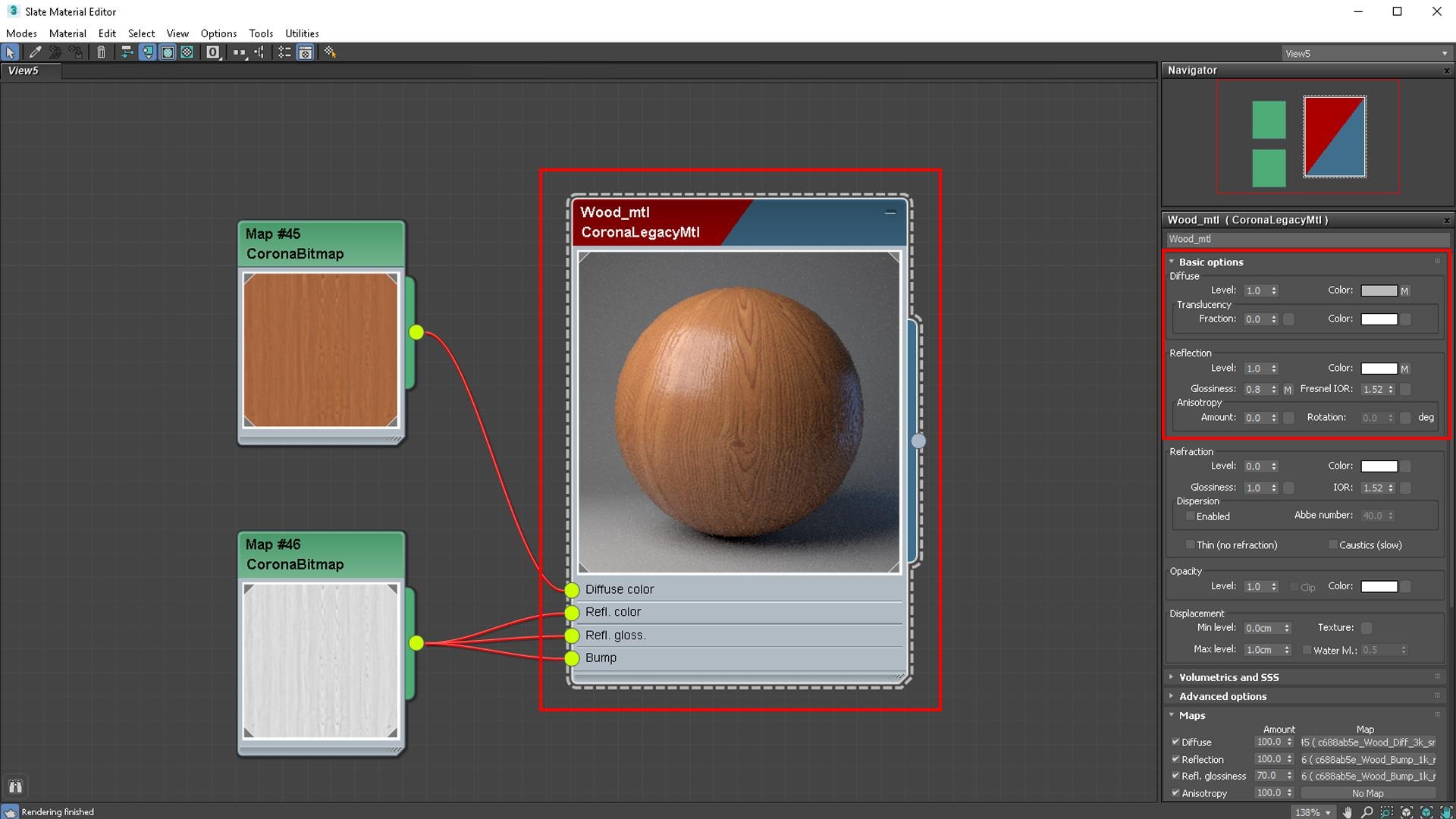

Decorative elephant prop with glossy wood material controlled with bitmaps

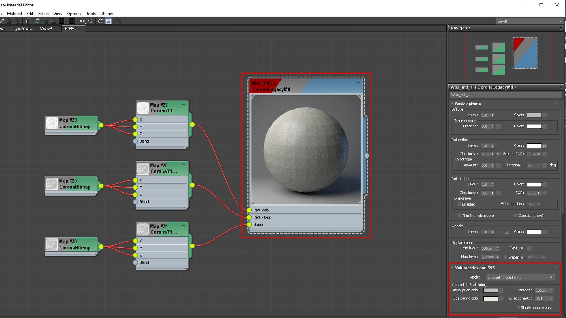

Candles using wax material with Volumetric Scattering enabled
Click on the picture to see it in full size.
