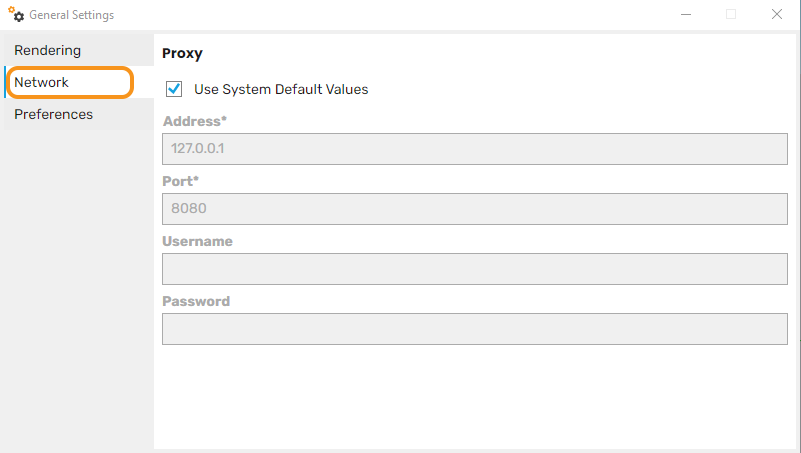

Open the General Settings

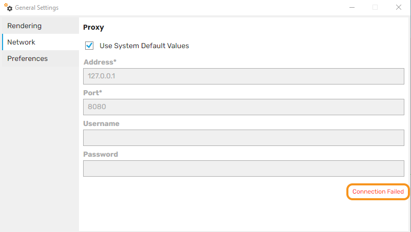

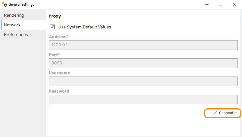

window and select the Network option. By default these Proxy Server settings are set to use those default settings provided by your IT administrator. If you want to enter some other proxy server settings, click the Use System Default Values checkbox to clear that option. This will allow the disabled fields to become active and allow for custom Proxy settings where required. Otherwise, just keep the Use System Default checked. Enscape will tell then test the connection automatically and inform you if the connection is working or not.Enscape Configure Proxy options
Enscape will automatically check your connection is functioning. If you have the Use System Default Values checked under the Proxy settings and Enscape shows a Connection Failed message, it means that the specified Port is blocked by the antivirus or firewall.
Port is not blocked
Port is blocked

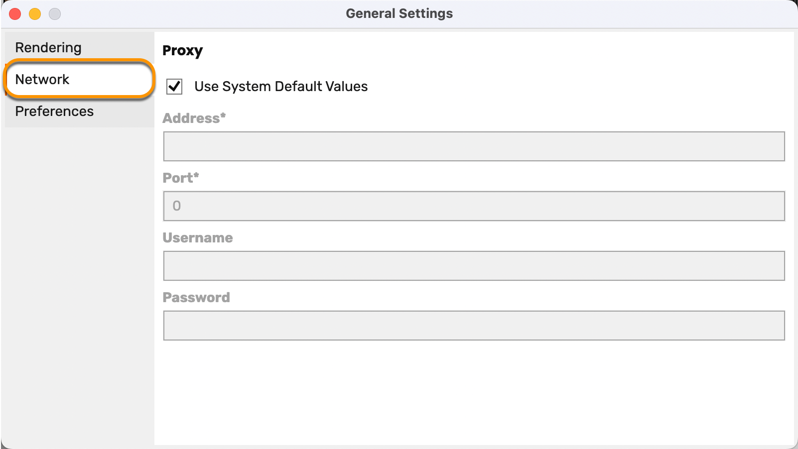

window and select the Network option. The proxy server settings displayed are taken from your Mac’s System Preferences. If you want to enter other proxy server settings, you have to do this in the System Preferences of your Mac.You can find the settings under System Preferences > Network > Used Network Connection > Advanced… > Proxies

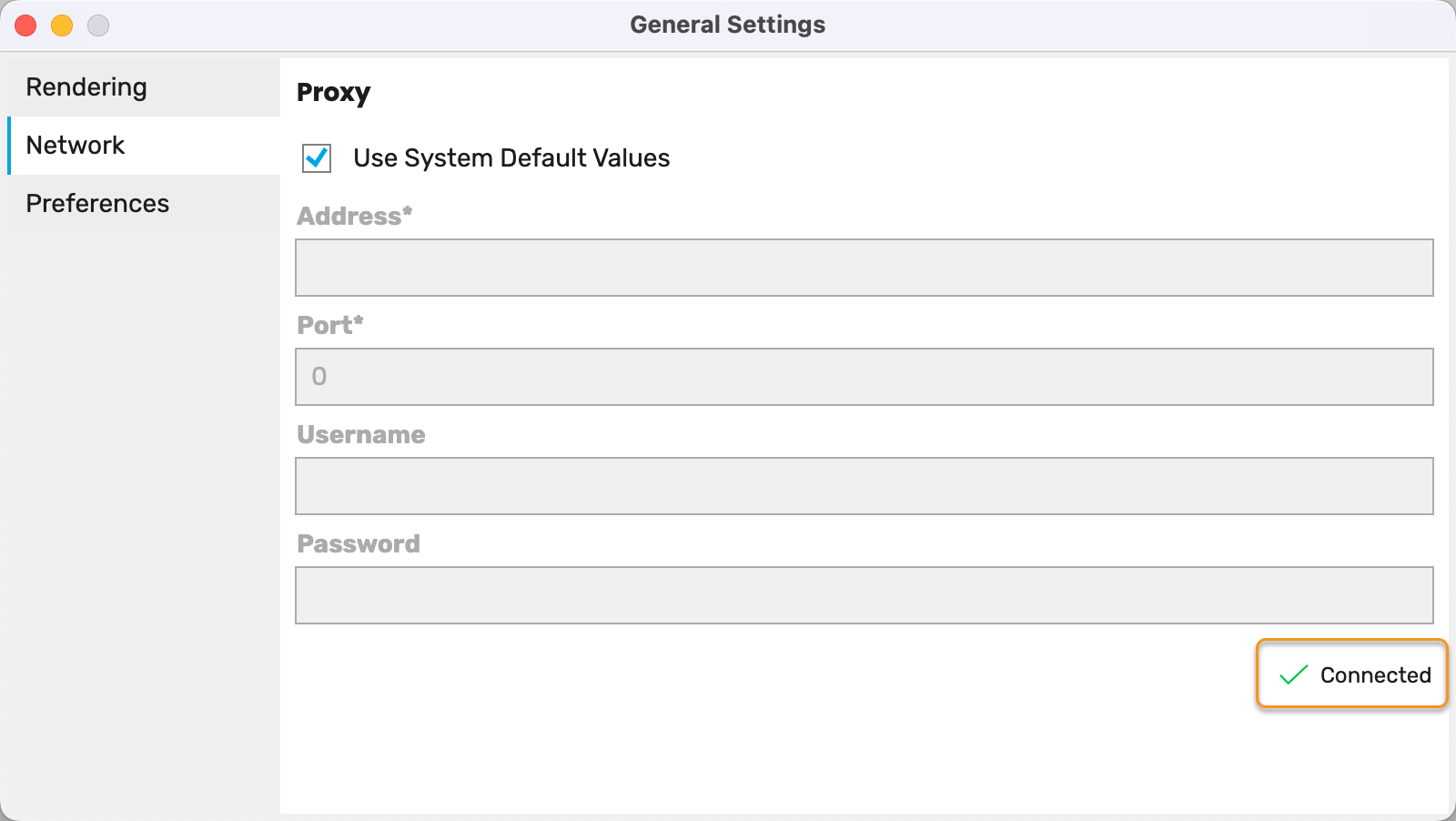

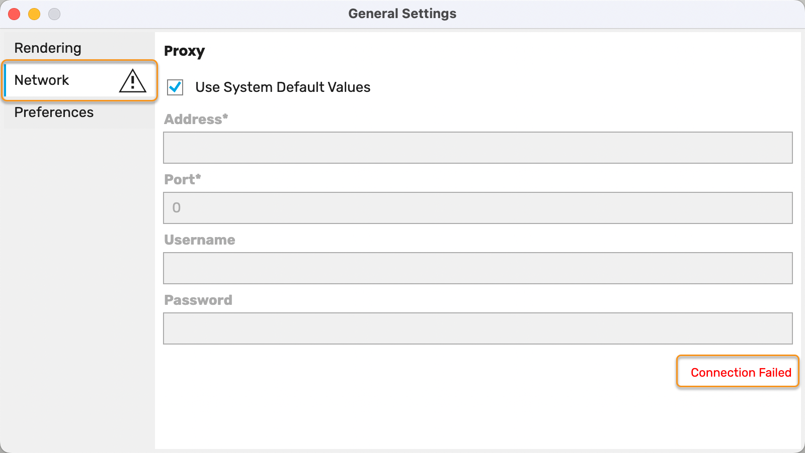

Each time you open the network tab or put in a new proxy address, Enscape will automatically test the connection. You will see a green checkmark on the bottom right confirming that the connection is working. If you get an error message and the proxy settings are set correctly, it means that Enscape or the specified port is blocked by an antivirus program or firewall.
Port is not blocked
Port is blocked
