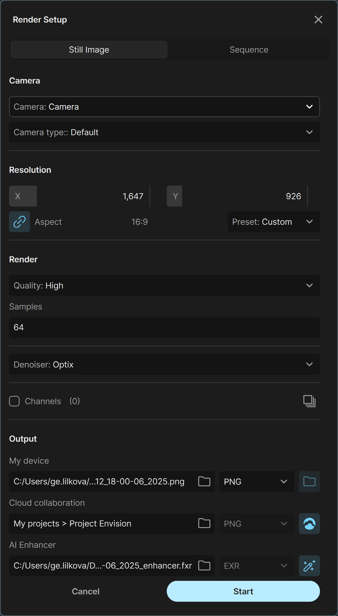

  • Go to Render menu > Render image(s) and open the Render Setup window.
  • In the AI Enhancer field under the Output section, choose a destination to save the rendered image.
    You are prompted to select a file format too. Choose EXR.
  • Click the button to enable the AI Enhancer. Thus, the output is automatically uploaded to Chaos Cloud Collaboration after rendering.

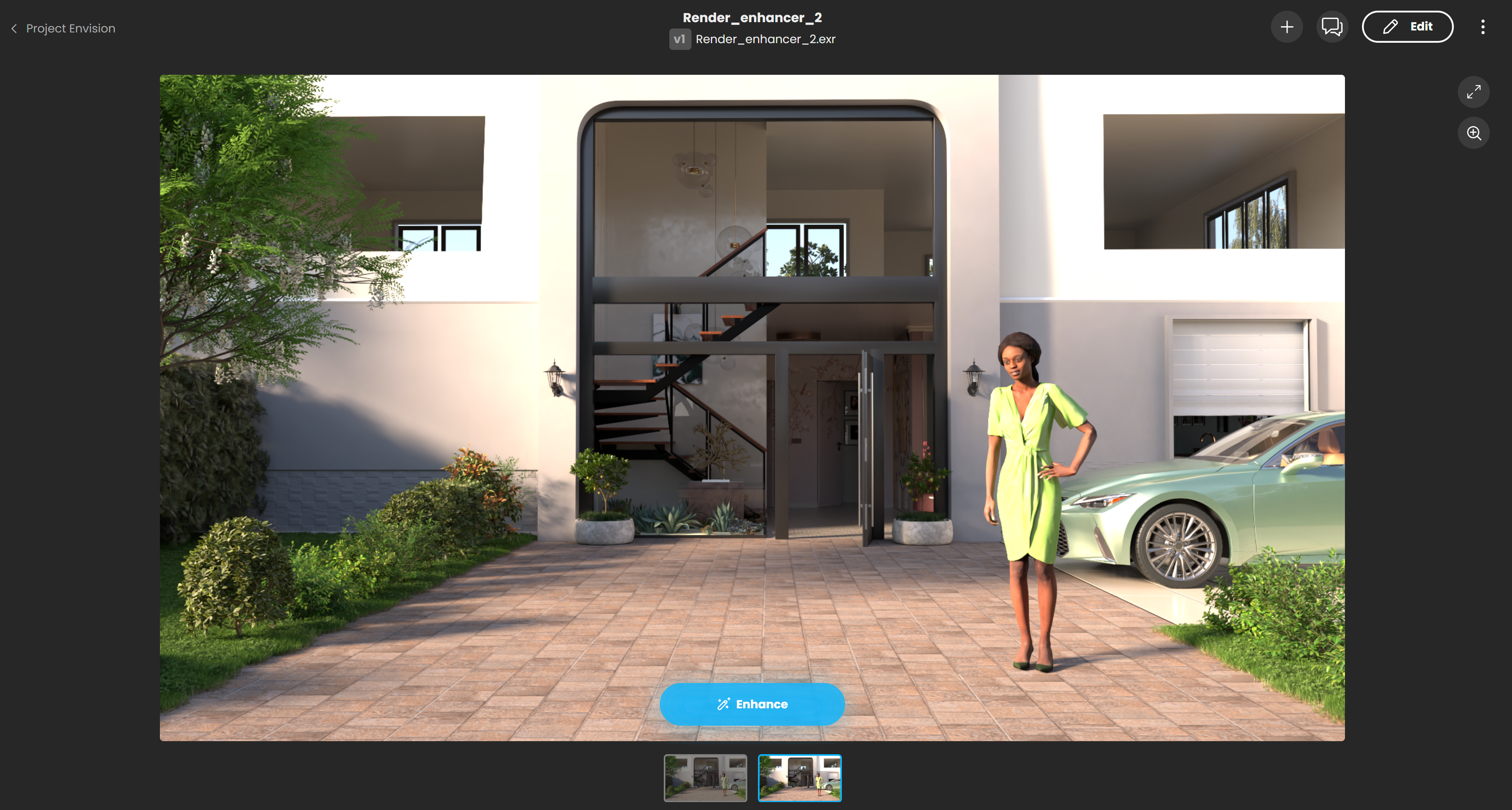

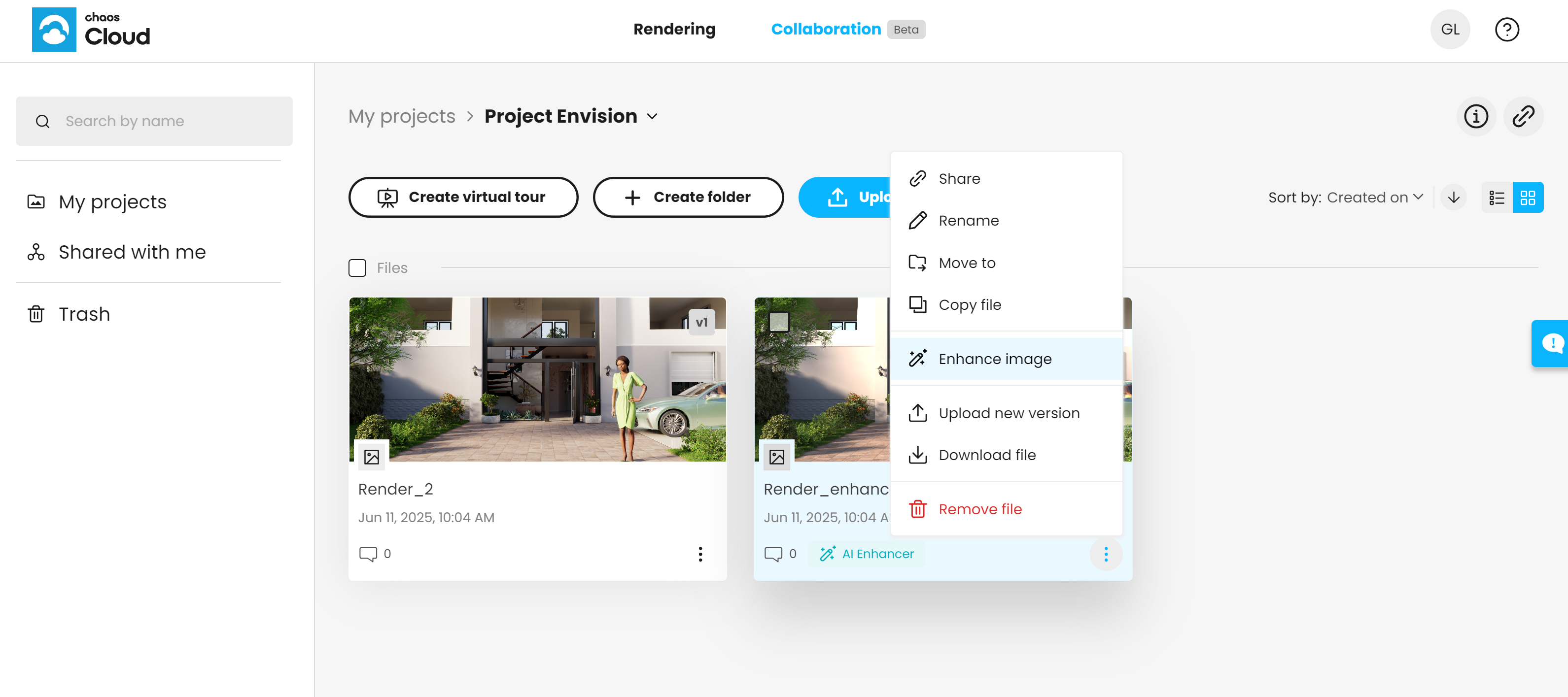

  • Go to the Chaos Cloud Collaboration website and select the image.
  • Click on the menu and select Enhance image. This initiates the enhancing process.
    Alternatively, open the image and then click the Enhance button.
  • Once the image is enhanced, you can download it from the dropdown menu.

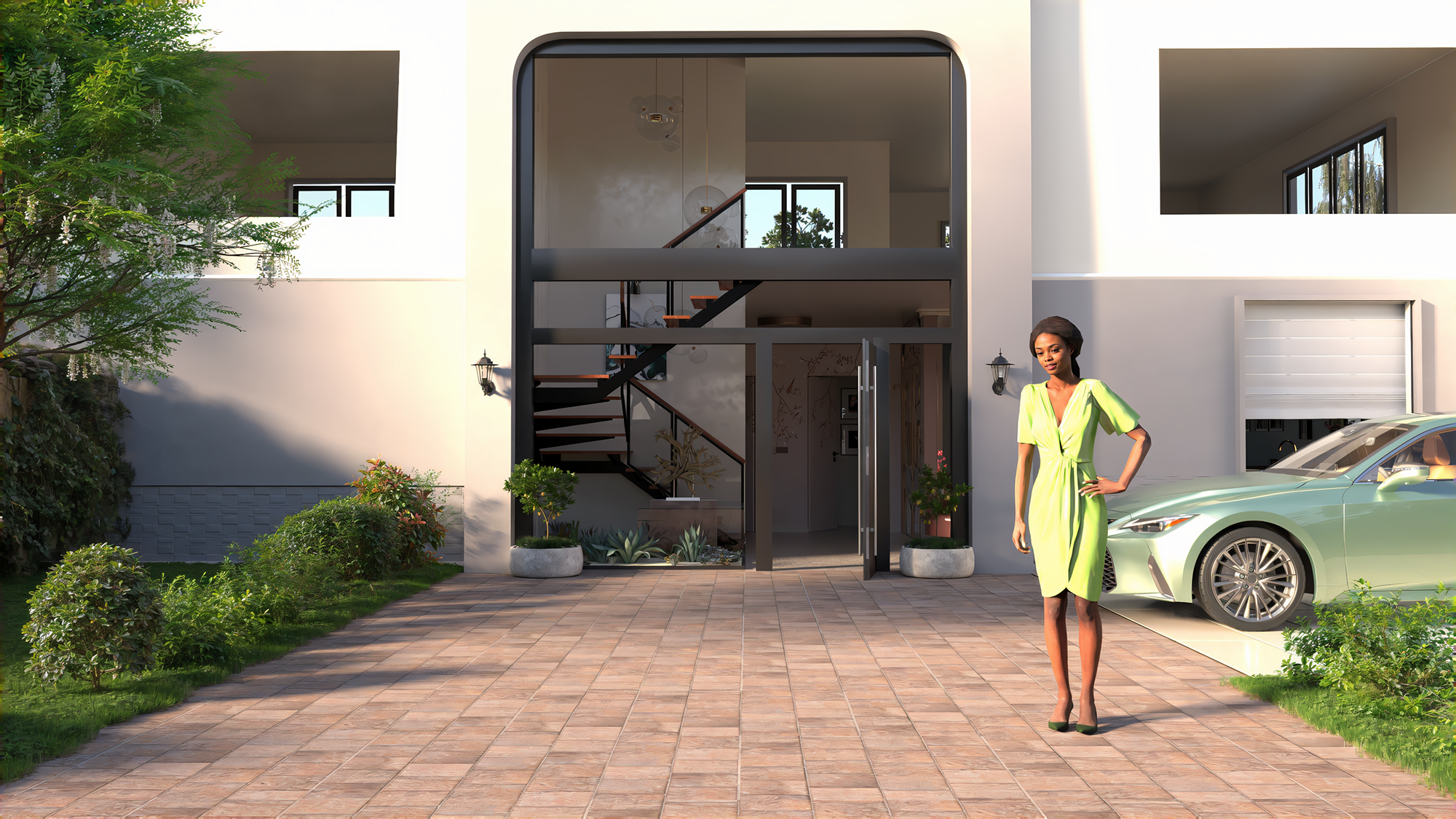

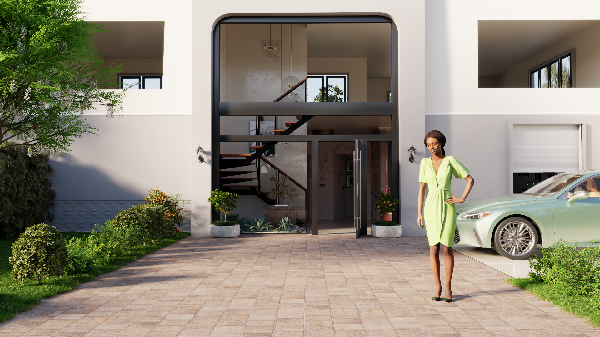

Example: AI Enhancement
The following example compares the originally rendered image, as uploaded to Collaboration, with an enhanced version processed using the AI Enhancer tool to demonstrate the visual improvements achievable through AI-powered enhancement.
Original
Enhanced
