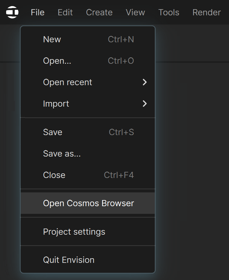

File menu > Open Cosmos Browser

1. Go to the File menu and select the Open Cosmos Browser option to open the Chaos Cosmos Browser.

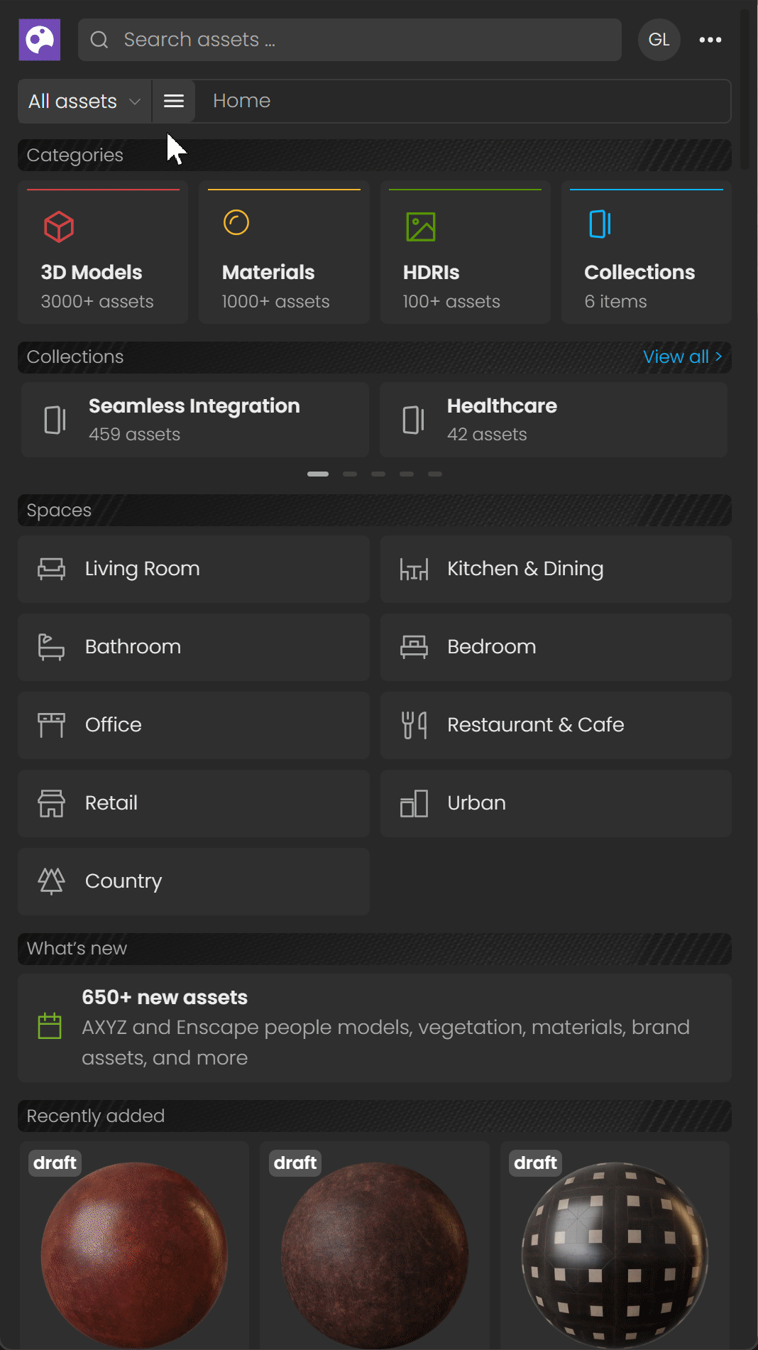

2. Use the menu or the Search tab to find assets. You can additionally choose between different Categories. An option to show Downloaded assets only is also available.
The filters help you refine your search by date, popularity, color, and space.

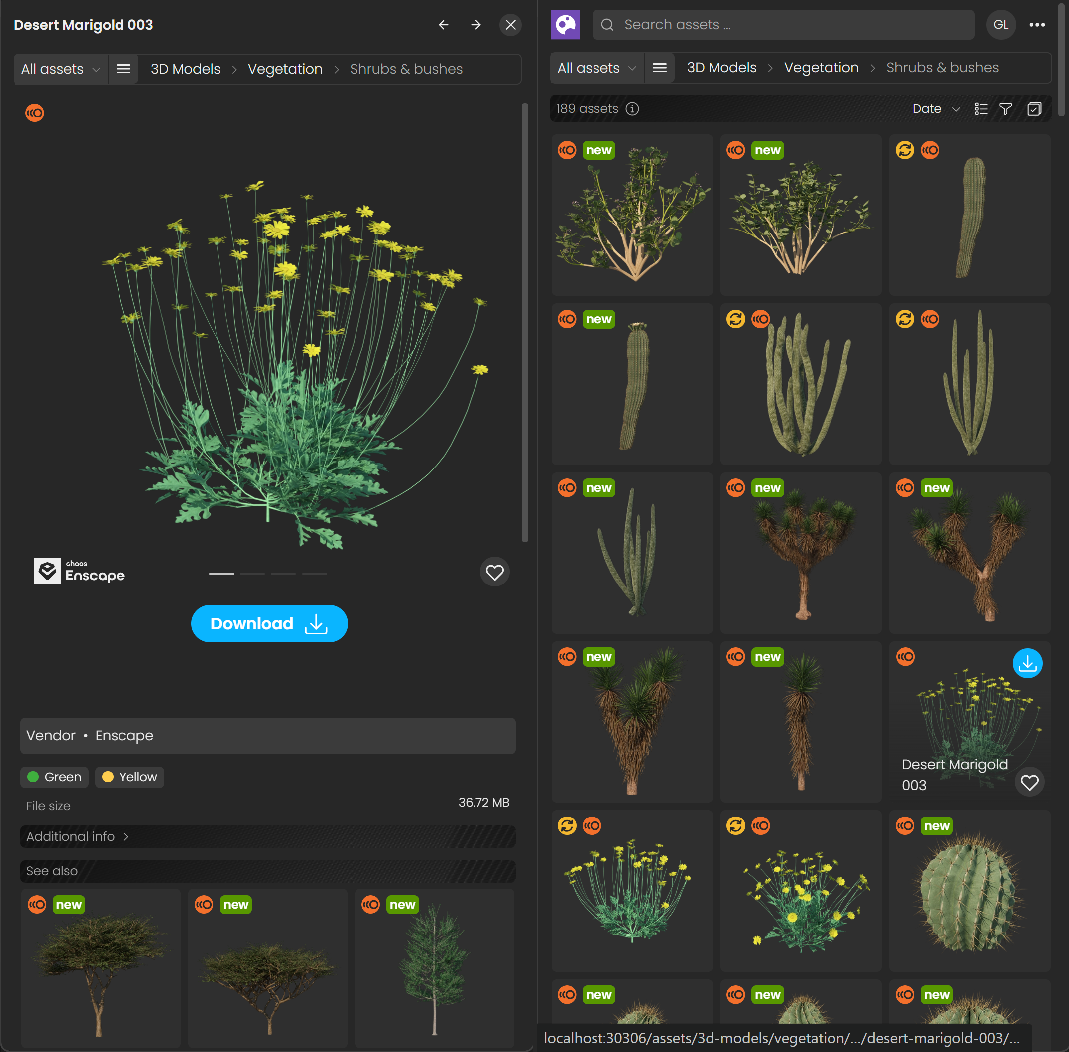

Download Assets

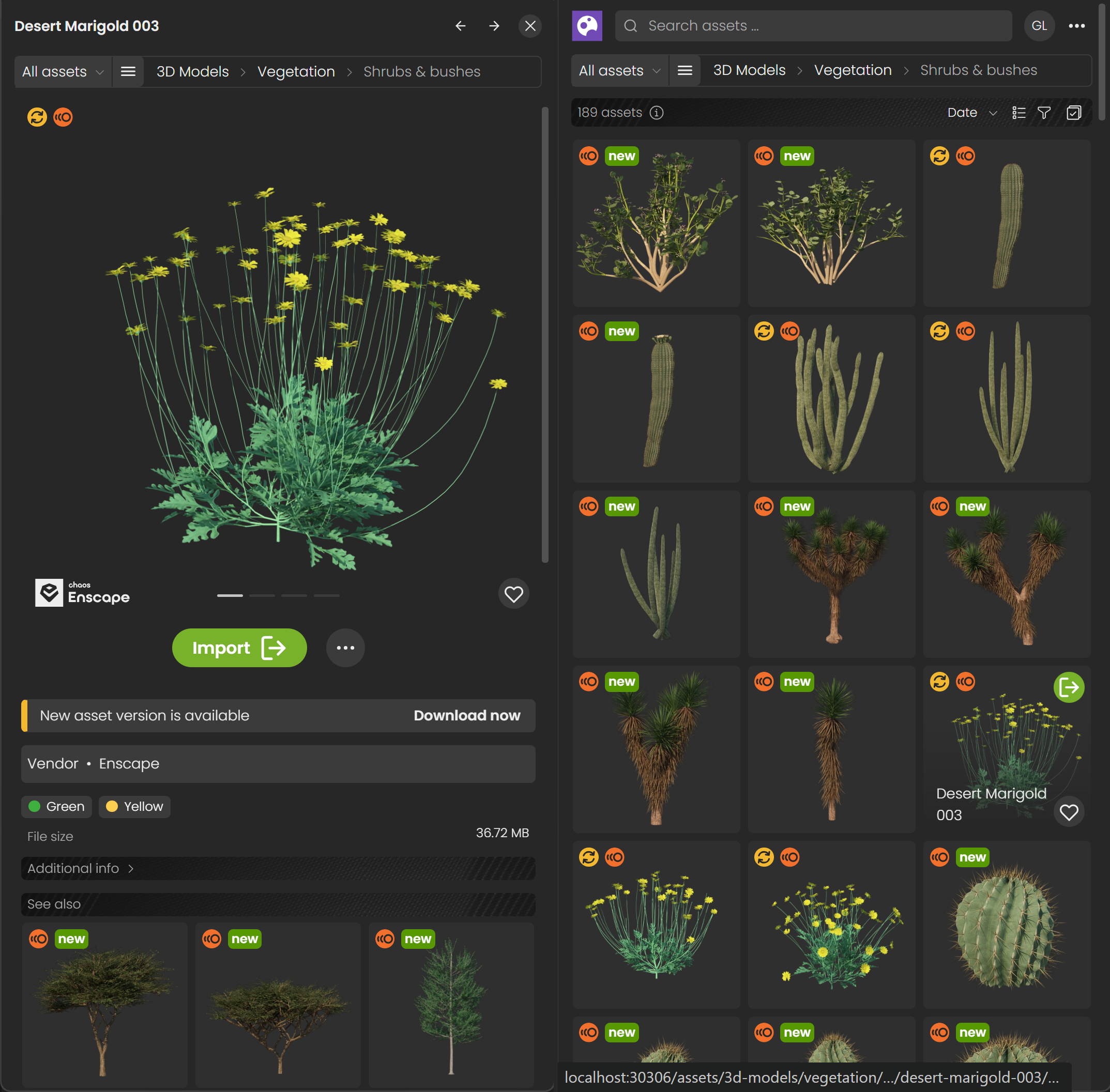

Once you choose an asset, you have to download it. Hover over it and click the Download  button.
Another way to download an asset is to click on it and open it in a pop-up window. This reveals additional information such as the category/space/color of the asset and other details. Other connected assets can be filtered by clicking on any of the additional information parameters. Click the Download button to download the asset.
All downloaded assets are marked with  symbol. They are available in the Downloaded category.
Any Cosmos asset can be marked as your favorite through the Like () button. Favorite assets are marked with  symbol and are available in the Likes category.

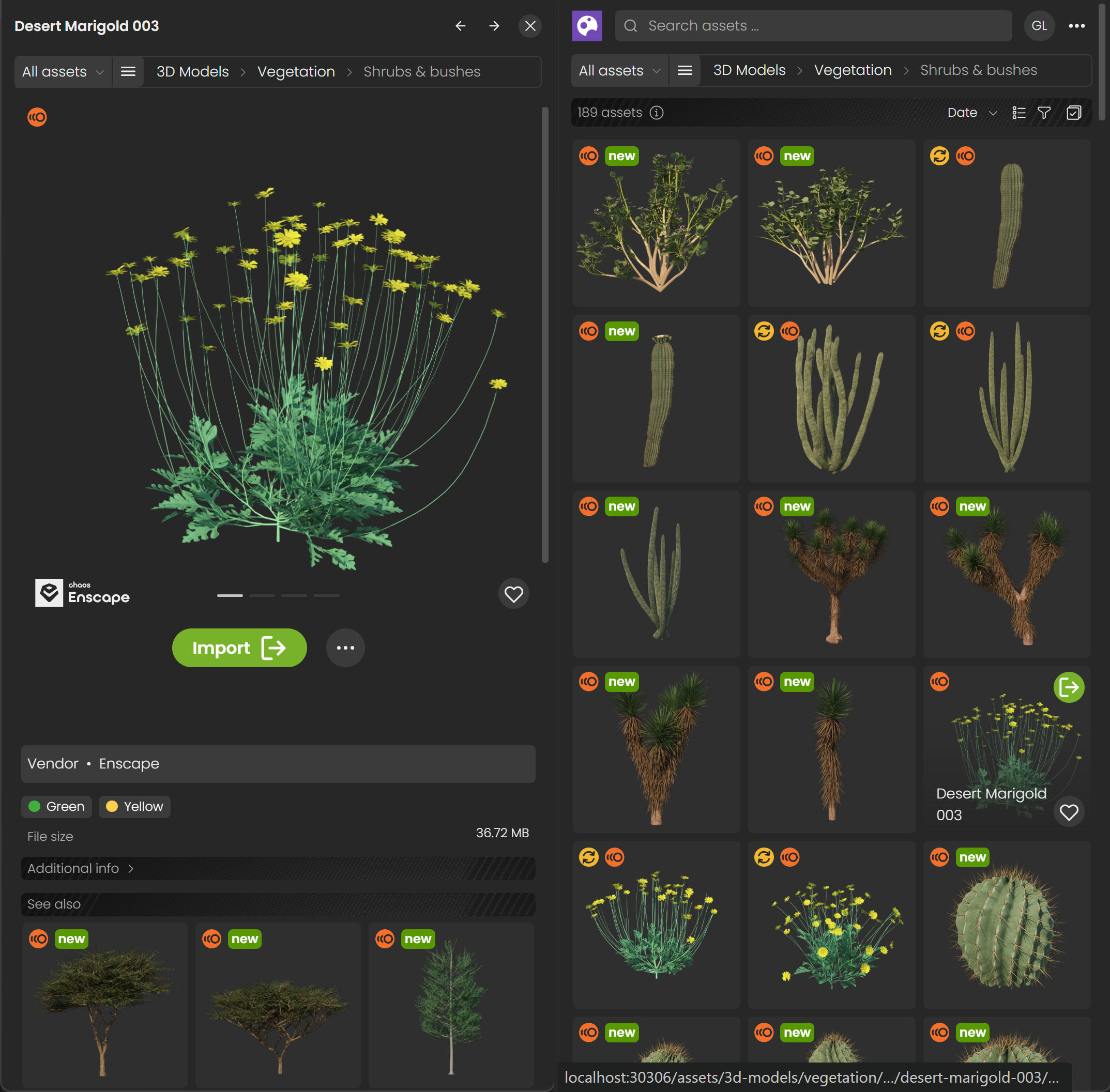

Import Assets
Once the download is complete, a pop-up window will state that the asset is downloaded successfully.

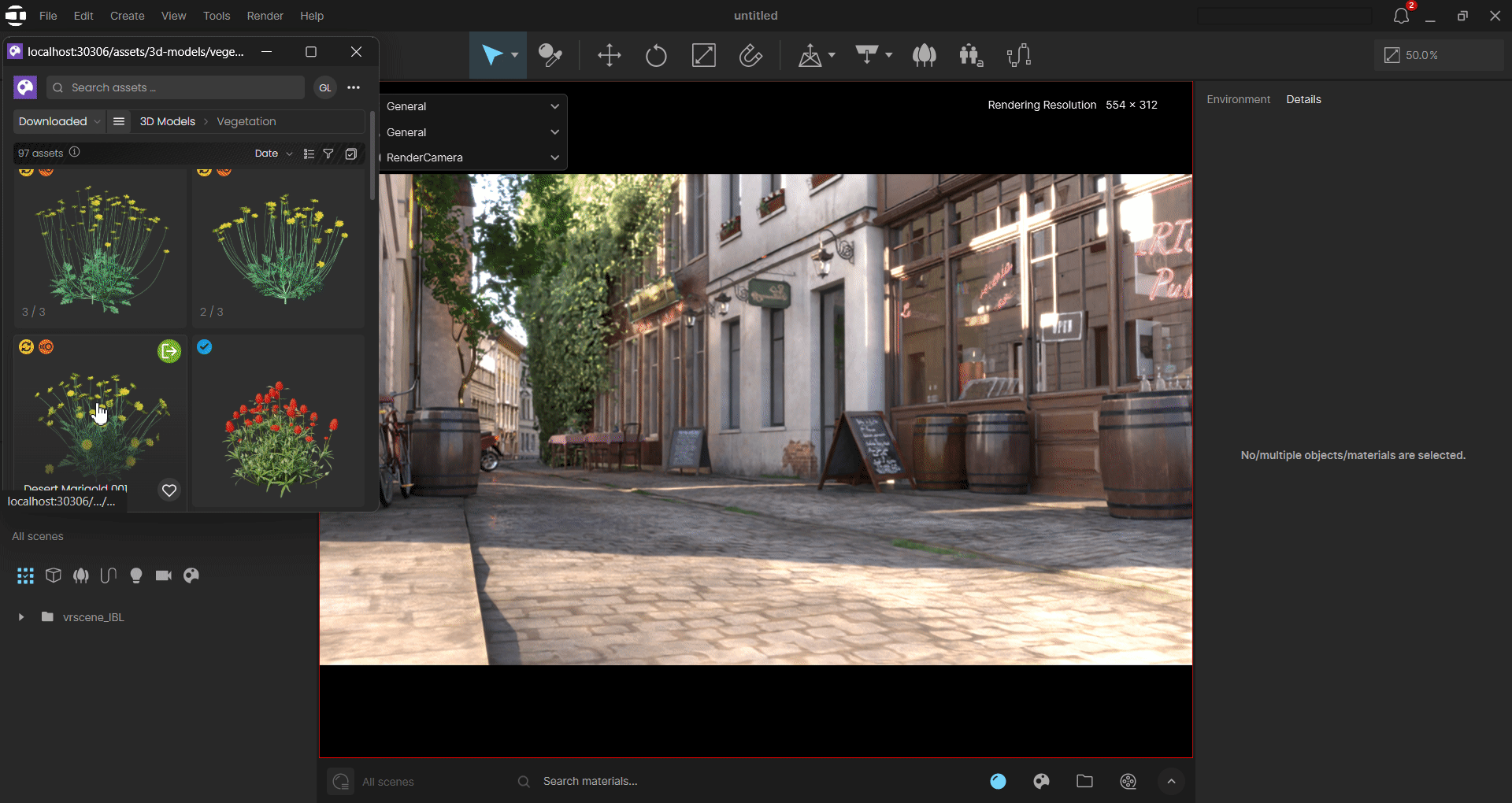

Use the Import button to bring the asset into Envision. Another way to import an asset is to click on it and open it in a pop-up window. Then click the Import button.
Alternatively, drag the asset into the viewport.
Note that downloaded assets can be reused across different host platforms. They are saved locally at the following default directory: C:\Users\[User]\Documents\Chaos Cosmos\Packages.

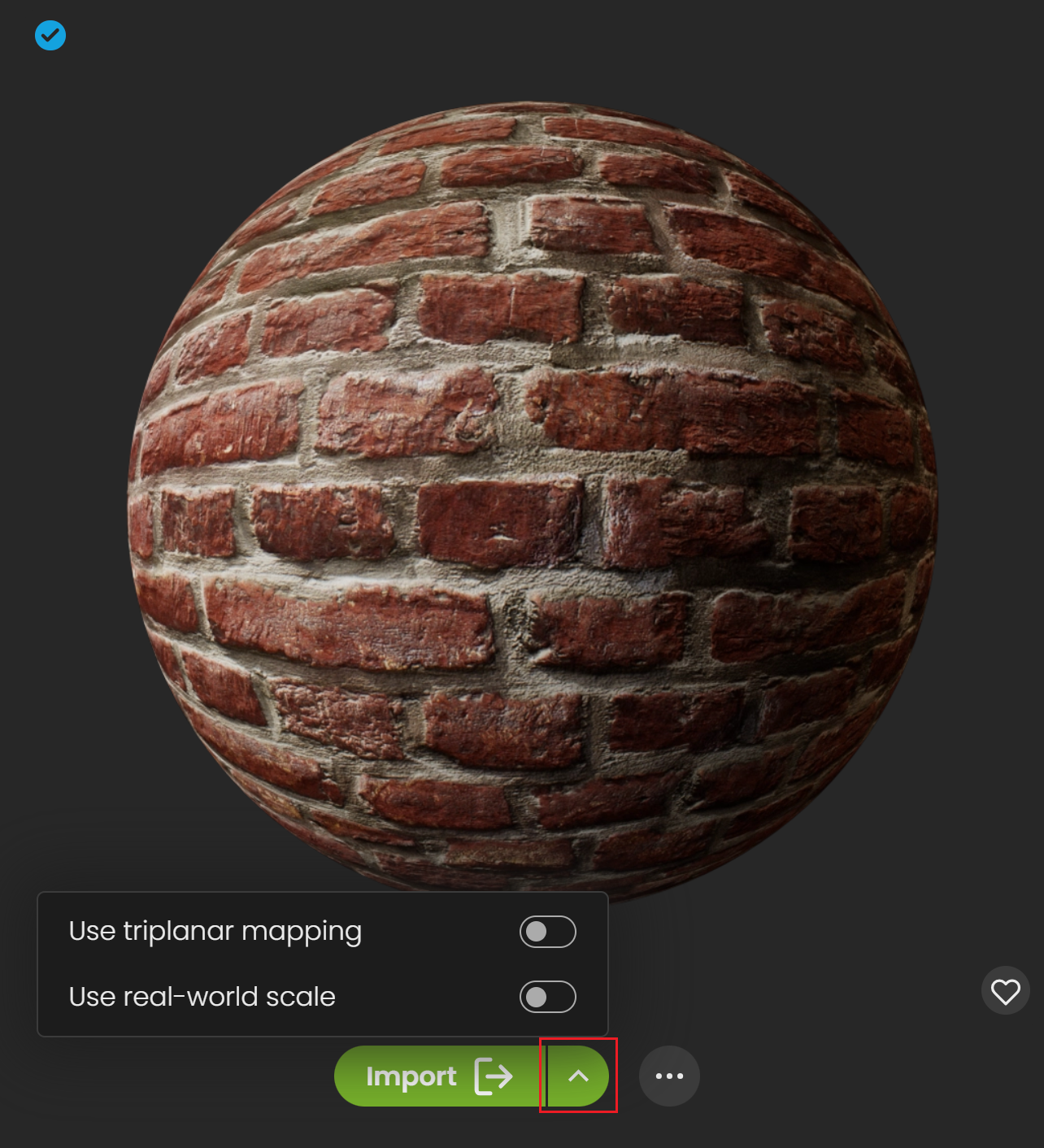

Once downloaded, materials can be imported via dragging onto a selected object. The imported material is visible in the Materials bottom tab.
Click the green arrow for two additional import options.
Use triplanar mappingEnables triplanar mapping on VRayBitmaps (when adding the material to a scene or selection).
Use real-world scale – Enables real-world scale mapping for VRayBitmaps (when adding the material to a scene or selection).
When an option is enabled in this menu, a blue circle () indicates the custom setup is in effect for any further material imports.

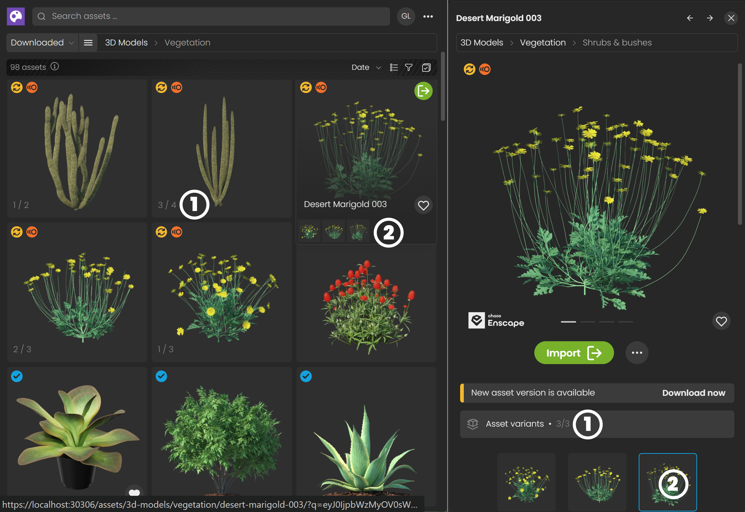

Assets with Variants
Some assets have more than one variant. Assets with variants combine different versions of the same asset into a single item in the library.
1. Assets with variants have an indicator displaying the total number of its variants.
2. To display the asset variants, hover over the asset. The variants show as small thumbnails and you can preview them by hovering over the thumbnail.
Note that you have to download and then import each individual variant if you want to have them all in your scene.

Cosmos assets get updated over time. When an update is available, an update label appears.
You can download the new versions from within the Chaos Cosmos Browser. Click on the labeled asset to open a popup window and click the Download now update text in the bottom.
