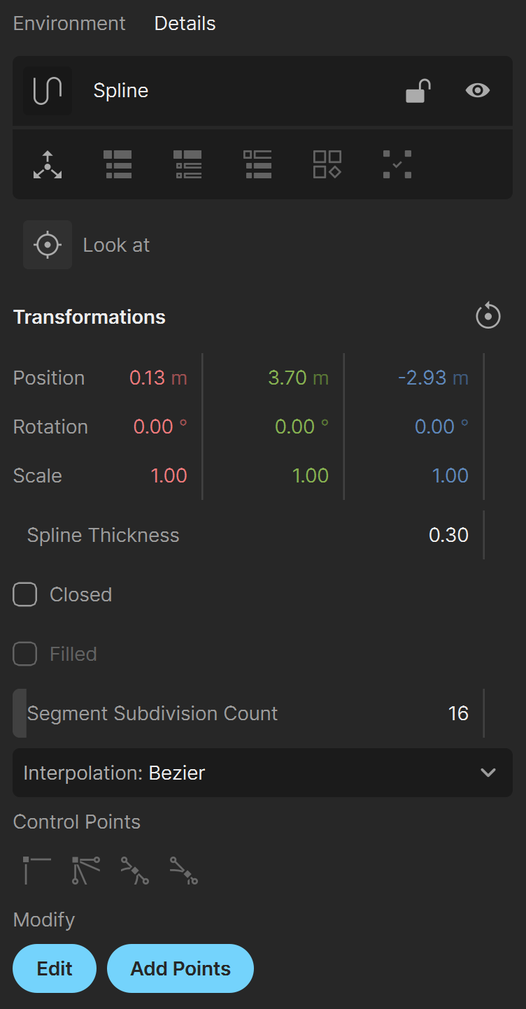

The spline parameters are accessible in the Details tab of the right-hand side panel when a spline is selected. Splines can be selected in the Splines filter tab of the Objects left-hand side panel tab.

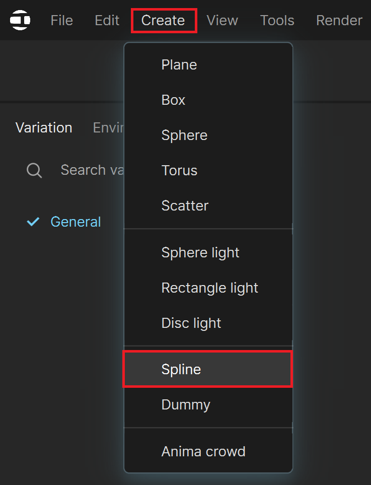

||Create menu|| > Spline

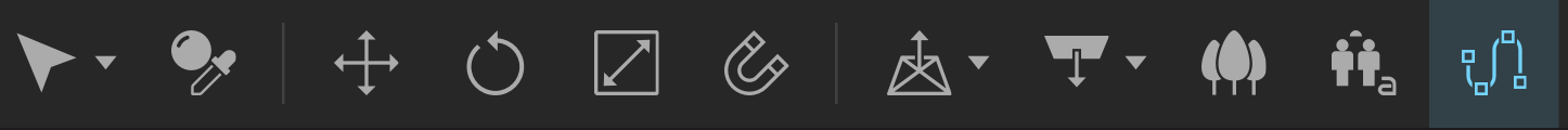

  • Click the Spline () toolbar button. Alternatively, go to Create menu > Spline. This activates the spline creation tool.

A field showing the type and name of the selected element, allowing you also to rename the element. The new name is automatically displayed in the respective Object subtab.
Lock – Disables the spline transformation options - position, rotation and scale. Disabled options become greyed out. Click to enable the options for manipulation again.
Hide – Toggles the visibility of the element on and off. Invisible objects are indicated by and are not rendered.
Move pivot – Opens the Pivot Point Adjustments settings. There you can move the pivot point.
Select hierarchy All  Selects the parent and all children of the current selection from within the scene hierarchy.
Select hierarchy Parent only  Selects only the parent of the current selection from within the scene hierarchy.
Select hierarchy All children  Selects the rest of the children in the scene hierarchy group the current selection belongs to.
Make instance unique  Excludes the selection from the rest of its instances and makes it unique. The action is disabled if the selection has no instances.
Select all instances  Selects all instances the selected spline has in the scene.
Look at  Picks an object the selected spline should look at during animation.
Revert the transformation – Restores all position, rotation and scale values to their default values, i.e. to zero.
Transformations
Position – Moves the spline along the X, Y and Z axes.
Rotation – Rotates the spline along the X, Y and Z axes.
Scale – Scales the spline along the X, Y and Z axes.
Spline Thickness – Specifies the spline thickness.
Closed – Automatically connects the last and the first segments of the spline.
Filled – Activated when Closed is enabled.
Segment Subdivision Count – Determines how smooth the spline is. The part of the spline between two control points is called a segment. Segments are subdivided into multiple straight lines. Curved segments need higher subdivision count to be represented smoothly.
Interpolation – Determines how the segments between control points are generated.
Catmull-Rom – All segments are automatically curved so that the whole spline is smooth and there are no sharp corners at the control points. This type of interpolation provides a very smooth spline, but there is no precise control over its shape. It is useful for camera fly-through trajectories.
Bezier – Each control point has a setting that determines the smoothness of its connected segments. The smoothness is controlled via additional viewport elements, called "tangent handles", that allow for a precise curve editing. This is why this type of interpolation is useful when a specific spline shape is needed, e.g. tracing a contour for Scatter include/exclude.
Linear – There is no smoothing and the segments between control points are always straight. This interpolation type is useful for simple shapes like triangles and rectangles.

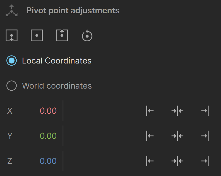

Moves the pivot to the bottom center of the bounding box.
Moves the pivot to the center of the bounding box.
Moves the pivot to the top of the bounding box.
Resets the pivot to its initial position.
Minimum bounding box value on X / Y / Z axis.
Center bounding box value on X / Y / Z axis.
Maximum bounding box value on X / Y / Z axis.
Local Coordinates – Uses the local coordinate when adjusting the pivot point. The local coordinate system is specific to each individual object. The X, Y, and Z axes are aligned relative to the object's transformation.
World Coordinates – Uses the world coordinate when adjusting the pivot. The world coordinate system is the global reference frame for the entire scene. The X, Y, and Z axes are always aligned with the scene’s global orientation.
XDisplays and specifies the selected pivot's position on the X axis. The value is World or Local coordinate space dependent.
Y – Displays and specifies the selected pivot's position on the Y axis. The value is World or Local coordinate space dependent.
Z – Displays and specifies the selected pivot's position on the Z axis. The value is World or Local coordinate space dependent.
