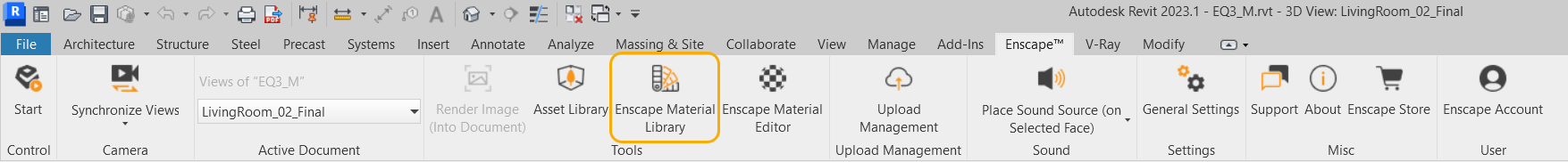

The Material Library can be accessed in one of two ways, and it’s worth noting that Enscape does not need to be open and running to gain access to either the Enscape Material Library or Enscape Material Editor when using an Enscape Fixed Seat License. Although, a free seat must be available if you are using an Enscape Floating License.
Material Library button in Revit

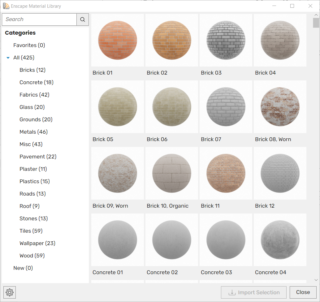

Either way will result in the Material Library dialog opening:
The Enscape Material Library dialog window

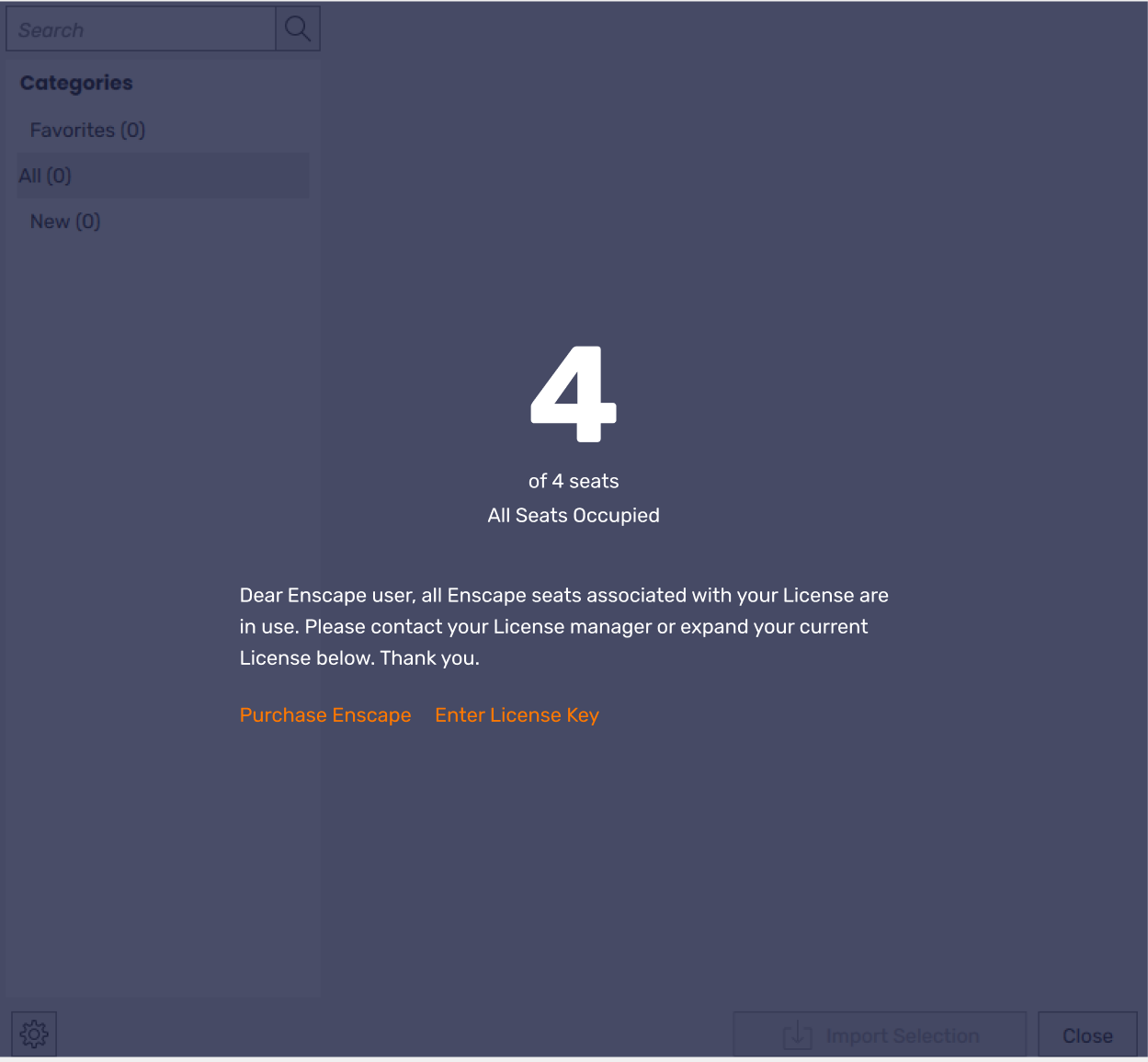

Being one of Enscape’s Core Features, where a license is invalid expired, whether that be a full or the 14 day trial license, or there are no seats available on a floating license, then the Material Library will be blocked from being used and you will see a notification similar to that shown below, depending on the cause.
For more information please refer to this article.

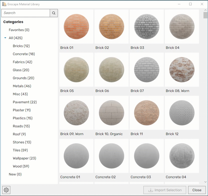

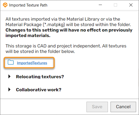

Before importing any materials, you should decide whether the project will be shared with another user for collaborative purposes. If this is the case, a storage location where all users working on a project will have access to should be used. Specifying this location as early as possible in a projects life-cycle is highly recommended. Therefore, you should pay attention to the ‘gear’ icon that can be found at the bottom left corner of the dialog in both the Material Library, and the Material Editor. If you do not adjust the storage location then when a project file is opened by another user, that user will not be able to access the materials assigned in the project due to the default storage location being assigned locally by default. This means that the materials assigned in the project will need to be manually reimported and reassigned. Please refer to the Materials articles for your specific CAD you are using for further information.
Pressing the ‘gear’ icon at the bottom left of the dialog therefore allows you this option to easily share projects by changing the location that textures are imported and stored to whilst also providing a warning dialog about modifying already imported textures that reside on the storage path, as well as a warning about relocating them to another location. This feature can allow you to store materials on a shared network drive for example.
Click on the Folder / Path link to change the storage location of imported textures, once you have selected your storage path, hit Save to close the Imported Texture Path dialog.
Working with the Material Library
You can select multiple material’s to import at one time, clicking the Import Selection button becoming available when at least one material is selected.
Furthermore, you can Favorite materials by clicking on the star buttons in at the top left corner of the tiles. These are then shown in the Favorites folder. Just click on the star again so it is not solid to remove materials from the Favorites folder.
New materials that get added over time by Enscape will show in the New folder, as well as being listed under their respective category.
Favorite and select a material to be imported to the Material Library

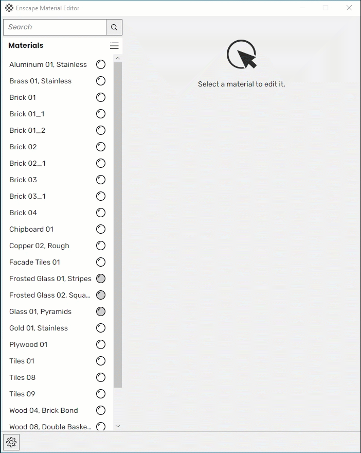

Once the import process has finished you will find the material listed in the Enscape Material Editor, where you can further edit the material if required.
Make sure to refer to the relevant CAD articles to understand how to work with the Enscape Material Editor with the CAD you are using Enscape with, including how to import *.matpkg files.
Material imported into the Enscape Material Editor
