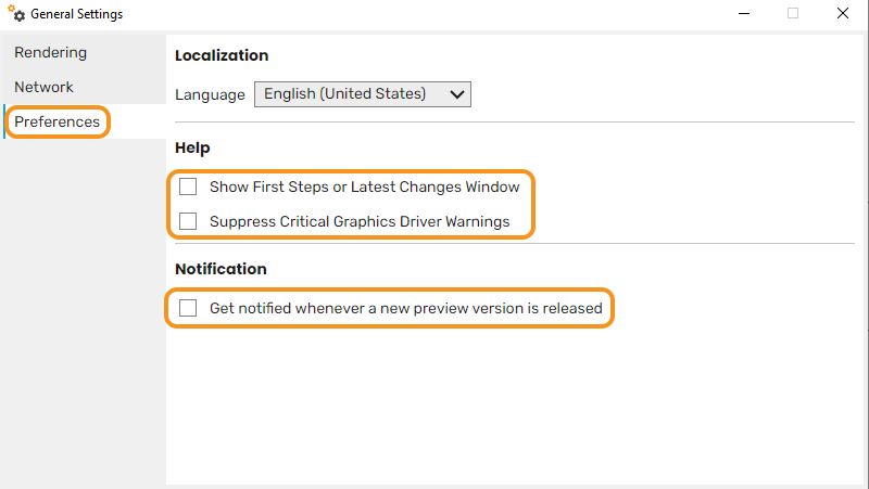

Enscape has the following Popups on Windows OS:
- The “First Steps” window that shows on the first start of Enscape
- The Update notification pop up for when a new Enscape version is available
- The Suppress Critical Graphics Driver Warnings that pops up when your graphic processing unit’s (GPU) driver is outdated
These can be disabled by opening the Enscape General Settings
window, and then select the Preferences option.These options can also be disabled when deploying Enscape to multiple machines across a network. To do this you should refer to the article Deploy to Multiple Machines.
Disable Update notifications option in the General Settings window
