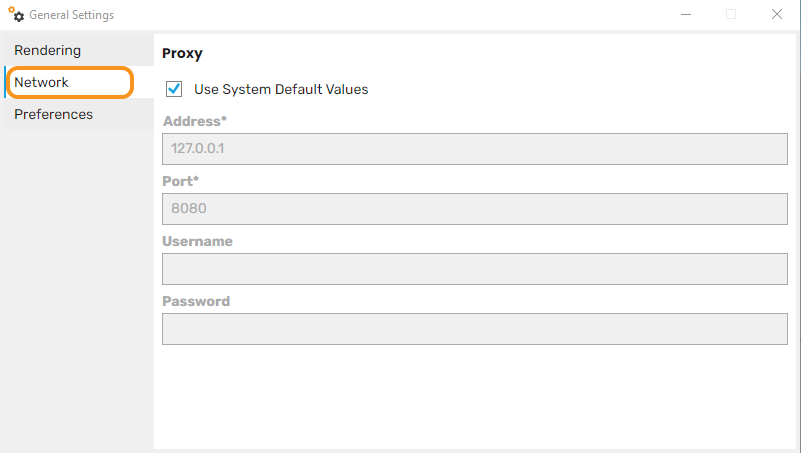

Before Enscape tries connecting to the Enscape licensing server to authenticate the License Key, you should check with your IT Administrator as to whether your machine connects to the internet via a proxy server and, additionally, whether you will need to specify some URL/IP exceptions in your Firewall.
Open the General Settings window and select the Network option. By default these Proxy Server settings are set to use those default settings provided by your IT administrator. If you want to enter some other proxy server settings, click the Use System Default Values checkbox to clear that option. This will allow the disabled fields to become active and allow for custom Proxy settings where required. Otherwise, just keep the Use System Default checked. Enscape will tell then test the connection automatically and inform you if the connection is working or not.
Enscape Configure Proxy options

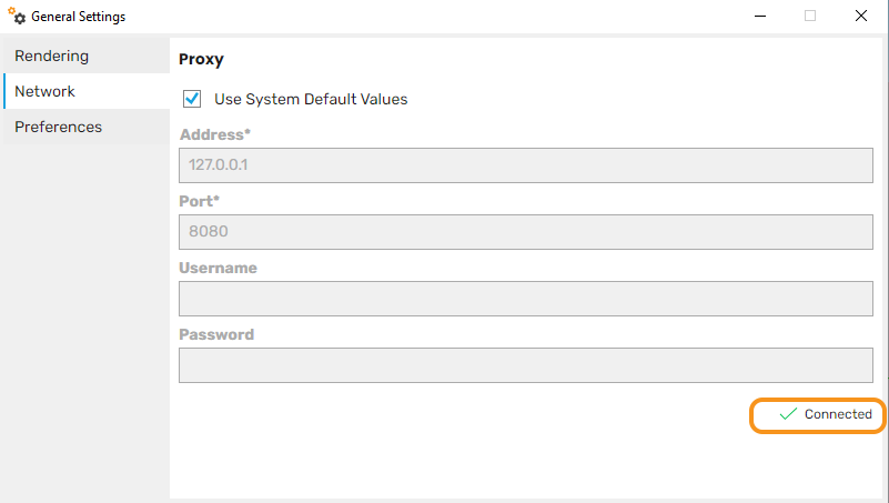

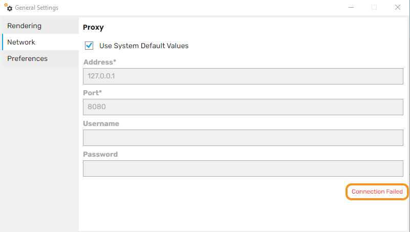

Enscape will automatically check your connection is functioning. If you have the Use System Default Values checked under the Proxy settings and Enscape shows a Connection Failed message, it means that the specified Port is blocked by the antivirus or firewall.
Port is not blocked
Port is blocked
