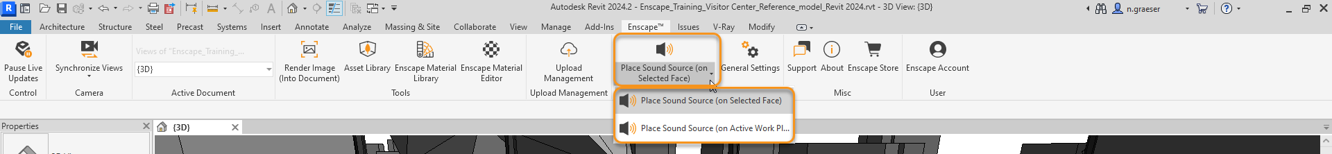

To add a sound source in Revit, click the Place sound source button in the Enscape ribbon.
Place sound source button in Revit
You will notice you have two options to place the sound source in Revit:
  • Place Sound Source (on Selected Face) – Click once to select the face the source should be placed on, and click a second time to select the endpoint of the source.
  • Place Sound Source (on Active Work Plane) – Click once to place the source on the Work Plane that has been pre-specified in Revit.

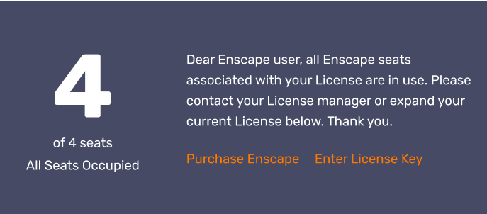

If the Enscape Objects dialog appears with a notification about the license being invalid, or that ‘All Seats are Occupied’, then please refer to this article to resolve this.
Notification that no seats are available

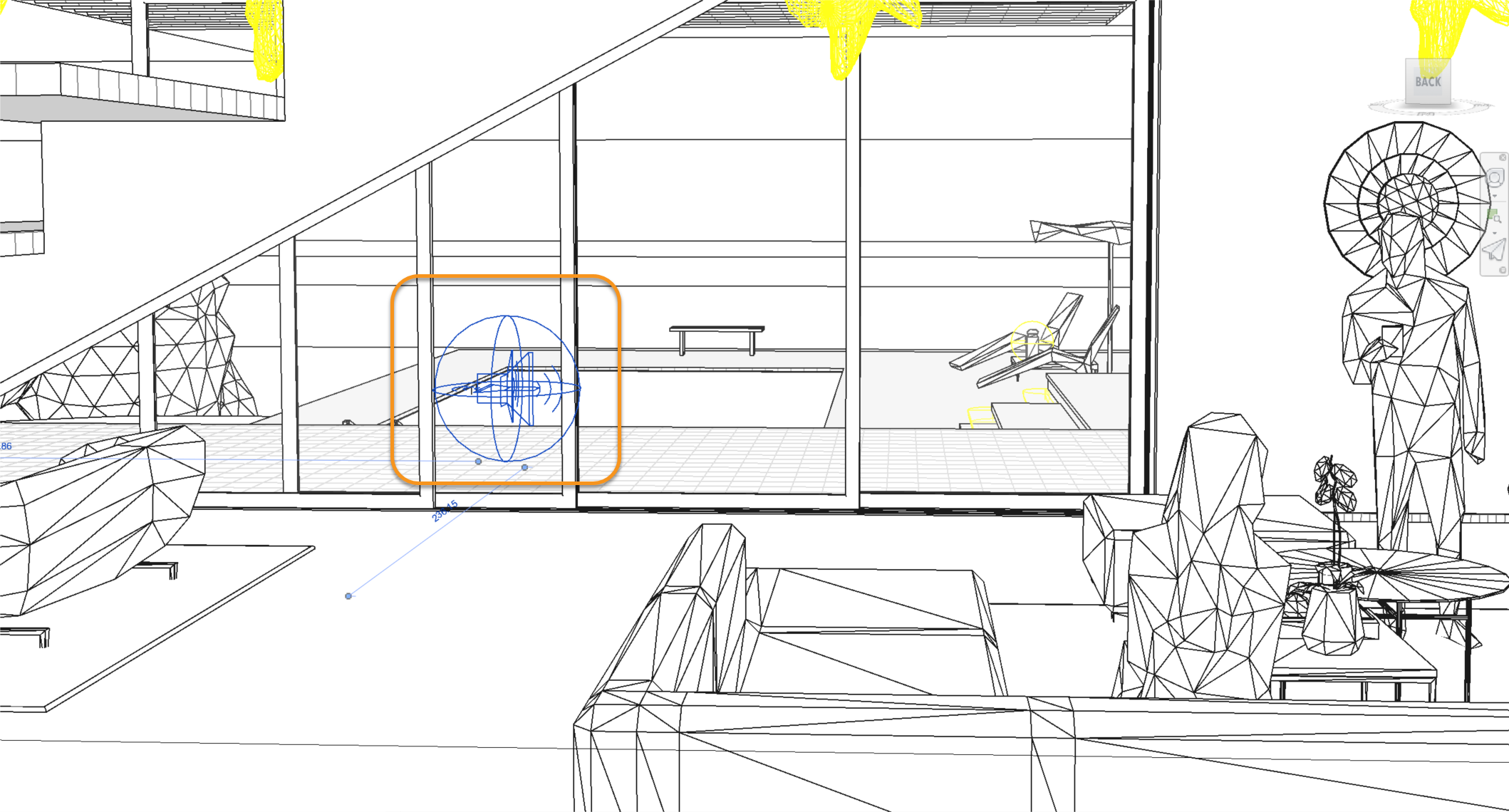

Once you have selected your sound file, its simply a case of choosing the location within the project you would like the sound source to be placed.
Placing the sound source in Revit
The Sound Source icon as shown in Revits viewport

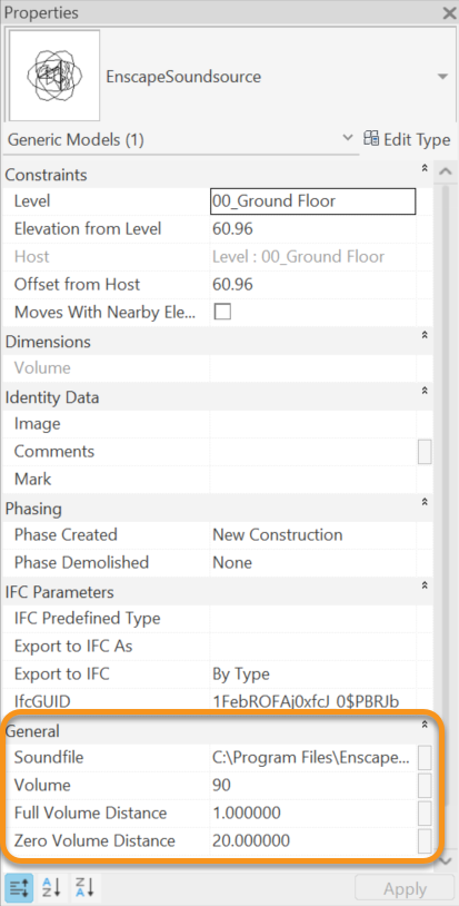

When the sound source is placed, you will be able to adjust the Volume, Full Volume and Zero Volume settings, and change your sound file if desired. When you select the sound source in your view, you will be able to edit these settings via the Properties menu in Revit. The Full Volume setting defines the distance from the sound source (in meters) that the sound is played at its full volume. Outside this radius, the sound will fade until it reaches the distance defined in the Zero Volume setting, at which distance the sound will stop playing altogether. When the Full and Zero Volume values are the same, the sound starts or stops immediately when you enter or exit the radius of the circle.
Sound Source details as shown in Revit's Properties panel

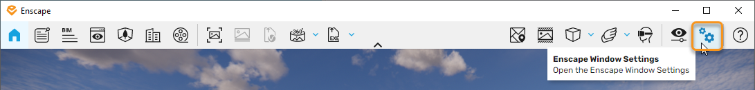

You will need to have Enscape running to access the options to enable / disable the sound source, as well as to hide or show the sound source in the Enscape viewport.

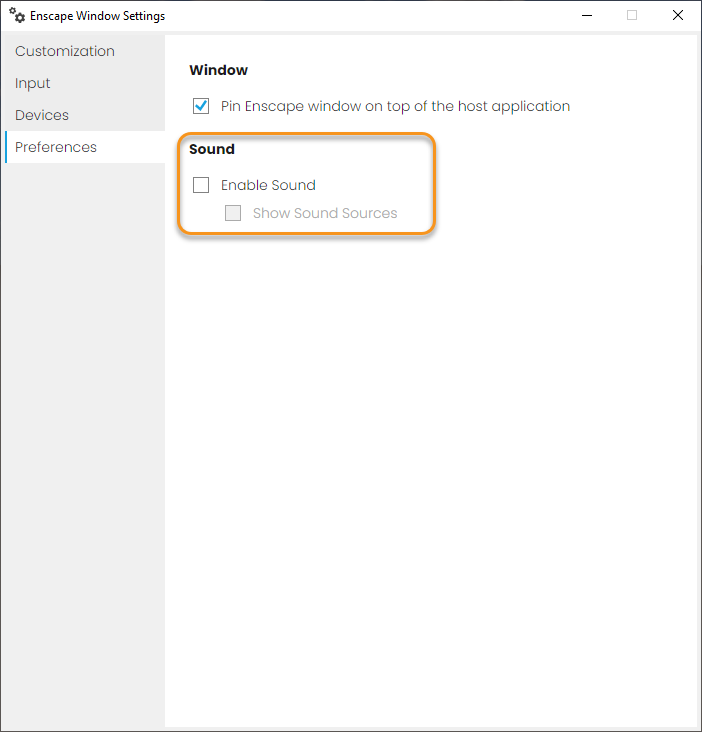

How to Enable Sound
Access Sound Source options in Enscape

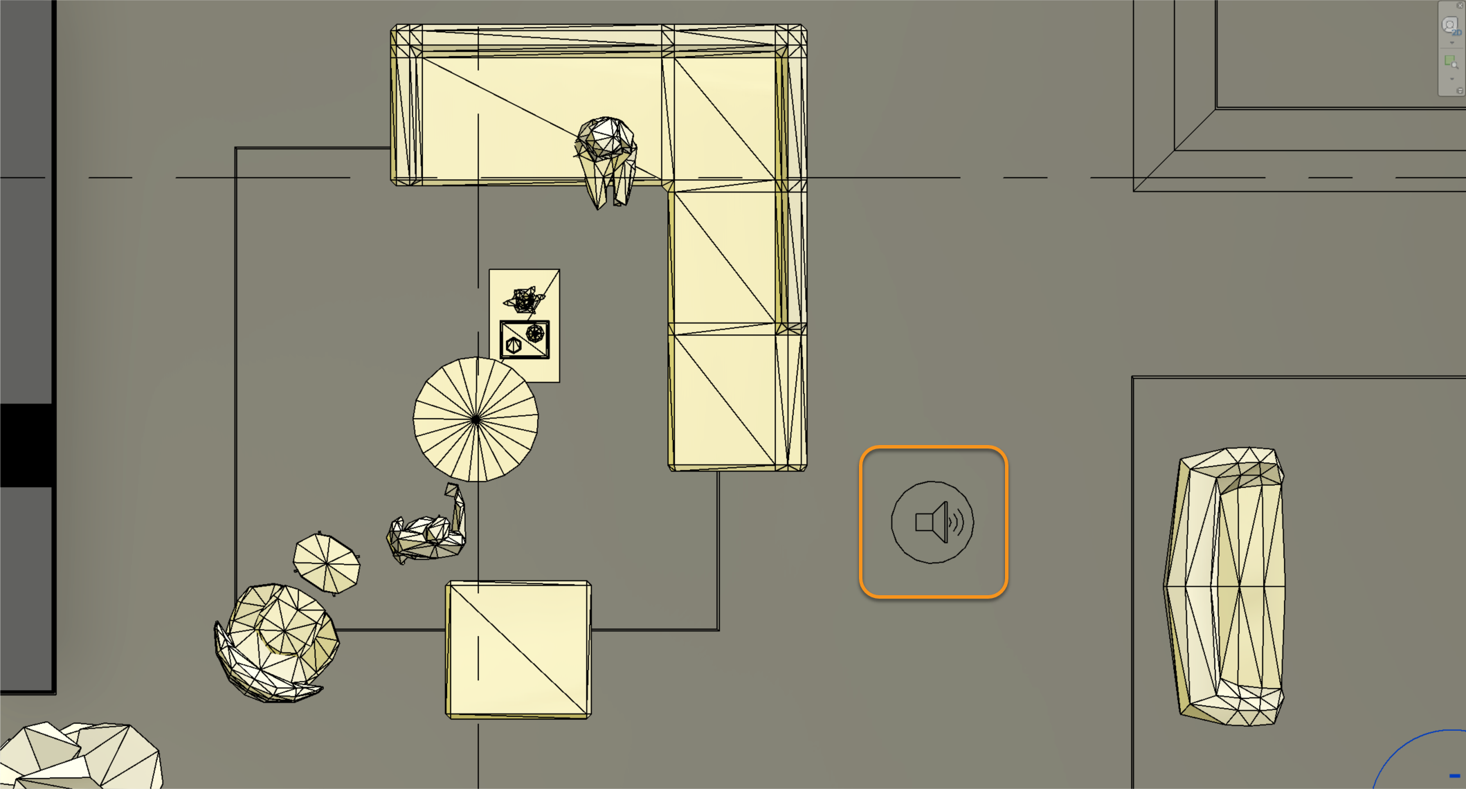

Top Tip!
If the sound icon is visible in Enscape when a Standalone Executable file is exported, the sound sources will be visible in the exported file. It is not possible to hide the sound sources from inside the Standalone Executable. Sound sources are never visible in exported screenshots, videos, Web Standalone files, or panoramas.
Show the sound source in the Enscape viewport
