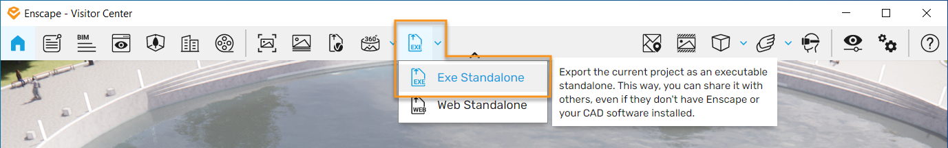

To export your Enscape model, first make sure that Enscape is running. If Enscape is not running, you won’t be able to export the file. You can simply click on the Export button, or click on the small arrow next to it and then choose the Exe Standalone option.
Standalone Export Button and drop down menu

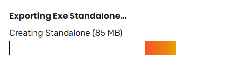

Once selected, a dialog will open asking you to specify the location you want to export the Exe Standalone to, and once the location has been chosen, the export begins and you will be shown an export process bar.

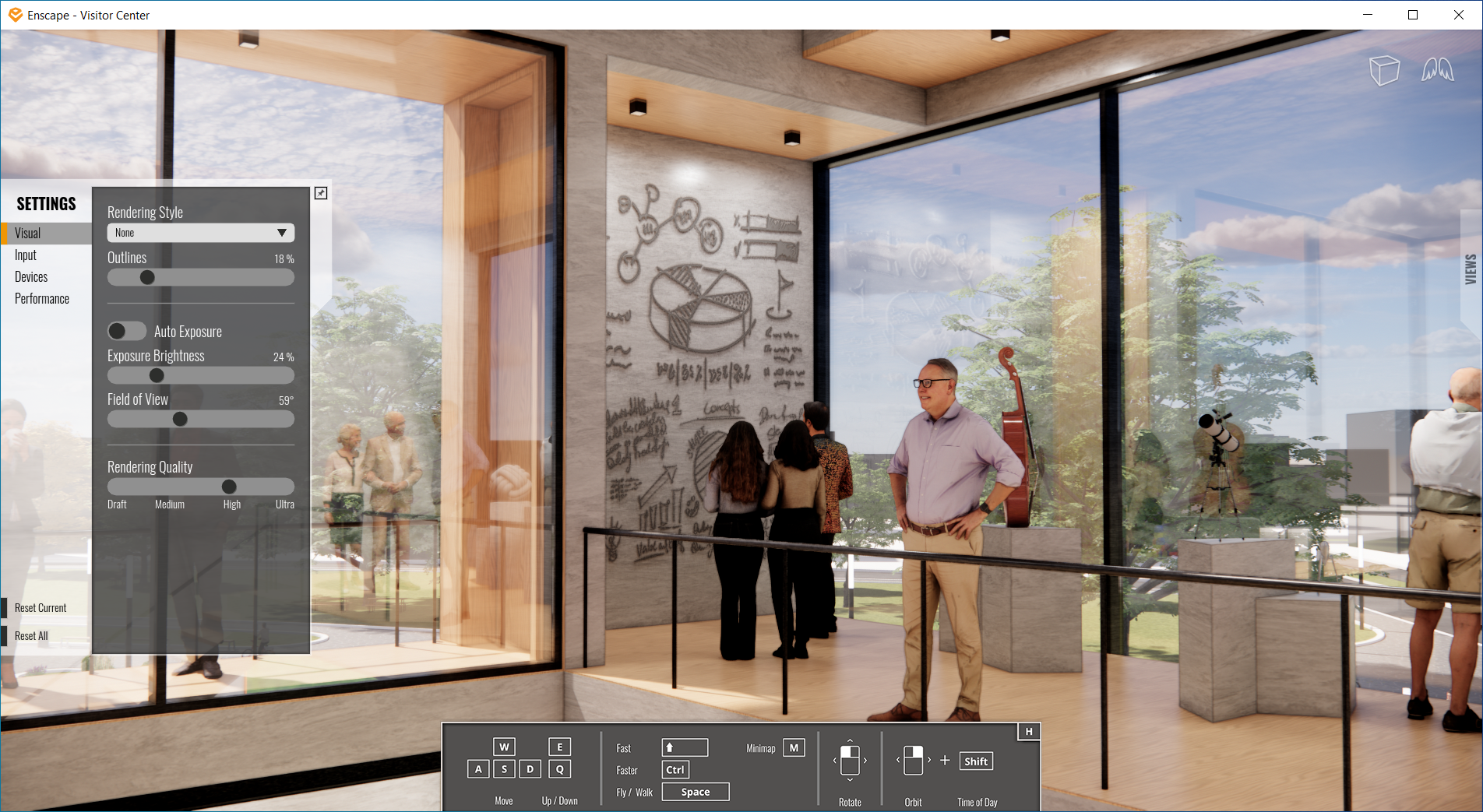

All of the settings, apart from Virtual Reality, that were active while exporting the Standalone Executable will be included in the export. Additionally, you have the opportunity to adjust several settings within the standalone, although these are not be saved. In the integrated Settings menu, you adjust settings in the categories: Visual, Input, Devices, and Performance.
The tab to open the Settings menu is located on the left side of the screen, about one third of the way down. When it is hidden, you will only see a translucent bar. Hover your pointer over the tab, and it will automatically expand. If you click the pin icon, the menu will stay open while you move around. Click the icon again, and the menu will close.
Standalone Export Settings Menu

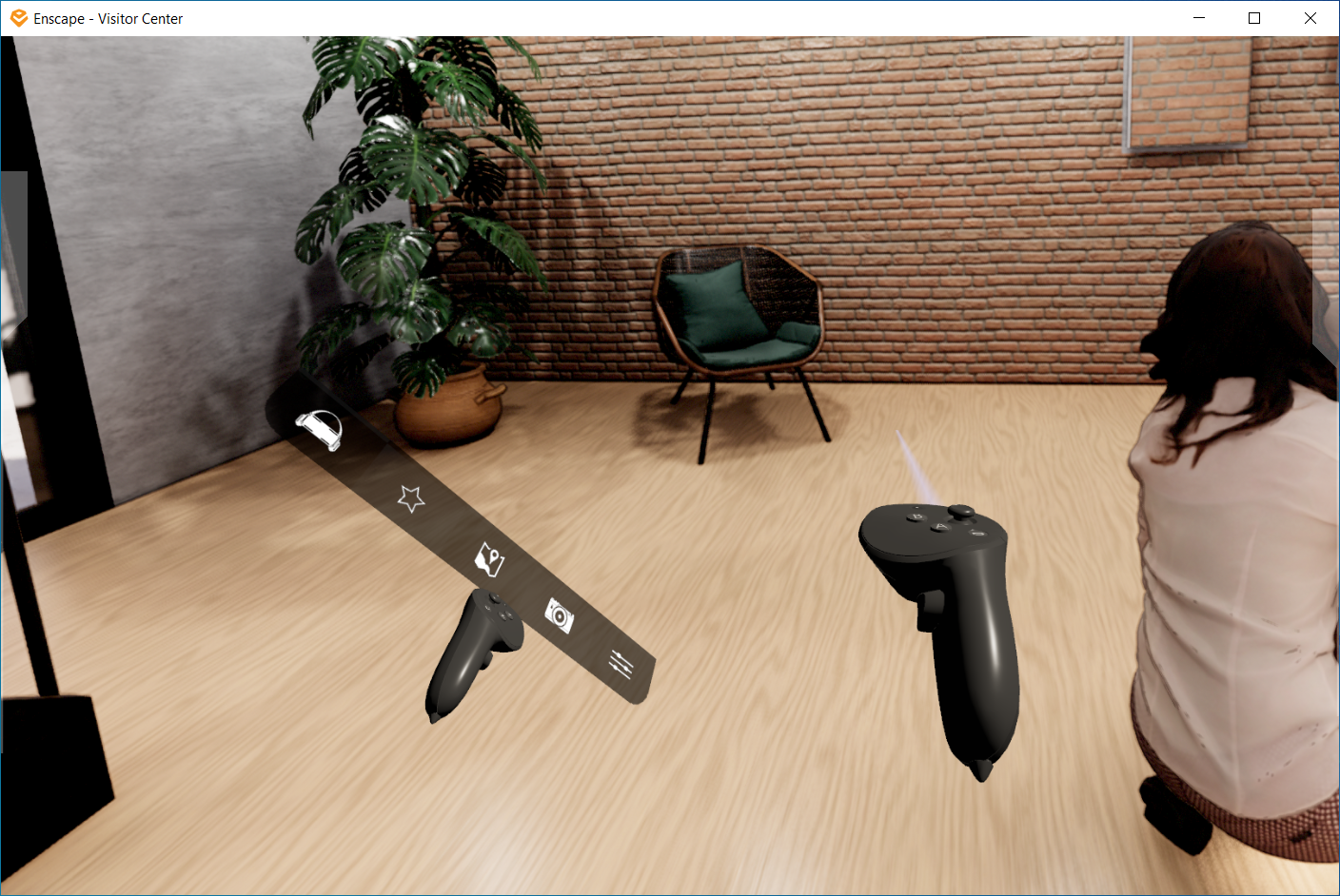

You can also enable and use virtual reality with the standalone. Simply enable Virtual Reality by selecting it in the Devices option in the integrated Settings menu. The machine that the model is being viewed on must fulfill Enscape’s virtual reality system requirements.
Enable the Standalone Export's Virtual Reality

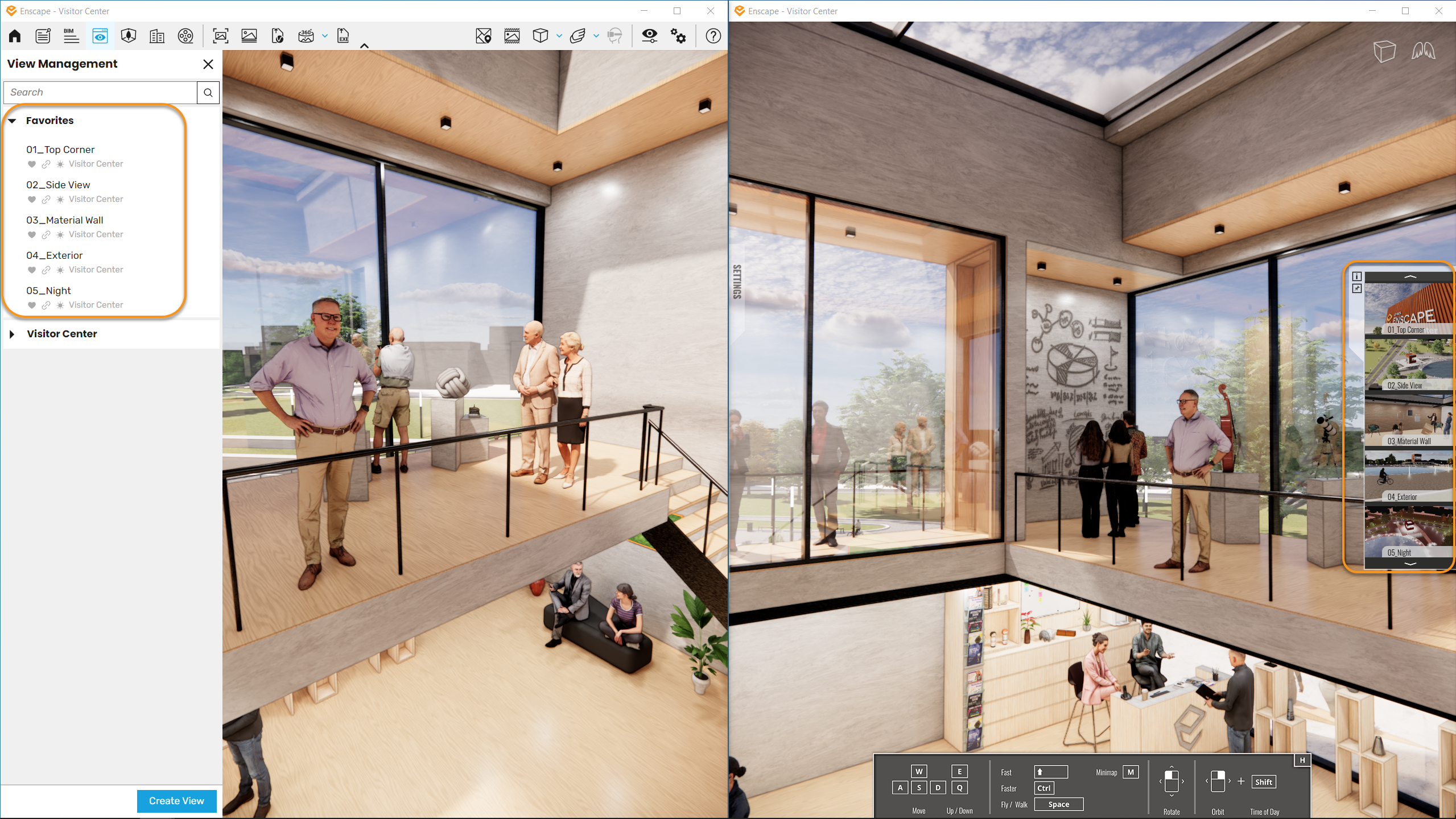

Any views you have marked as favorite in Enscape will be included in the Standalone Executable. On the right side of the Standalone Executable screen, you will find the Favorite Views menu. It can be opened in the same way as the Settings menu: by hovering your pointer over the translucent tab. Clicking on the thumbnail preview will smoothly transport you to that location in the model. A double click will transport you directly to the desired spot. The Views are exported with the Time of Day settings you defined for each View prior to export.
Marking Views as Favorite Views for use in the Standalone Export

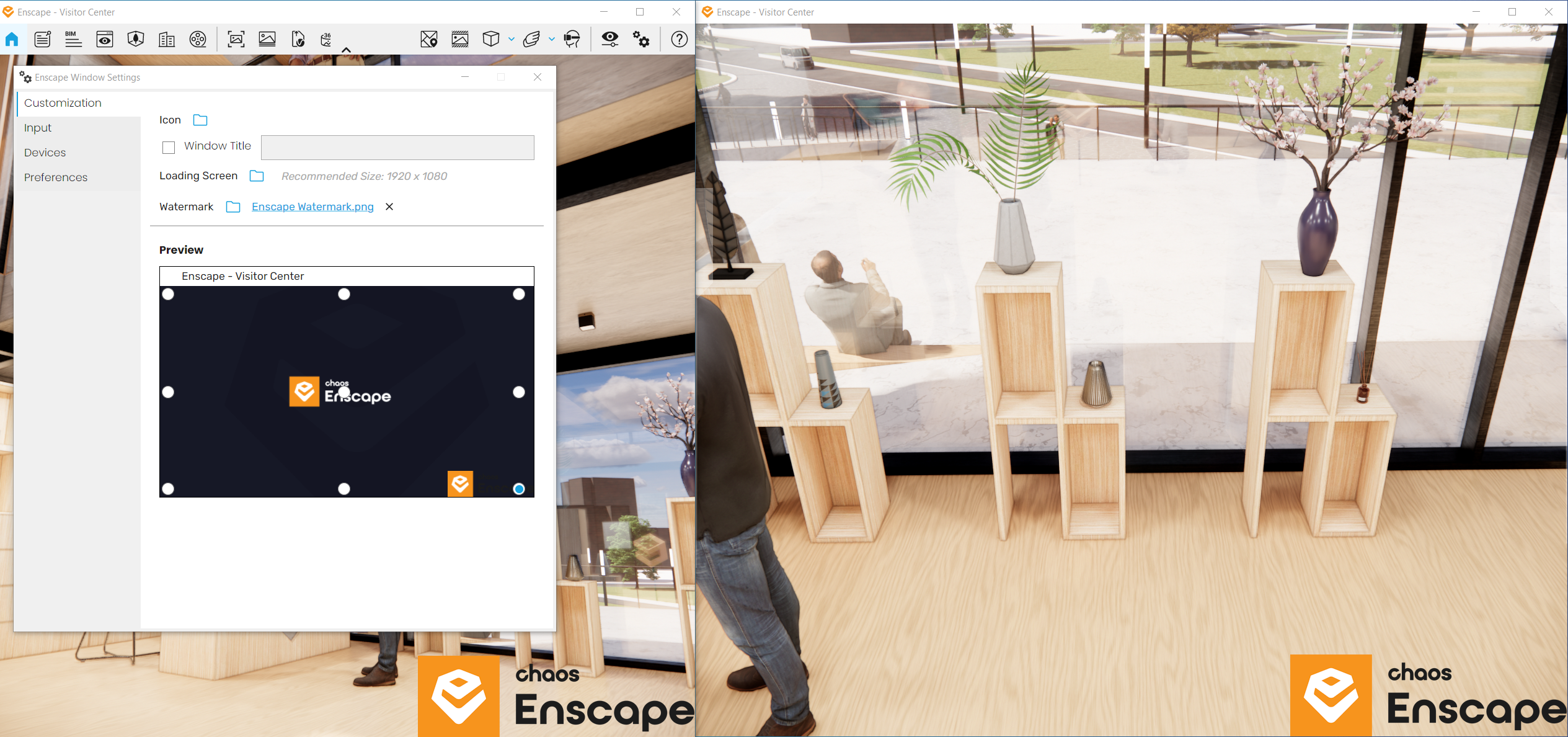

Any settings you have active prior to exporting are included in the .exe file when created – and this includes your Customization features which are accessed via the Renderer Window Settings dialog under the Customization tab. Here, you can define your own loading screen, watermark (and select a set position for it), window icon, and window title. Shown here, on the left, setting this up in Enscape itself, and to the right, how this is seen in the Standalone Executable file.
Customization Settings Options
