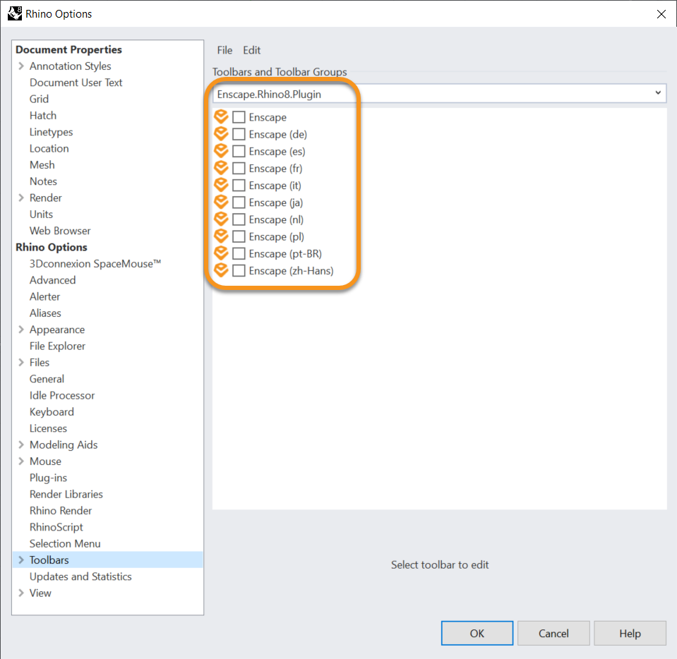

Click on the Enscape.Rhino8.Plugin.(the Rhino version number can vary depending on the version installed on your system) listed in the Toolbars and Toolbar Groups section of the Rhino Options window and then tick the Enscape and Enscape Capturing checkboxes, and the Enscape Toolbars will appear, either floating or docked. Click OK to close the Rhino Options window.
If the Enscape.Rhino8.Plugin is not listed by default, then you will have to load it manually.
To do this, click on the top level File option in the Rhino Options window, and navigate to the following location:
C:\Users\%username%\AppData\Roaming\McNeel\Rhinoceros\8.0\UI\Plug-ins
Highlight the Enscape.Rhino8.Plugin.rui file and click Open and the Enscape and Enscape Capturing checkboxes should then become available.

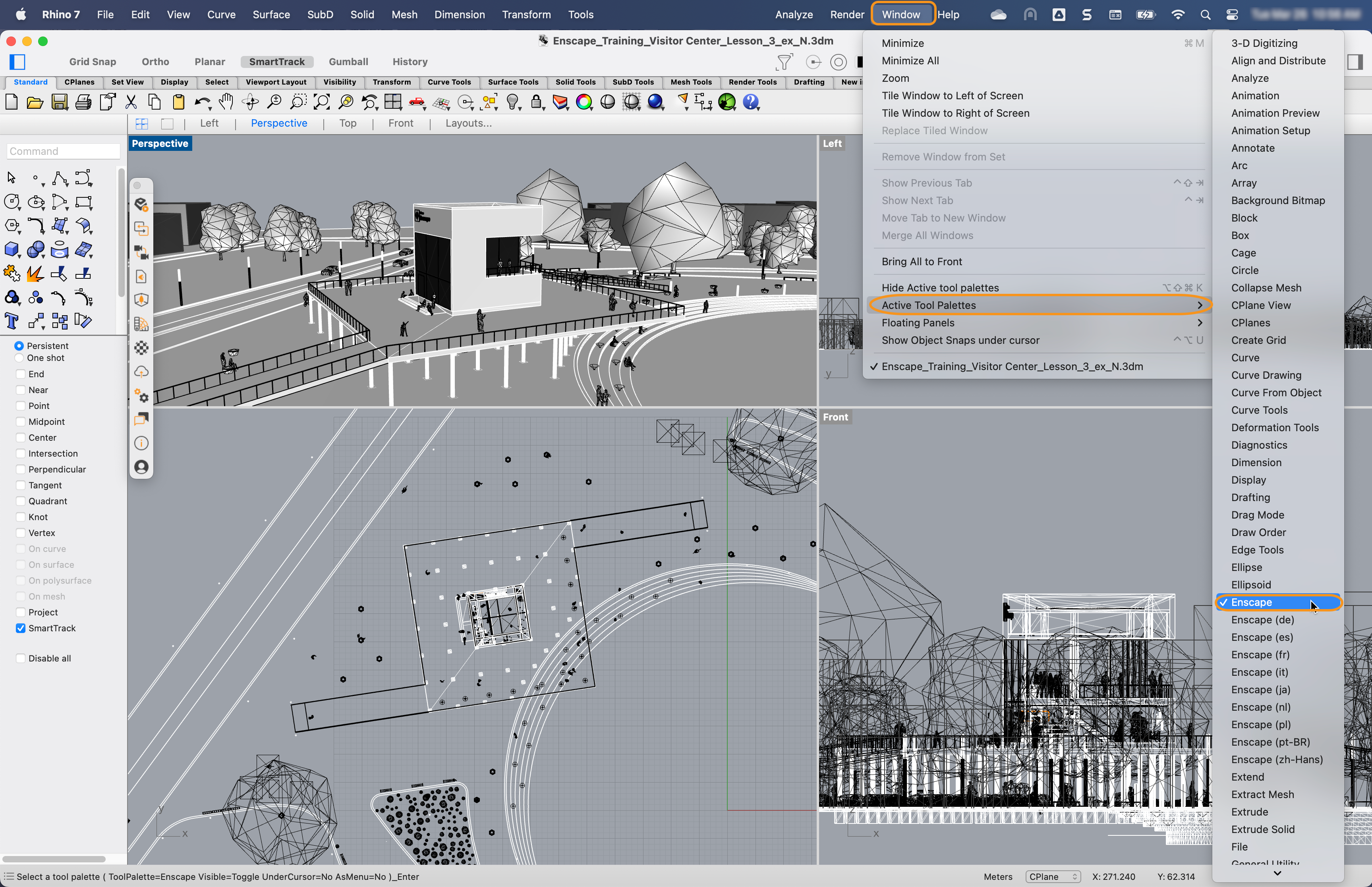

For macOS go to Window > Active Tool Palettes > Enscape option.
Once clicked, a floating Enscape window will appear.

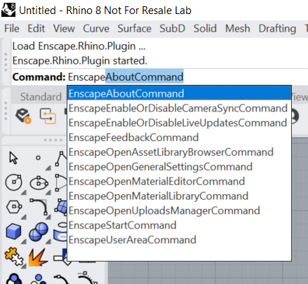

It is also worth noting that you can call most of the Enscape commands from the Rhino Command line. As all Enscape commands start with the word Enscape, typing ‘Enscape‘ will prompt Rhino to display all available commands.
