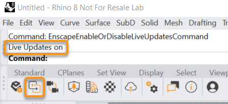

Pause Live Updates by clicking the Live Updates button:
To enable Live Updates again, simply click the button once more.
Note how the status of Live Updates is shown only in Rhino’s Command line area.
Pause and Resume Live Updates

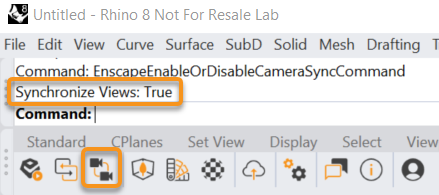

To activate Synchronize Views in Rhino, simply press the following button:
Click it again to disable it.
Notice the ‘state’ of this feature is only indicated in Rhino’s Command line.
Pause and Resume View Synchronization
