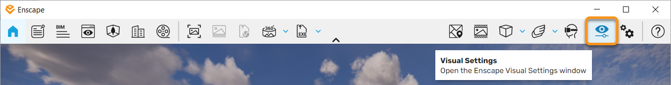

Make sure Enscape is running and click on the Visual Settings Window button.
The Visual Settings Window button

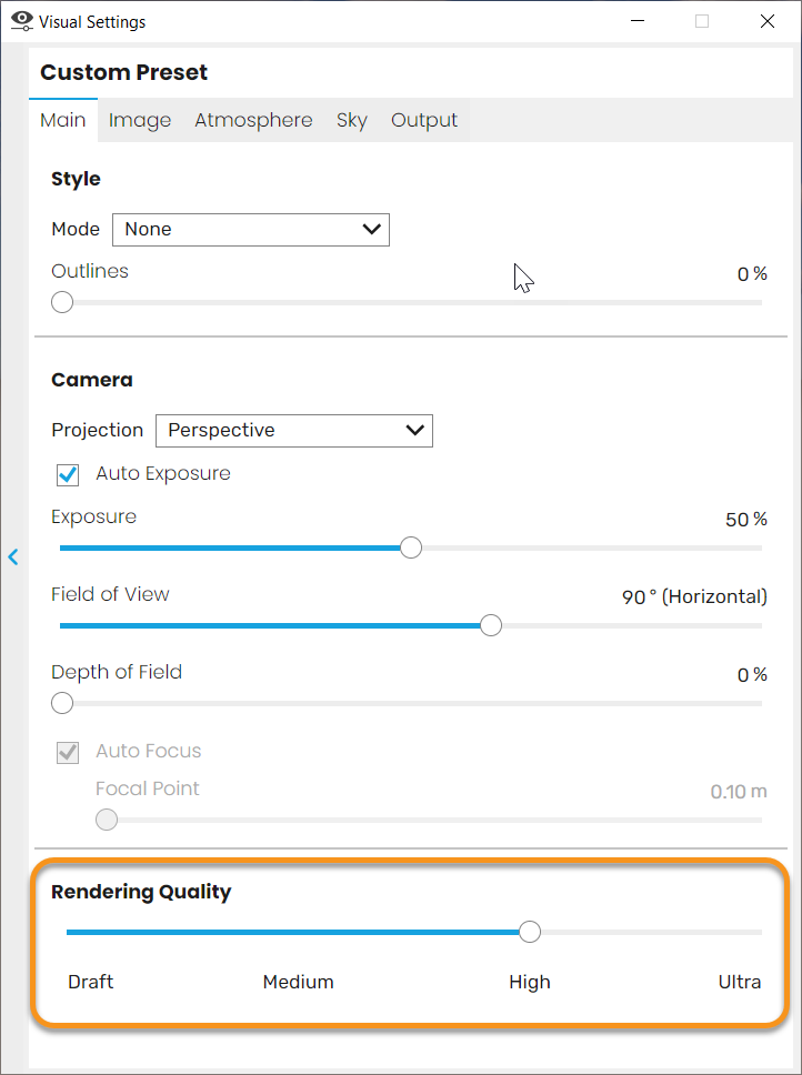

The Visual Settings Window will open on the Main tab by default and the Rendering Quality slider is to be found at the bottom of that dialog.
This slider determines how much effort Enscape should put into calculating the lighting in your scene. If you ever experience a low framerate or otherwise bad performance (perhaps because you’re running Enscape on a computer with low level hardware, or a very complex project) setting this slider to a lower setting will result in improved performance.
This setting directly impacts performance when Enscape is rendering in real-time. So what are the available settings, and what do they affect?
The Rendering Quality setting slider in the Enscape Visual Setting's window

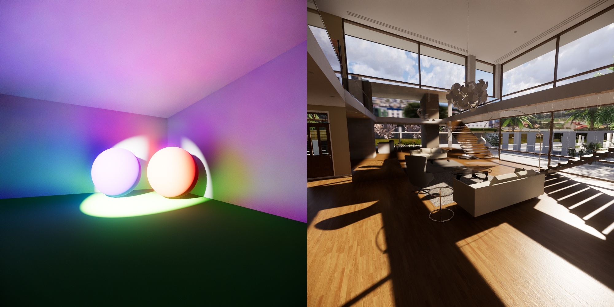

Medium
This is where Enscape begins to show off its impressive Path Tracing abilities. Light will now bump off the first surface it hits, taking information such as the surfaces color and intensity, eventually hitting a second surface and illuminating that too. Reflections will begin to display the actual environment – although Enscape still uses a complex algorithm to determine what objects to display and what to hide according to their size and complexity, as we want to maintain an acceptable frame-rate, after all.
Rendering Quality - Medium
High
Setting the Rendering Quality “High” will improve the aforementioned procedures – lighting is calculated with even more precision, and reflections will hide less objects than on “Medium” setting. Colored glass will also affect reflections, indirect lighting and fog. Fog looks more realistic when it is lit through complex geometry like vegetation or small holes.

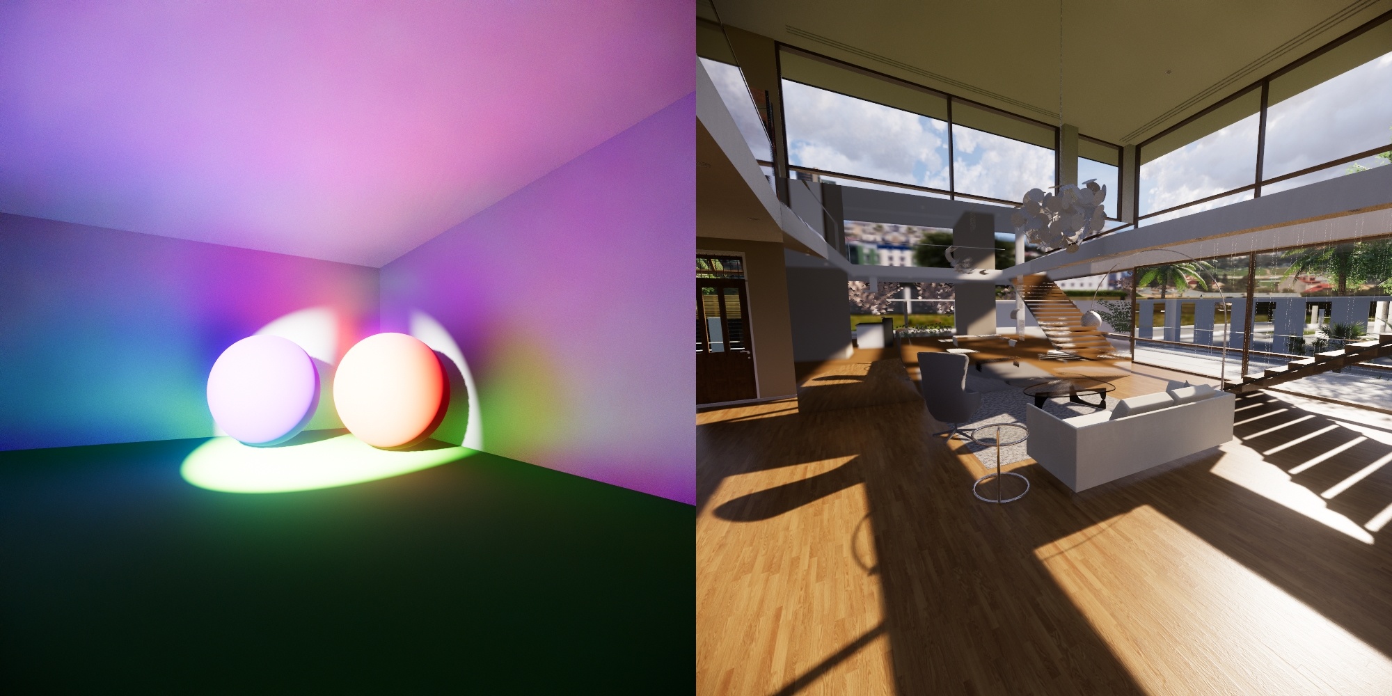

Ultra
Lastly, the “Ultra” setting. The difference to “High” isn’t all that drastic and is essentially but two bounces of light rays are being calculated instead of just one bounce, resulting in an even more realistic image – but, frankly, you’ll rarely see the difference to the “High” setting at all. Not in non-VR, that is!
Rendering Quality - Ultra

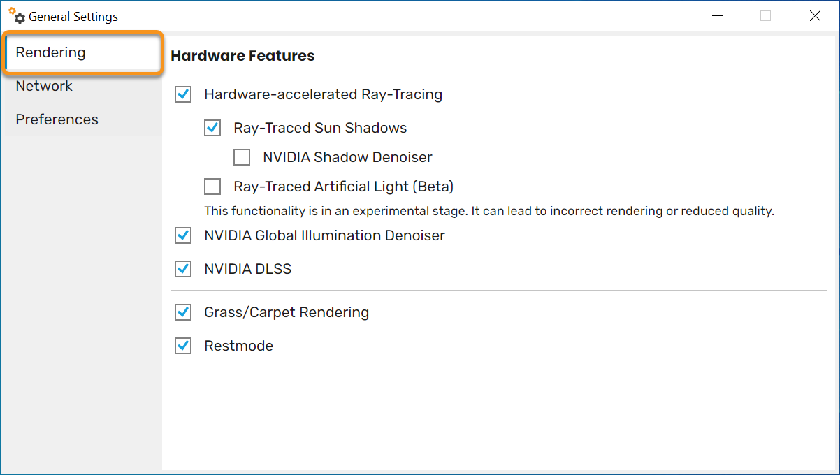

In addition to the Rendering Quality slider, there exists a set of further options that can affect the performance of your real-time rendering in Enscape. These are located in Enscape General Setting’s window’s Rendering tab and you can get more information about each of these settings here.

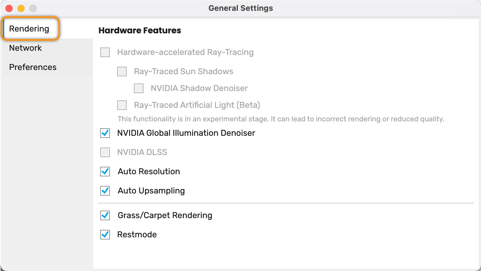

In addition to the Rendering Quality slider, there exists a set of further options that can affect the performance of your real-time rendering in Enscape. These are located in Enscape General Setting’s window’s Rendering tab.
NVIDIA Global Illumination Denoiser – Improves denoising of ray-traced diffuse and specular global illumination, powered by NVIDIA Real-Time Denoisers (NRD) SDK.
Auto Resolution – Dynamically reduces the resolution to ensure a smooth navigation and frame rate. If deactivated, the native window resolution will be used. This has no effect on rendered export.
Auto Upsampling – Upsampling is automatically activated in case the graphics card runs out of memory during capturing. Disable in case of quality degradation.
Grass/Carpet Rendering – When disabled, a slight performance increase can be had, but carpet and grass will geometry will not be rendered.
Restmode – When enabled, animations will stop a few seconds after you cease movement in the Enscape viewport.

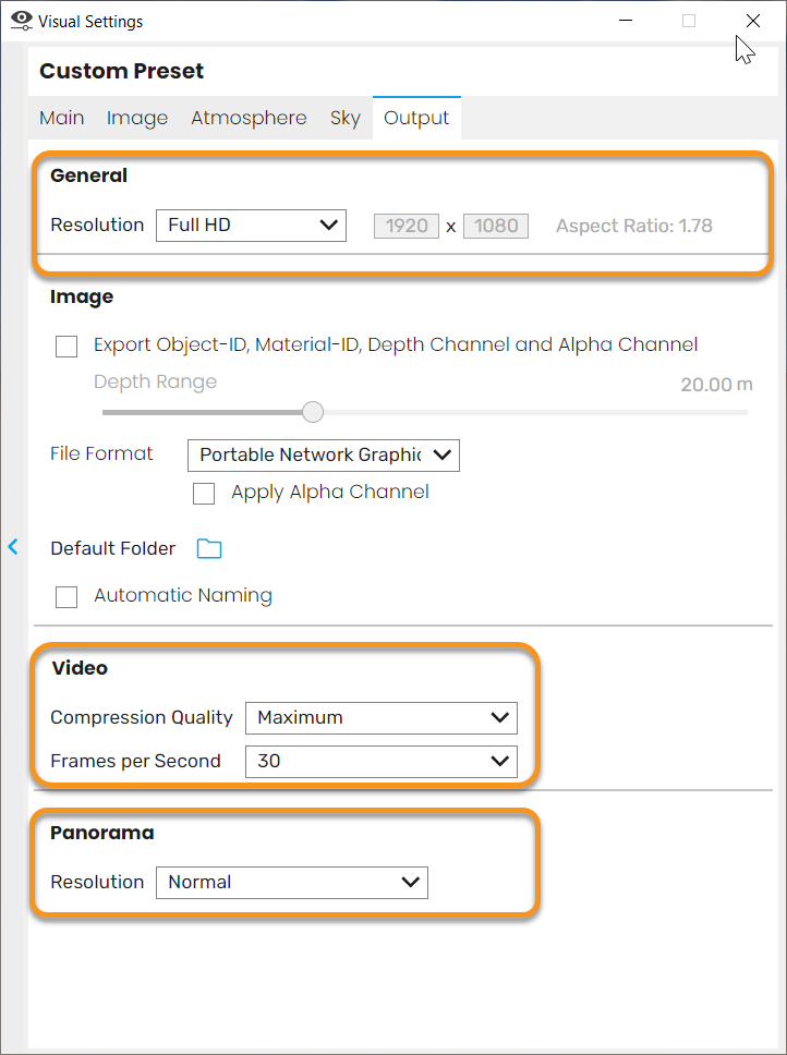

Render Export Quality Settings
Apart from the mentioned settings, there’s also a few settings affecting only the export quality of still image renderings, panoramas and video files, but not the real-time performance.
To be precise, you could probably call the majority of available settings “quality” settings, depending on your personal taste, but these four will improve the output quality while either increasing render time, or output size.
All of these options are located in Visual Settings window under the Output settings tab.
Resolution Select the export resolution for both, your still image renderings as well as your video exports using this dropdown menu. You can either choose your window resolution, any of the given presets, or a custom resolution up to 8192 x 8192 pixels. Please be aware that exporting renderings in such high resolutions can overwhelm your graphics card, in extreme cases causing Enscape to shut down.
Compr. Quality The compression quality slider determines the output bitrate of your video files. This setting does not affect render time, only the resulting video file size. So feel free to dial this setting up to Maximum. For even higher quality, dial it all to the right to ‘Losless’ – this, however, will result in a series of PNG images – easily hundreds of them – that you can then combine to a video file using third party software. Keep in mind not to save this video on your Desktop, or you’ll have a lot of files to move around!
FPS The FPS (Frames Per Second) setting decides how many images are generated per second of your video. Twice the amount of frames per second, for example 30 -> 60, will result in twice the time it takes to render the video, but will also make for a smoother playback.
Panorama Resolution The Panorama Resolution allows you to choose the quality of the panoramas generated using Enscape. You can choose a resolution from “Low” (2048 x 1024 pixels), “Normal” (4096 x 2048 pixels) to “High” (8192 x 4096 pixels).
The Rendering Export Quality settings
