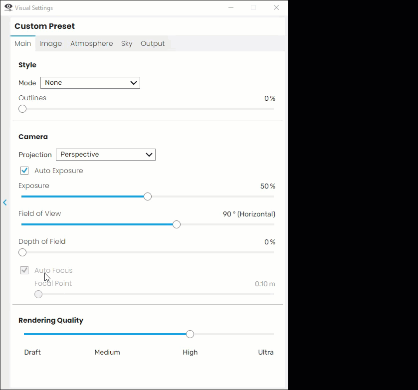

Then make any adjustments to the Visual Settings, which will automatically be applied and saved to that Settings Preset. Here, we increase the Outlines value.

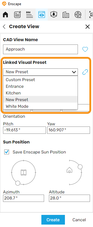

Once you have created your View, make sure you are in the Edit View panel and click the Linked Visual Preset drop-down menu.
Any Settings Presets you have created will be available for selection there.
Linked Visual Preset dropdown menu

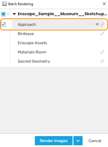

Rendering a View that contains a link to a Settings Preset is then as simple as either selecting it in View Management and clicking the Screenshot button for a single image, or by marking it in the Batch Rendering list.
Batch Rendering list dialog with selected View that contains the linked Setting Preset
Potentially, a mixture of linked and non-linked Views can be batch rendered, with non-linked Views using the current Visual Settings and the linked Named Views using the linked Setting Preset.
