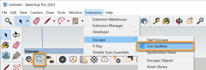

Here you can see the Live Updates button and the menu option to enable / disable this. Notice the button has a light blue background applied to indicate it is enabled.

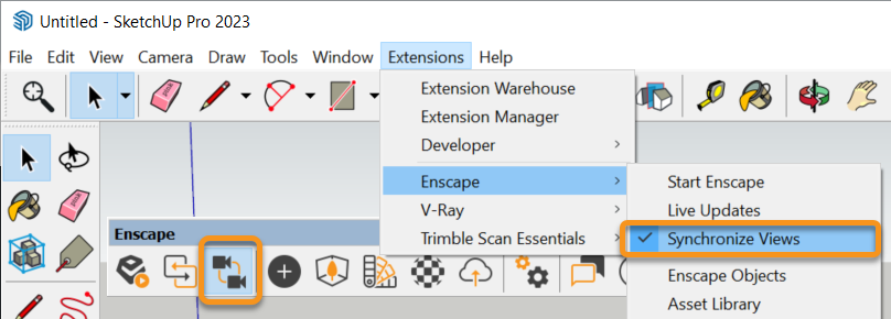

To synchronize the view of SketchUp with Enscape, simply click the following Synchronize Views button or menu optionл
Notice that the button’s background is highlighted with blue when enabled.
