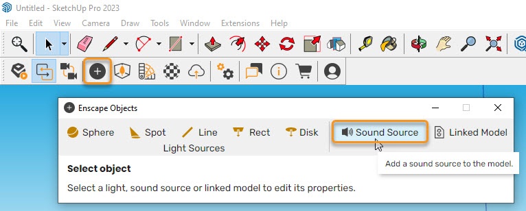

To place a sound source in SketchUp, open the Enscape Objects window and click “Sound source”.
Sound Source option in Sketchup

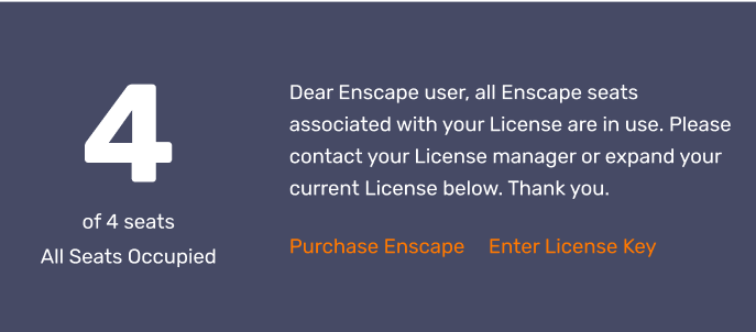

If the Enscape Objects dialog appears with a notification about the license being invalid, or that ‘All Seats are Occupied’, then please refer to this article to resolve this.
Notification that no seats are available

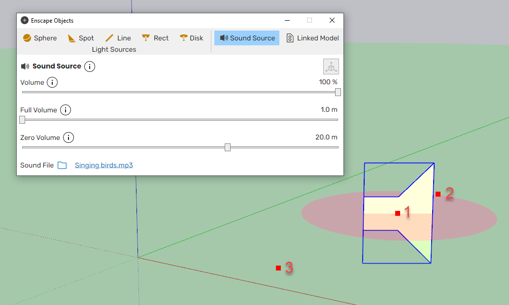

When the sound source is placed, you will be able to adjust the Volume, Full Volume and Zero Volume settings, and change your sound file. The Full Volume setting defines the distance from the sound source (in meters) that the sound is played at its full volume. Outside this radius, the sound will fade until it reaches the distance defined in the Zero Volume setting, at which distance the sound will stop playing altogether.
You can adjust the Full Volume and Zero Volume settings in the Enscape Objects window, or by clicking and dragging the red squares marked 2 and 3 above respectively. To adjust the placement of the sound source, click the red square marked 1. When the Full and Zero Volume values are the same, the sound starts or stops immediately when you enter or exit the radius of the circle.
Adjusting the settings for the sound source

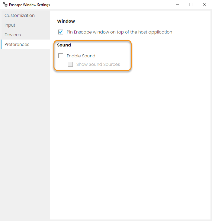

How to Enable Sound

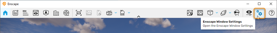

You will need to have Enscape running to access the options to enable / disable the sound source, as well as to hide or show the sound source in the Enscape viewport.
If the sound icon is visible in Enscape when a Standalone Executable file is exported, the sound sources will be visible in the exported file. It is not possible to hide the sound sources from inside the Standalone Executable. Sound sources are never visible in exported screenshots, videos, Web Standalone files, or panoramas.
Access Sound Source options in Enscape
