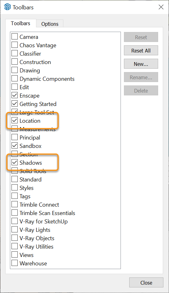

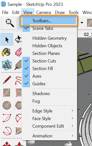

It’s recommended that you enable SketchUp’s native toolbars for Shadows and Location via SketchUp’s View menu.
Select Toolbars Option from SketchUp View Menu
Once the Shadows and Location Toolbars are enabled in SketchUp, you will see two Toolbars shown here; the first image is the Shadow Toolbar.
The Shadow Toolbar allows you to alter the Time of Year and the Time of Day in your project by adjusting the two sliders.
SketchUp Shadows Toolbar

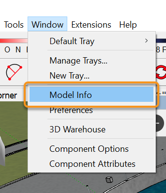

To adjust the Geolocation, you can either access the settings via the Sketchup File -> Geo-location -> Add Location menu option, or via the SketchUp Window -> Model Info menu option.
SketchUp Add Location Option
SketchUp Model Info

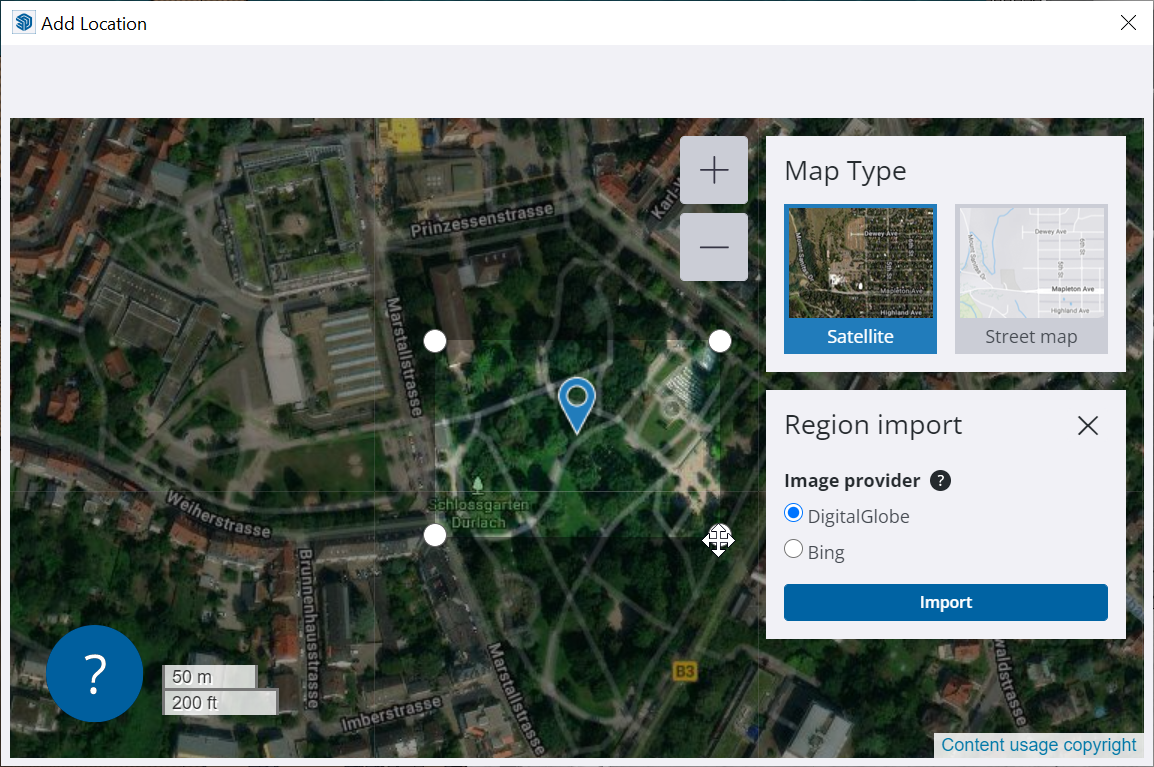

This will open the SketchUp Model window, where you can click on Add Location (which is the same as selecting Add Location from the Sketchup File menu option described above), or Set Manual Location. In the Add Location window, you can either use the search function to enter an address or coordinates, or you can drag and zoom the map to the location you require. Once the general location has been decided upon, you can then click on Select Region which will display a bounding box of the area to use.
SketchUp Model Info & Add Location Windows

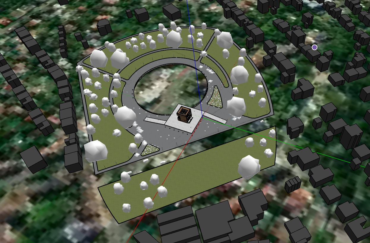

Once you are happy with setting the area you want to use, click the Import button at top right of the Add Location window which will close the Add Location window. This will then display the specified area as the location for your project.
Import Location
GeoLocation Applied to Project

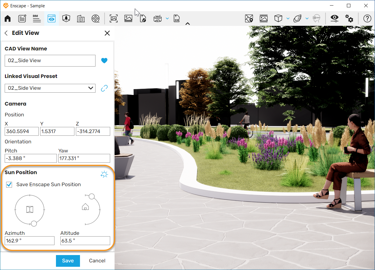

While you are adjusting the time of day in Enscape. You can save the Enscape Sun Position by going into the View Management tab – Select the view you would like to save the sun position of.
Manage Views
There will be a section for Sun Position, then click the box to open the Enscape Sun Position settings.
Sun Position Section
You will now have 2 options to control the Sun Position:
Azimuth –  Rotation of the sun around the building.
Altitude –  Rotation above and below the horizon line.
By adjusting these sliders you will see the time the time of day change to the desired result.
*If you need to undo the changes at anytime, click the undo button.
Once you are happy with the adjustments, click the Save Button at the bottom of the window.
Azimuth and Altitude Settings
Now each time you go back to this view it the sun settings will stay the same.
*You can see if a view has the sun settings changed by the little sun icon under the views name.
