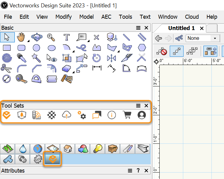

Enable the Enscape tool set
Starting Enscape in Vectorworks
Once enabled, you can open the Enscape tool set to access the Start button. Open the Enscape tool set by clicking on the Enscape tab.
Location of Enscape Tool Set in Vectorworks
