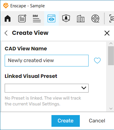

Once you have clicked the Create View button, you will be prompted to give that View a CAD View Name. Once you have named your view, you can also mark it as a Favorite View by clicking the heart symbol (so it turns from a blue outline to a solid blue color), and then you can click Create for that View to be listed in the View Management list under the respective projects category.
Name the View

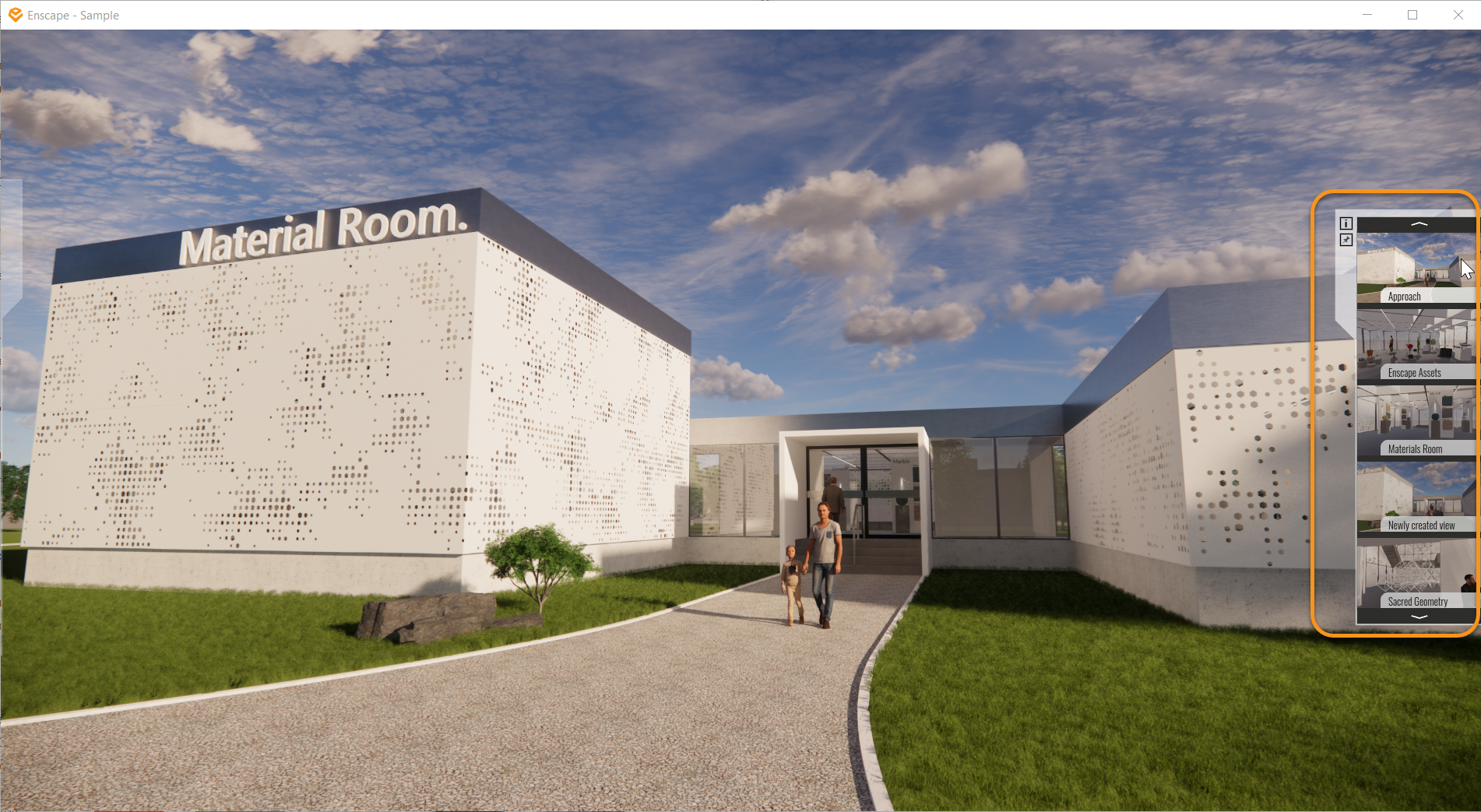

All views that you mark as a favorite will become available in the VR Presentation Mode, as well as in the right side pop-out menu in the Enscape Standalone file.
Enscape Standalone Executable files are Windows based only.
Favorite Views listed in an Enscape Standalone Executable file

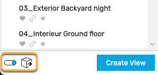

As mentioned at the top of this article, Enscape now provides a Geometry Update Setting option for Vectorworks users. This means that when disabled, geometry will not be reloaded each time you switch between Views.
Geometry Update Setting in the Upload Management dialog
