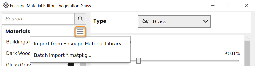

Two other functions that are available in the Enscape Material Editor are the menu button at the top which allows you to either Batch Import *.mattpkg files, or import materials from the Enscape Material Library.
Import options
You can also set the location where materials will be stored (such as a network drive)  via the ‘gear / cog’ symbol at the extreme bottom left of the Material Editor dialog and this is also covered in the Material Library article.
Materials' Location
Important
Before importing any materials, you should decide whether the project will be shared with another user for collaborative purposes. If this is the case, a storage location where all users working on a project will have access to. Therefore, you should pay attention to the ‘gear’ icon that can be found at the bottom left corner of the dialog in both the Material Library, and the Material Editor. If you do not adjust the storage location then when a project file is opened by another user, that user will not be able to access the materials assigned in the project due to the default storage location being assigned locally by default. This means that the materials assigned in the project will need to be manually reimported from the Material Library and reassigned.
The following shows how to import a PBR material from the Enscape Material Library into Vectorworks.

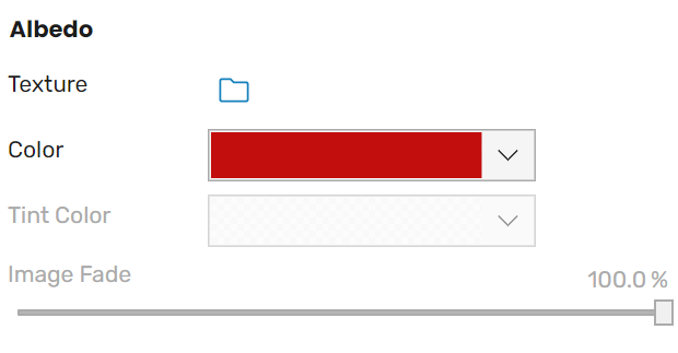

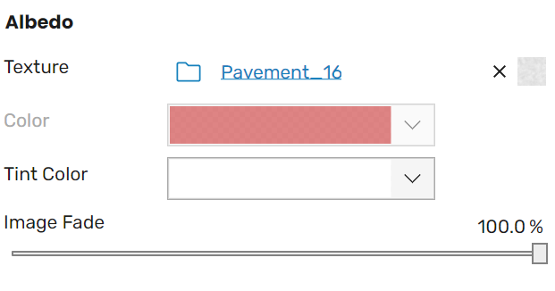

Albedo
The Albedo area controls the basic color of the surface you’re designing. You can either select a color, or choose a texture by clicking the blue folder  symbol. If choosing a texture, you’ll also receive a “Tint Color” menu, allowing you to easily change the color of the texture used. Control the amount of influence on your texture using the “Image Fade” slider. Of course, Enscape will use any UV information (texture placement) it gets from Vectorworks.
The Albedo area with no texture applied
Albedo area with texture applied
Albedo Texture on Sphere

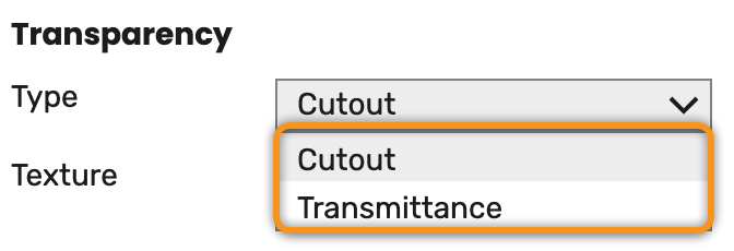

Transparency
The Transparency area lets you control the opacity of your model, or, in other words, the amount of light that can travel through the surface, allowing you to see what’s behind it.
Transparency Options
  • Texture
    The Texture parameter allows you to control the transparency using a 2D image, a map. It refers to the Opacity value, so a black area (which equals zero) on the image used will result in a perfectly transparent portion of the surface, while a white area will appear perfectly opaque. Grey areas will appear partially transparent, such as glass. If you load a colored image, Enscape will automatically convert it to black and white, so you don’t have to worry about that.

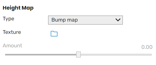

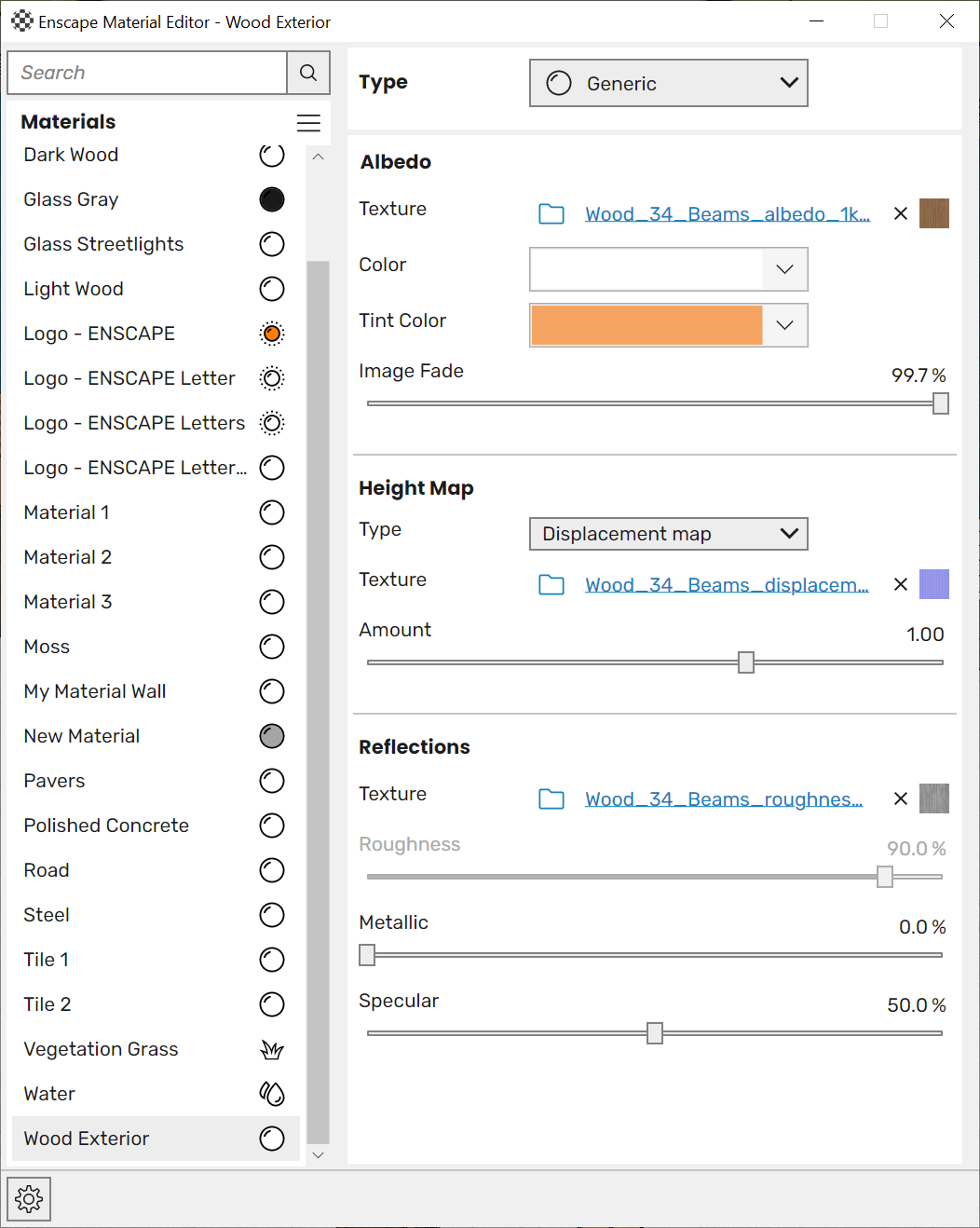

Height Maps
The Height option in the Enscape Material Editor allows you to utilize so called Bump, Normal, or Displacement maps in order to simulate bumps, wrinkles and dents and the lighting of these.
Bump maps can be any black and white 2D images. They tell Enscape to interpret a surface as protruding (bright parts of the texture) or recessed (dark parts of the texture).
Normal map are a type of Bump map that require an image with RGB values. These RGB components correspond to the X, Y, and Z coordinates, respectively.
Applying a Normal map
Displacement maps are an enhancement of the bump mapping or normal mapping techniques applied to textures. Normally an Occlusion Map is the type of image you will use for Displacement maps. The actual technique employed in Enscape is called quadtree parallax displacement mapping for optimum performance. It’s worth noting that Displacement maps are incompatible with transparent materials so the entire “Transparency” section becomes unavailable where a displacement map has been applied (including mask textures). Furthermore, the brightness of Displacement maps cannot be further adjusted or inverted when editing the texture inside the Enscape Material Editor itself.
Height maps are incredibly valuable for realism in your images and this cannot be overstated enough!
Height maps can make for incredible surface detail and noise, without actually affecting or adding more geometry. You can use this feature for noise on concrete surfaces, wood, tiling, or even full reliefs! This can go a long way in convincing the viewer that they are looking at a realistic picture.
Textures that are available online, either paid for or free, will generally have a Normal, Bump / Height, Occlusion map included or available additionally to the basic Color texture.
It is also worth noting that normal based self-shadowing of material surfaces implemented. This feature further improves the depth perception of materials, especially with displacement maps. It’s active for sun light only when the Rendering Quality level is set to “High”. On Rendering Quality level “Ultra” artificial lights will also cast normal based shadows.
Applying a Displacement map
As powerful as this feature is, it’s very easy to setup. Just select an image file using the blue folder button. A Bump map doesn’t even have to be black & white, as Enscape will take care of that for you.
Normal Maps must have an RGB value in them.
As already mentioned, Displacement maps would be best served with an occlusion map if available.
You can switch between using a Bump, Normal, and Displacement map via the Type drop down option.
Select the Intensity (Bump and Displacement) or Amount (Normal) of the effect, using the respectively named slider. Negative values for bump maps. will invert the effect, causing dark areas to stick out and bright areas to be pushed in.
Displacement Maps will only adjust the amount, whether negative or positive values, in the same single direction from the minimum height value.
The Bump Map Settings options
Pro Tip
When using a Bump map, if there’s already an Albedo texture applied to your material, you can just click “Use Albedo“. Enscape will then assign the color texture to the bump value. This offers a uniquely streamlined way to set up existing projects for Enscape: If you want to apply a bump effect to, e.g. an existing wood material, simply select the material in Enscape Material Editor. Click “Use Albedo” in the Bump area (and, if desired, in the Reflections area as well), select the right intensity with the “Amount” slider – Done!

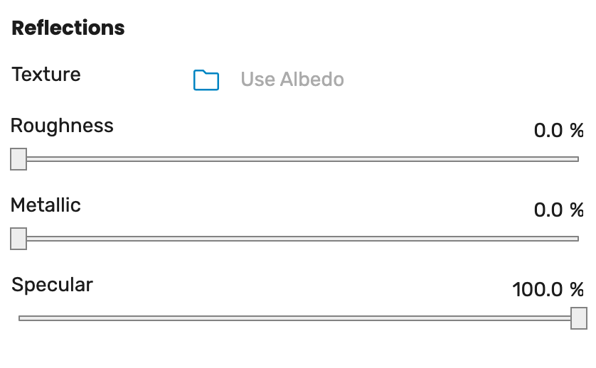

Reflections
This area is all about the microscopic roughness of your material, determining how much of the environment you’ll see reflected in its surface.
Roughness – The smoother the material (Roughness -> 0%), the more it will reflect it’s environment. The rougher the material is, the more it will diffuse incoming light.
Texture – Again, you can also use 2D Images as a ‘Roughness Map’ to control the roughness value per location on your surface.
Metallic – The Metallic-slider tells Enscape to treat the surface either as a non-metallic (e.g. plastic, ceramic..) reflective surface, or as a metallic one.
Let’s say metallic surfaces behave more like a mirror, reflecting a clear image of their surrounding, while non-metallic surfaces show more of their actual surface, reflecting the environment rather vaguely.
Specular – This value controls the amount by which light is being reflected when hitting a non-metallic surface at a steep angle, as opposed to light that’s hitting it rather from the side.
If you’re not too familiar with this setting, it’s best to leave it around 50% for realistic results.
The Reflection settings area
Sphere with texture applied as a Roughness Map

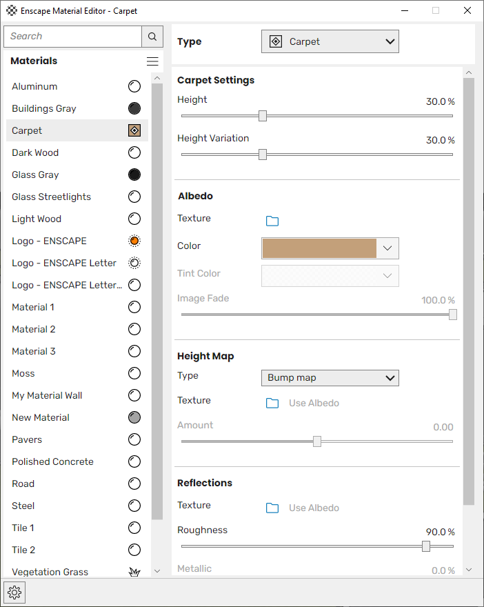

Carpet
The Carpet material acts in the same way as the Grass Material, in that it can be applied to a horizontal surface only, and the Height and Height Variation are controlled in the Enscape Material Editor.
The minimum surface area for the sprites of the Grass material to show in Enscape is 10cm x 12.5cm. Any surface that has this Material Type applied and is smaller than these dimensions will result in the sprites not being visible in Enscape.
Carpet material applied in the Albedo slot.
The Height and Height Variation Settings title is amended with Carpet when Carpet is selected as the Type in the Material Editor.
Carpet Material Settings in the Material Editor
Carpet selected as the Type in the Enscape Material Editor

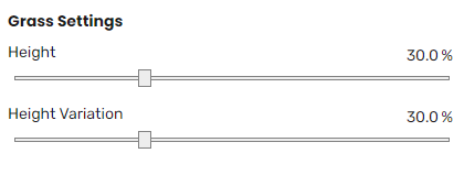

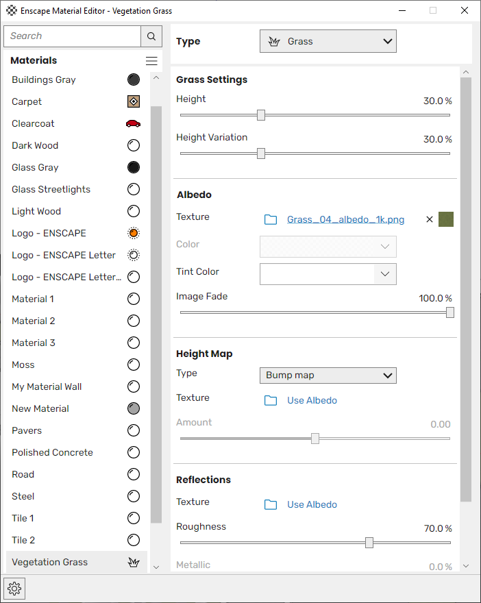

Grass
The Grass type material, as seen in the material editor, looks almost the same as the Generic type. While it’s lacking the Transparency part, it instead features a Grass Settings area. Apart from the Albedo area, which you can use to color your grass (also using a texture), the Height– and Reflections parts are only useful if you plan to toggle the Grass Rendering setting on and off (this can be found in the Enscape General Settings -> Performance -> Grass/Carpet Rendering option).
The minimum surface area for the sprites of the Grass material to show in Enscape is 12.2cm x 12.3cm. Any surface that has this Material Type applied and is smaller than these dimensions will result in the sprites not being visible in Enscape.
Grass Settings
'Grass' selected as material type
Height – The Height slider will stretch the sprites being used as grass blades, making them appear larger, making for higher grass.
Changing the grass height
Height Variation – The Height Variation slider adds a random factor to the grass height. This makes for a wilder looking, ragged grass.
Randomizing the grass blades

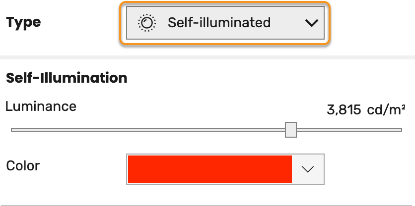

Self-illuminated
The Self-illuminated type material, when selected, tells Enscape to literally handle your material as if glowing, and emitting actual light. You can choose a brightness between 1 and 100000 candela per square meter (cd/m²), as well as the color of the light.
With Enscape 4.8 ReSTIR was introduced for Ray-Traced Artificial Light. This improves the illumination via Self-illuminated materials drastically. To use ReSTIR, Ray-Traced Artificial Light must be activated in the General Settings.
Self-illuminated Type
Self Illumination Material Type

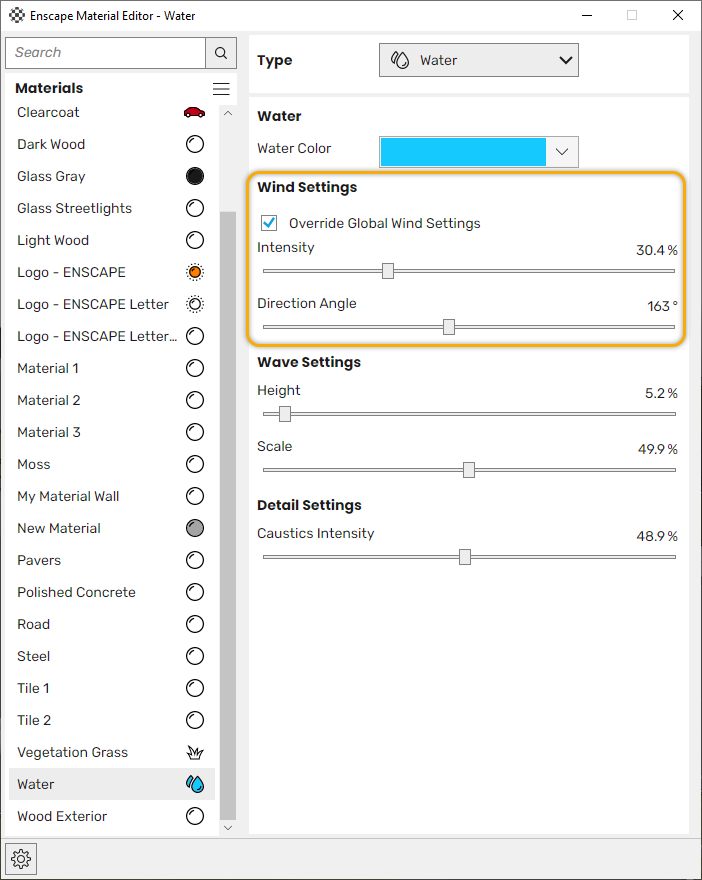

Wind Settings
Control the water movement. Change the speed and the direction your water is flowing to simulate e.g. a river.
This can be set using the global Wind Settings to be found in the Visual Setting-> Atmosphere tab, the same as for the Grass material. These global settings can be overridden for Water however, and this override is available in the Material Editor when Water is selected as material Type.
  • Intensity
    Control the speed in which the water is flowing.
  • Direction Angle
    Control the overall direction water is moving in.
Override Wind Settings option
Pro Tip
Don’t be surprised, water in Enscape will stop moving as soon as you stand still and stop moving the camera. This is intentional, and will not happen in video exports or VR. You can have the water animate all the time by unchecking the Restmode option in the General Settings dialog under the Rendering option.

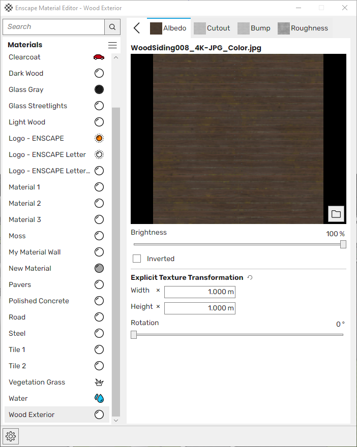

Texture Editor
You can use up to four textures at a time per Enscape material. Textures are being used to control Color, Visibility, Surface Detail and Roughness of a material.
By clicking any of the texture symbols at the top of the material editor, or any of the blue and underlined image file names next to “Texture”, you’ll enter the actual texture editor interface.
Here you can
  • Choose the image file for your texture
  • Change the brightness
  • Invert the colors of your image
  • Apply explicit texture transformations
The Texture Editor interface is the same for any texture type. It’s meant to allow for simple image editing operations without having to leave the material editor.
All texture slots used
The Texture Editor

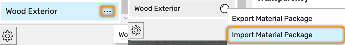

To import a single material hover the mouse over any material listed on the left hand side of the Material Editor dialog and the material Type symbol will change to 3 dots.
Clicking on the 3 dots will reveal the menu options Export Material Package and Import Material Package. In order to import an existing material, click on Import Material Package which will allow you to navigate to the location of the *.matpkg file you wish to import.
Material Import and Export options

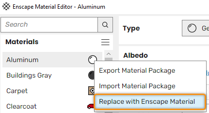

To replace a material hover the mouse over any material listed on the left hand side of the Material Editor dialog and the material Type symbol will change to a meatball menu (3 horizontal dots).
Clicking on the meatball menu will reveal 3 menu options, one being Replace with Enscape Material.
Once you click on Replace with Enscape Material the Enscape Material Library will open. The selected material will be previewed on the surface that has material to be replaced. With a material selected the Replace button will be available.
To confirm and replace the existing material with the newly selected material, click the Replace button and the material will be imported and updated.
Replace an existing material
The process is illustrated in the video.
Naming Keywords
Before introducing the Material Editor, Enscape would let you decide material properties using keywords you simply had to include in the material name. This framework is still included in the Enscape feature set, and can be used freely alongside the material editor for greater comfort.
These are the keywords to include in the Material name to tell Enscape how to display it more realistically.
Keywords and their effects
KEYWORD
EXPLANATION
Water, Ocean, River
Draws the material as a water surface.
Vegetation, Foliage, Leaf
Adds translucency to thin surfaces (single face).
Emissive
Emissive material based on the material color.
Grass, Tall Grass, Short Grass, Wild Grass
Realistic grass material based on the underlying surface color.
Long Carpet, Short Carpet
Carpet like material, either long or short, that take on the underlying color or texture file.
Those keywords change the material parameters without changing their color. The color is still defined by the texture. The default roughness is 1.0.
