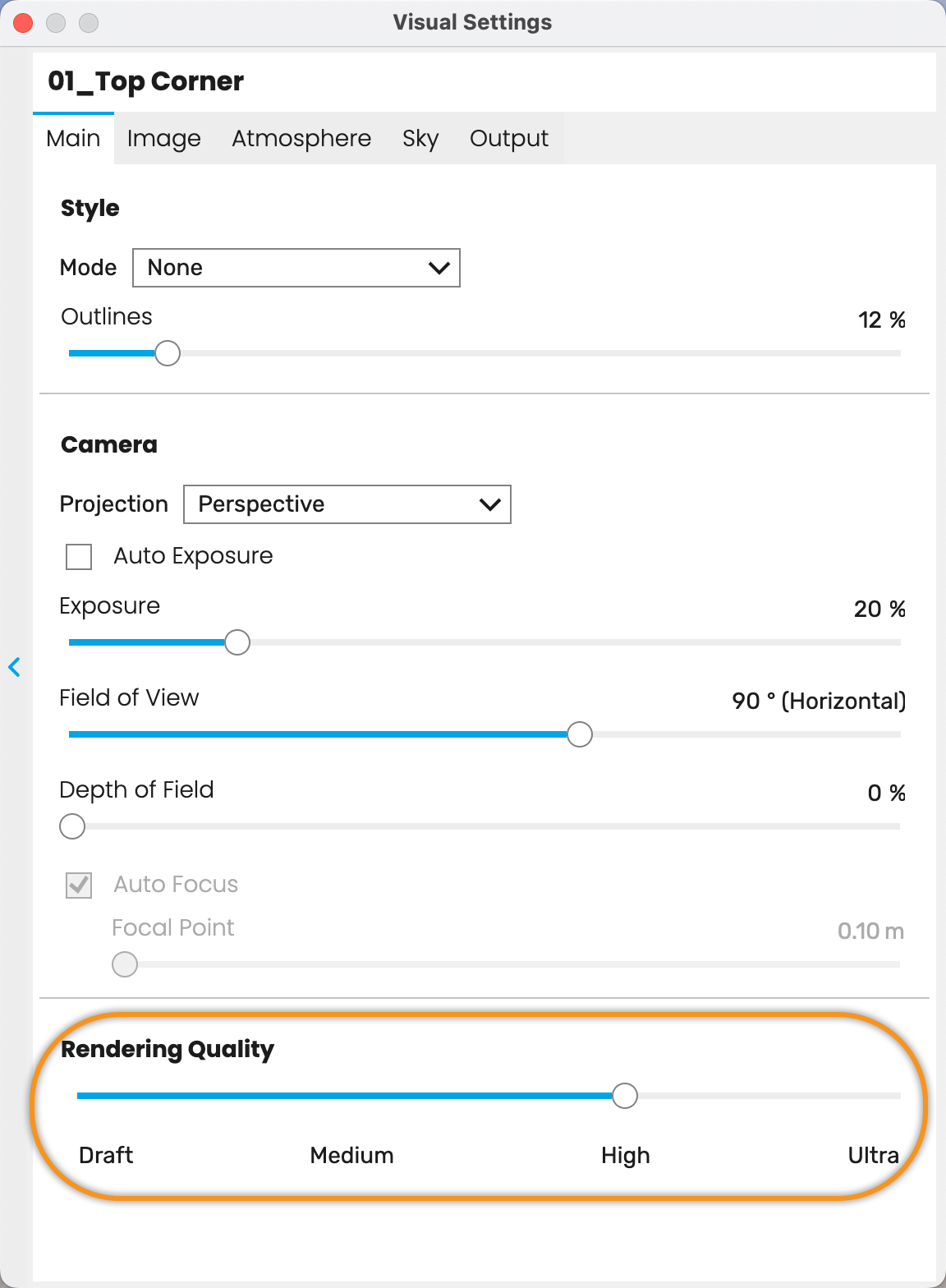

Lower the quality level
Higher quality levels have a greater demand on GPU memory. Depending on your needs, you can reduce the quality level in Enscape. Ray traced sun shadows are available in all quality levels, so it might be an option to switch to a lower quality level to free GPU memory for ray traced sun shadows.

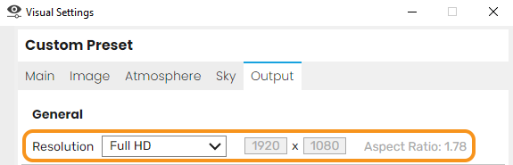

Your screen resolution is too high
You can increase your real-time performance by simply adjusting the size of the Enscape window. However, when you are wanting to render an image out, make sure that the Resolution is set to the desired resolution for the final render, and not set to Window. Here you can see that the Capture Resolution is set to FullHD, which is the equivalent of ‘1080p’. Higher resolutions also increase the GPU usage. When the resolution is changed we not only scale the image that we are generating but also a lot of secondary resources stored on the GPU. These resources help with the lighting calculations or transparency, etc.

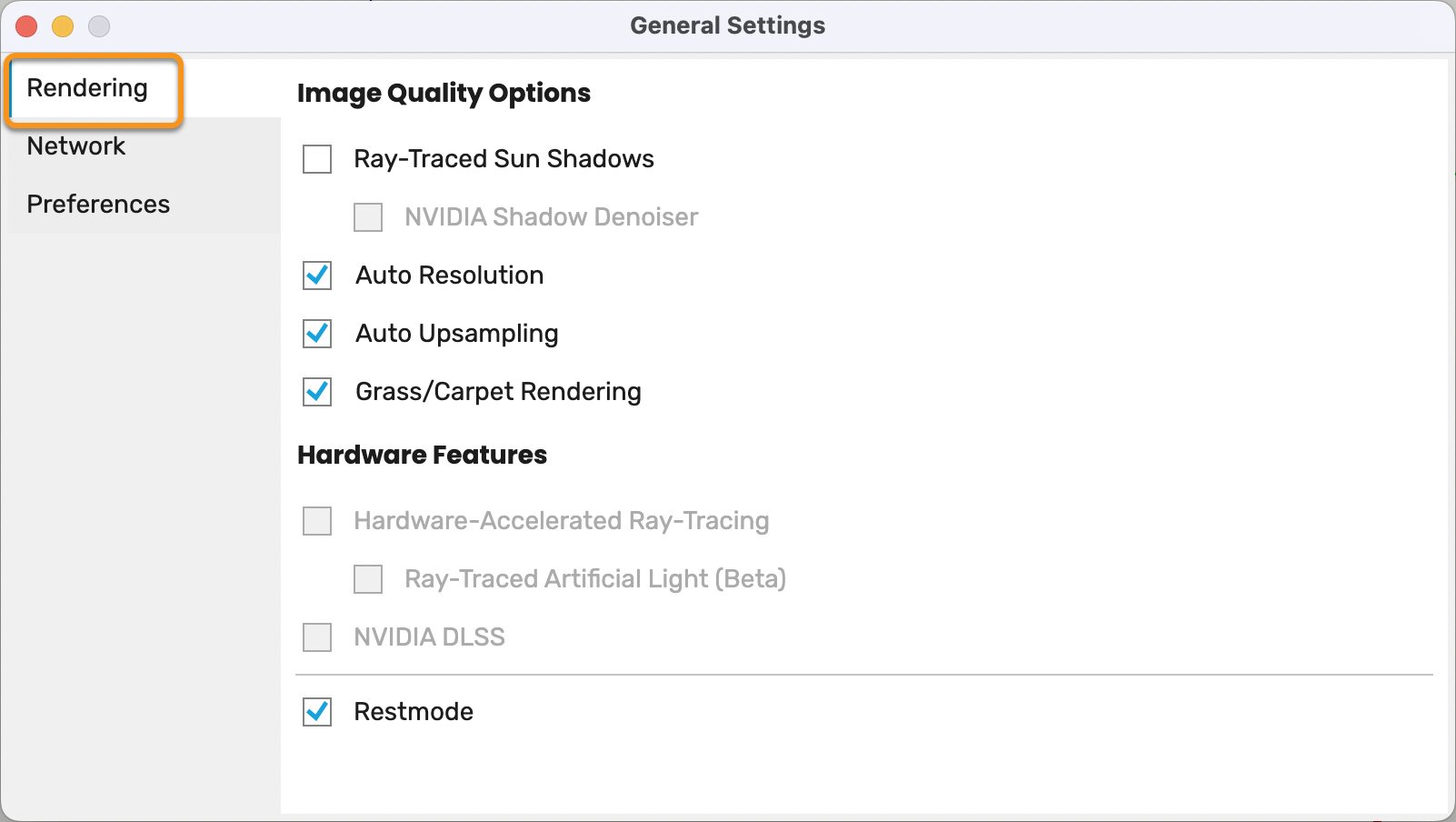

Further Performance Settings
Under the General SettingsRendering tab, Enscape provides further options to enhance performance:
Image Quality Options
Ray-Traced Sun Shadows – Enabling this will enable ray-tracing for sun shadows instead of using shadow maps and will provide a higher level of shadow detail. Semi-transparent geometry will cast shadows with the opacity and tint color, or base color and texture of a glass material, contributing to the appearance of the shadows.
NOTE: this feature may result in a significant increase of the GPU’s VRAM. It’s recommended to disable this feature to resolve issues rendering super high resolution / panoramas / video.
NVIDIA Shadow Denoiser – Reduces the noise in soft shadows along the edges, particularly during camera movement, at the expense of rendering time. The denoiser will not be used in rest mode and for captures. Activate both Ray-Traced Sun Shadows and the NVIDIA Shadow Denoiser for optimal rendering outcomes.
Grass/Carpet Rendering – When disabled, a slight performance increase can be had, but carpet and grass geometry will not be rendered.
Hardware Features
Hardware-accelerated Ray-Tracing – In cases where RTX is causing memory issues. RTX is enabled by default and a restart of Enscape will be required when toggling this feature.
Ray-Traced Artificial Light (Beta) – Enabling this Beta feature will apply Ray-Tracing to Artificial Light sources instead of using shadow maps and will provide a higher level of shadow detail. At High Rendering Quality or above, the effects of semi-transparent geometry are also visible.
This feature may result in a significant increase of the GPU’s VRAM. It’s recommended to disable this feature to resolve issues rendering super high resolution / panoramas / video.
NVIDIA DLSS – Deep Learning Super Sampling is an RTX technology that uses AI to boost frame rates, meaning high resolutions can be used whilst maintaining a solid frame rate.
Auto Exposure needs to be enabled in the Visual Settings when DLSS is activated.
Restmode – When enabled, animations will stop a few seconds after you cease movement in the Enscape viewport. Animated models potentially use a lot more GPU memory than non-animated ones. Switching off wind by reducing its intensity to zero in visual settings also allows Enscape to optimize that and handle animated vegetation the same way as non-animated models and potentially reducing the memory footprint.

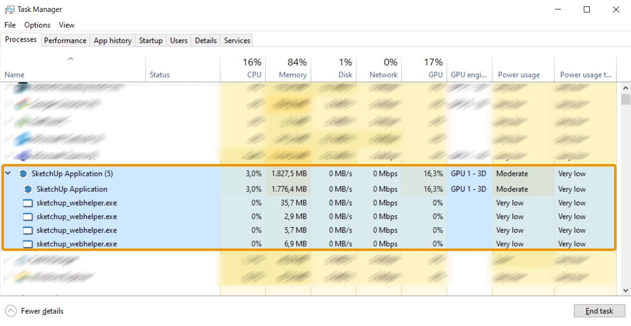

Check the Windows default Task Manager application or the Activity Monitor app on macOS. Shown here is the Process tab, which is the default tab on opening the Windows Task Manager, and you can see this machine is running SketchUp. Enscape is a treated as a slave to the CAD and is therefore not listed. Always look for the CAD you are running to get an idea of what is using the GPU.
Windows Task Manager Process Tab
GPU memory is a shared resource in a computer. All running applications share the same memory. If there are multiple applications running that use GPU memory, closing some of them might free up enough GPU memory.

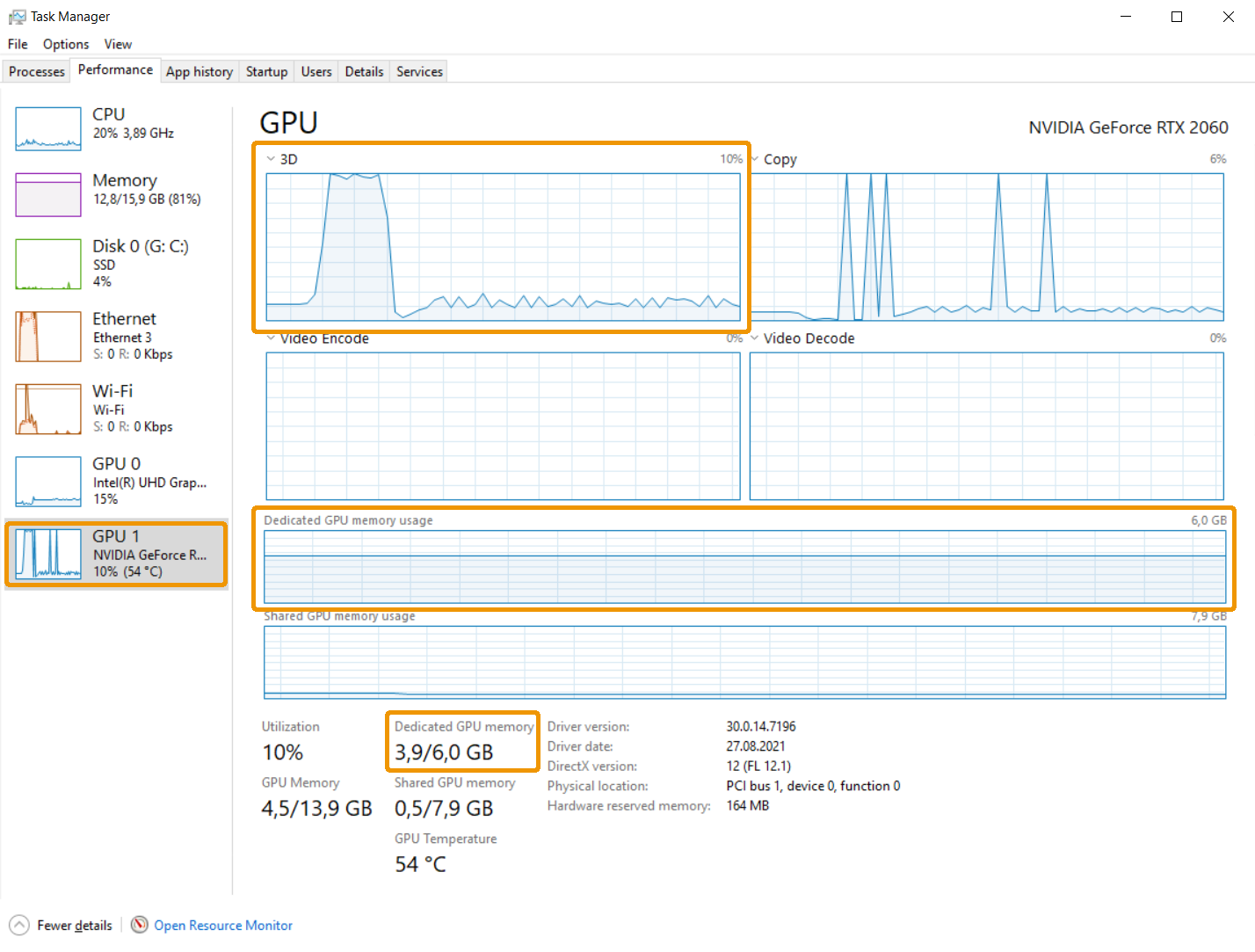

Clicking on the Performance tab will give you a view on the hardware performance. For Enscape, the GPU is the main resource used, and are the areas you may want to observe.
Windows Task Manager Performance Tab

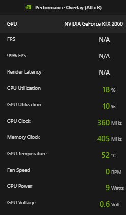

Of course, the Task Manager does not provide any kind of on-screen overlay, so will take up valuable screen space. Therefore, a better solution could be the native GPU software that AMD and NVIDIA make available to its users.
For NVIDIA its either the NVIDIA GeForce Experience package, or the Quadro Experience package (depending on which NVIDIA model you have installed).
For AMD either the Pro or Radeon software is available.
All of the above provide a Performance area that should also be available as an on-screen overlay that can help you monitor your GPU’s performance whilst Enscape is running and may assist you in troubleshooting issues yourself in the first instance.
Example of Overlay (NVIDIA shown here)
