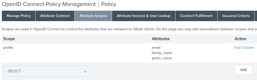

Under Attribute Scopes add profile and select the email attribute manually. Don’t forget to press Add.
Click Next.
