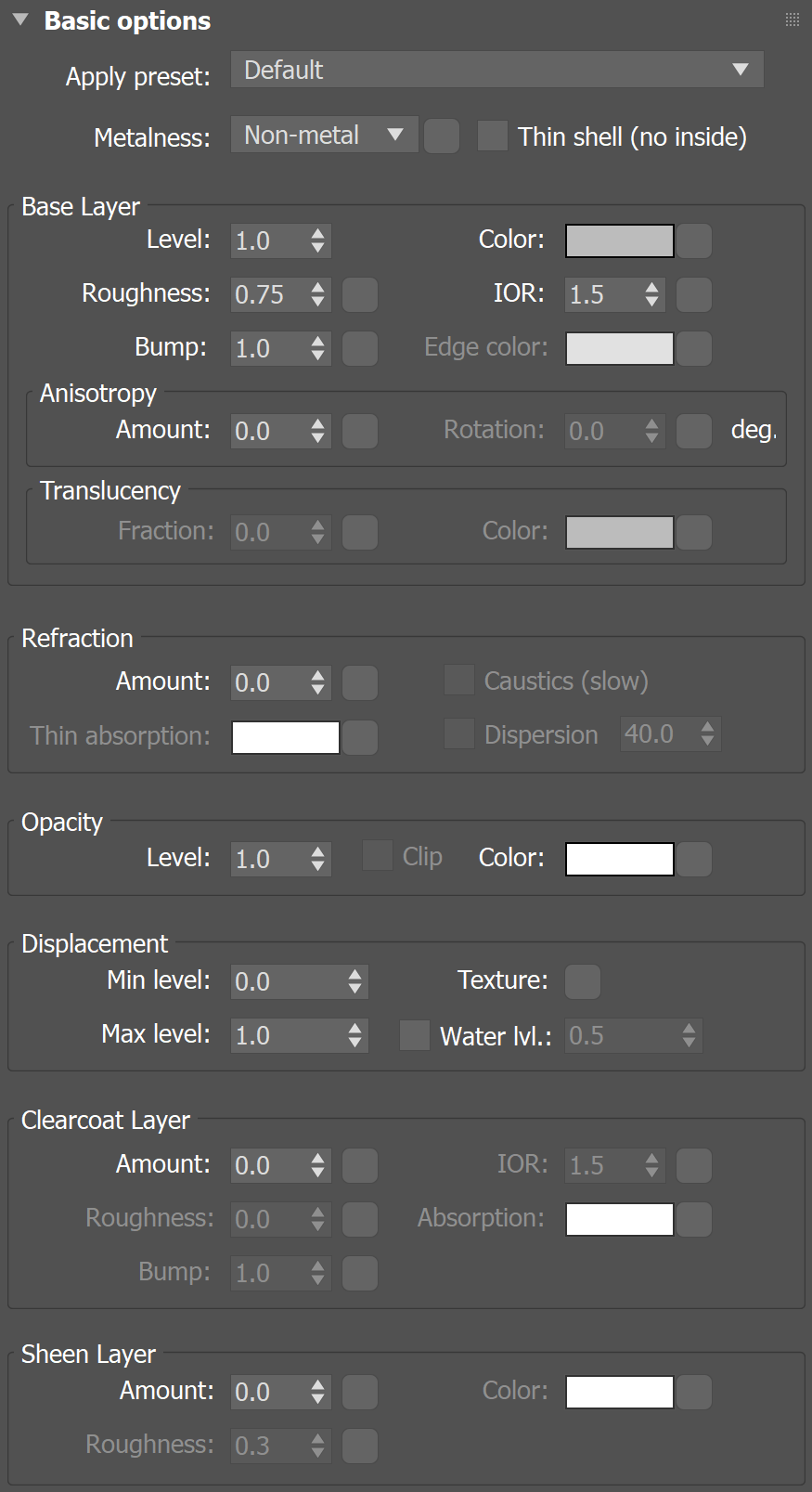

CoronaPhysicalMtl
UI
Native Name
Support
Notes
metalness
(tick)
base color
(tick)
roughness
(tick)
IOR
(tick)
edge color
(tick)
bump
partial
Some features are not supported in Chaos Vantage. See the Bump table.
anisotropy
(minus)
translucency
(tick)
refraction
(tick)
dispersion
(minus)
thin absorption
partial
Textures/maps are not supported.
opacity
partial
Only forced clip mode is supported. The texture can only have fully opaque or fully transparent areas.
displacement
partial
Some features are not supported in Chaos Vantage. See the Displacement table.
clearcoat
partial
Clearcoat bump is not supported.
sheen
(minus)

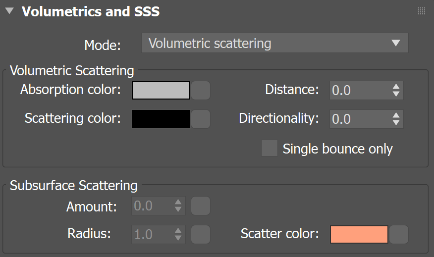

volumetric absorption
partial
volumetric scattering
(error)
SSS
(error)
self-illumination
(tick)
background overrides
(minus)
base tail
(tick)
complex IOR
(tick)

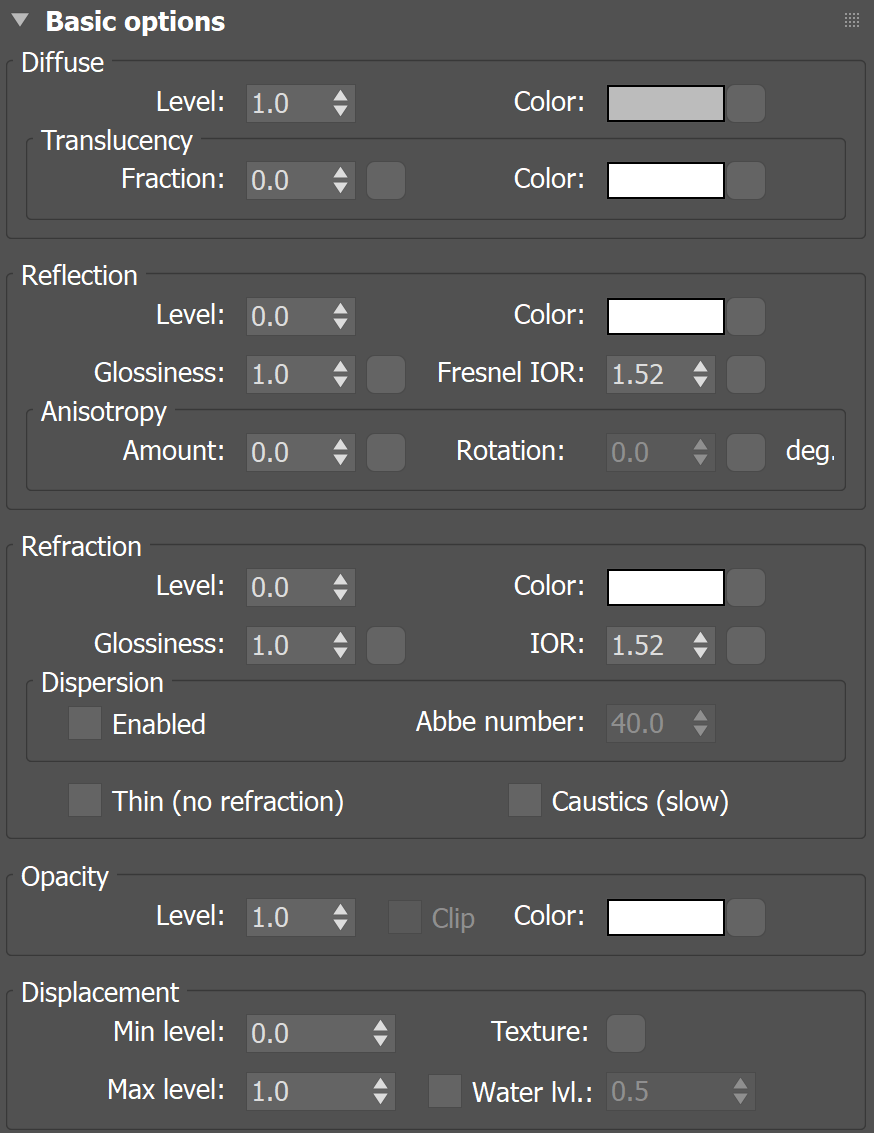

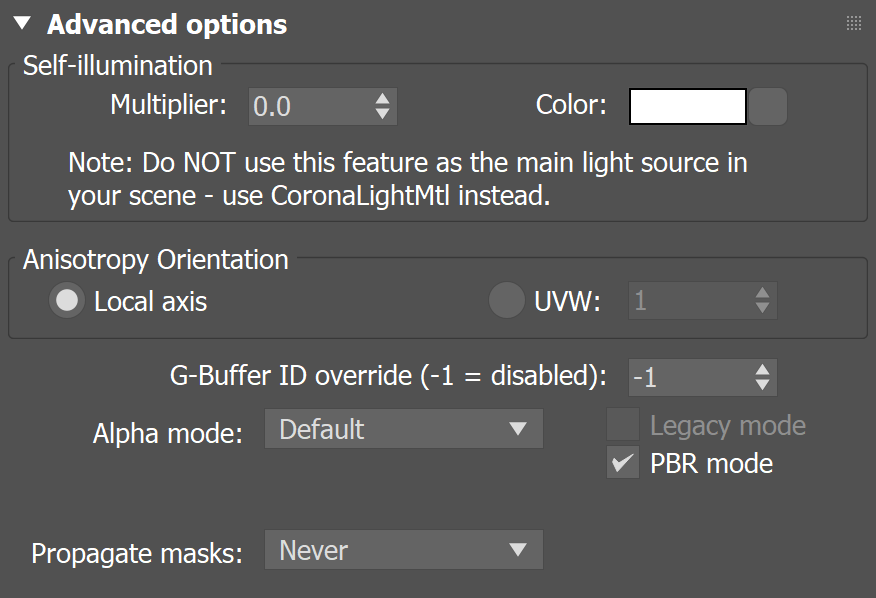

CoronaLegacyMtl
UI
Native Name
Support
Notes
diffuse
(tick)
translucency
(error)
reflection color
(tick)
Fresnel IOR
(tick)
reflection glossiness
(tick)
reflection anisotropy
(minus)
refraction color
(tick)
refraction IOR
(tick)
refraction glossiness
(tick)
dispersion
(minus)
opacity
partial
Only Forced Clip mode is supported. The texture can only have fully opaque or fully transparent areas.
bump
partial
displacement
partial
partial
(error)
SSS
(error)
self-illumination
(tick)
(minus)
