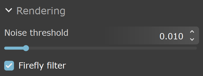

Rendering
Noise threshold – Specifies the noise threshold that determines when to stop refining a pixel. Higher values allow more noise in the image, but the render is faster. Lower values help reduce the noise, but take more time to render. A value of 0.0 traces the entire image unconditionally.

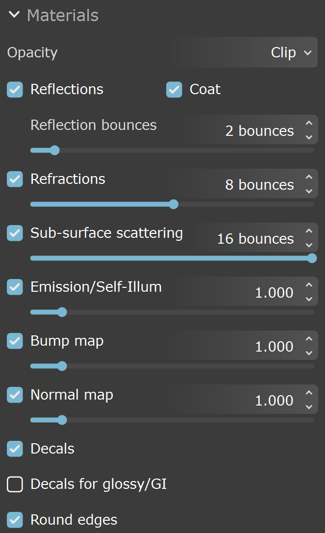

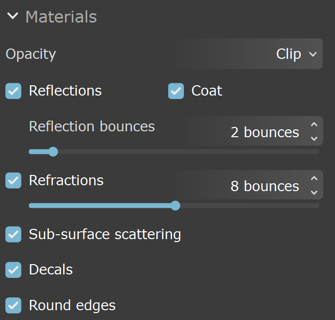

Materials
Reflections – Enables reflections. You can specify the number of bounces for the traced reflection rays.
CoatEnables rendering of clear coat in materials.
Reflection bounces – Specifies the number of reflection depth. Higher values reduce performance.
Refractions – Enables refractions. You can specify the number of bounces for the traced refraction rays.
Opacity map (clip mode) – When enabled, opacity maps are rendered. Note that this option works as a clipper - it is either fully transparent or fully opaque. Only bitmaps are supported for the opacity maps. Option can also be accessed from the top toolbar button (Vantage_TopToobar_ToggleOpacity.png).
Coat – Enables rendering of clear coat in materials.
Emission/Self-Illum – Enables self-illumination in materials. You can specify a global strength multiplier of the emission.
Bump map – Enables rendering of bump maps in materials. When disabled and Dynamic textures is enabled, reduces GPU memory consumption(scene dependent).
Normal map – Enables rendering of normal maps in materials. When disabled and Dynamic textures is enabled, reduces GPU memory consumption(scene dependent).
When Bump map and/or Normal map are disabled and Dynamic textures is enabled, reduces GPU memory consumption(scene dependent).

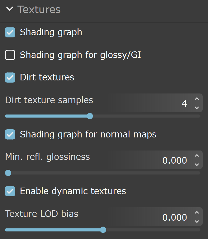

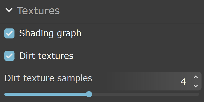

Textures
Shading graphWhen disabled, all materials are approximated for performance. When enabled, the original non-approximated materials are used.
Shading graph for glossy/GI – When disabled, all materials are approximated for performance for glossy and GI rays. When enabled, the original non-approximated materials are used for glossy and GI rays.
Shading graph for normal maps – When disabled, all materials with normal maps are approximated for performance (i.e. remove triplanar UVs or multitexture inputs for normal maps). When enabled, the original non-approximated materials are used.
Min. refl. glossiness – Sets minimum reflection glossiness threshold for the materials. The effect is a faster render.
Enable dynamic textures – When enabled, textures are downscaled based on where are they viewed from. This reduces GPU memory consumption(scene dependent). Texture size is updated if necessary on every scene movement.
