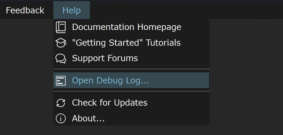

 All processes and events executing in Chaos Vantage are exported to the Debug Log.
UI Paths
||Help|| > Open Debug Log
Vantage_OpenDebugLogMenu

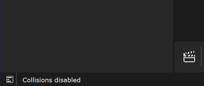

||Status bar|| >
 Vantage_OpenDebugLogButton
Debug Log
You can see all messages and events in the Debug log. You can apply a filter string to display only the relevant messages.

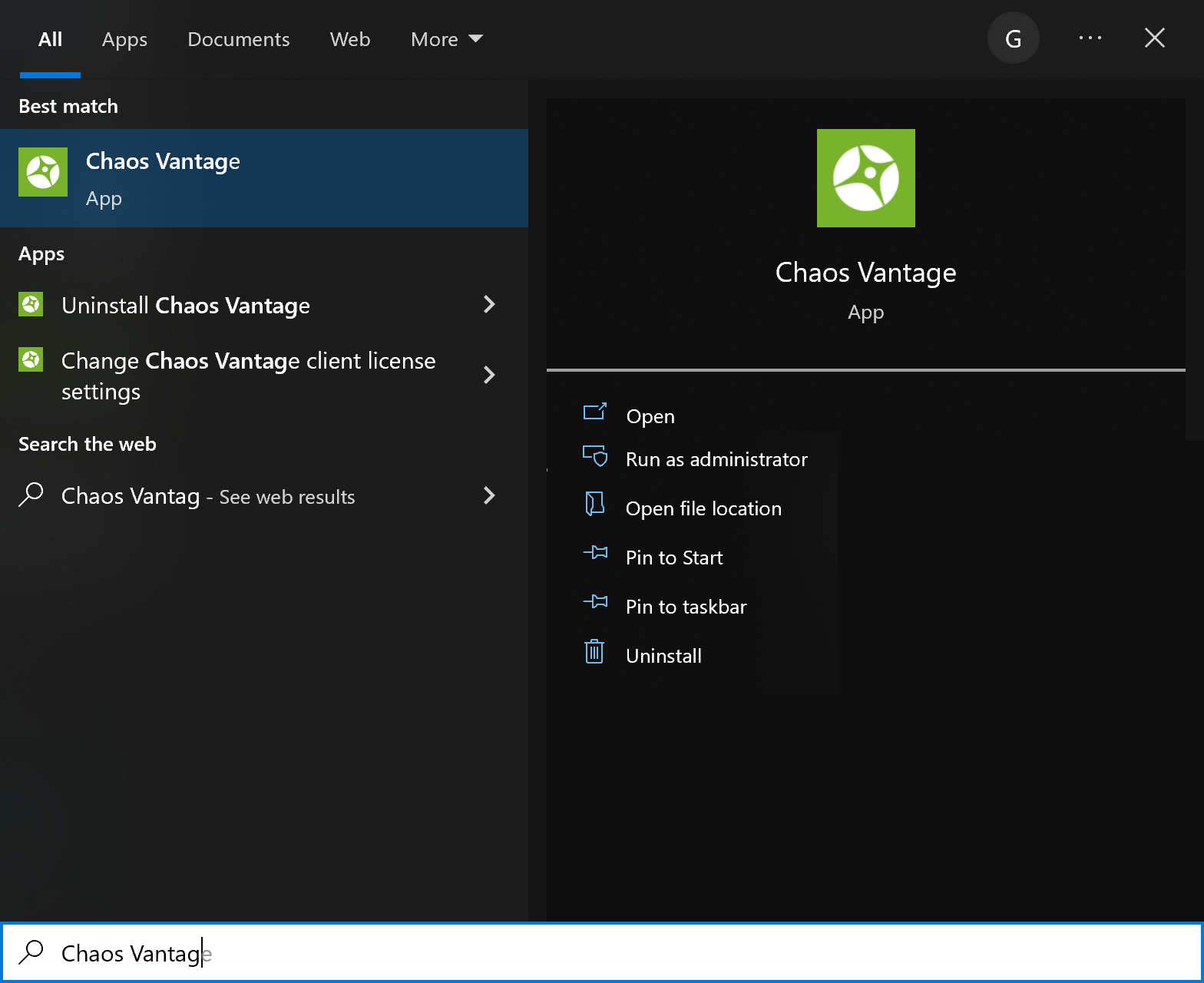

Starting Vantage
If you do not find the Windows Desktop shortcut for Vantage:
  • You can start it from the Windows Start menu > Chaos Vantage > Start Chaos Vantage or search it directly in the Start menu.
  • You can also start it from its installation directory. The default directory is C:\Program Files\Chaos\Vantage where you can find and execute the vantage.exe file.
Note that for Vantage versions prior to 2.5, the default directory is C:\Program Files\Chaos Group\Vantage
