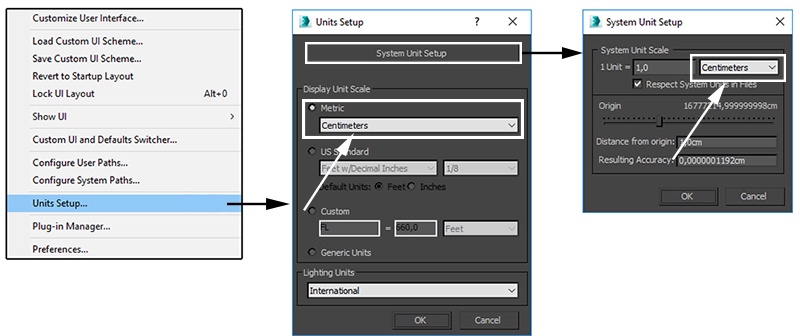

Go to Customize → Units Setup and set Display Unit Scale to Metric Centimeters.
Also, set the System Units such that 1 Unit equals 1 Centimeter.

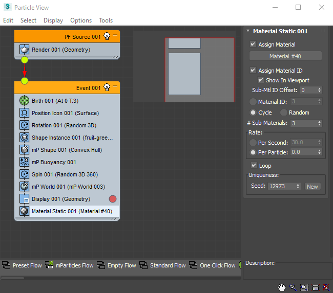

Go to Modify Panel → Particle Systems → and create a new PF Source.
The exact Position of the PF Source icon in the scene is [ X: 0cm, Y: 0cm, Z: 77cm ].

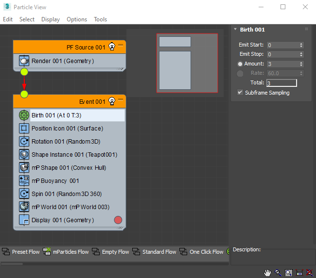

Open the Particle View window.
Add a Shape Instance, mP Shape, mP Buoyancy, Spin and mP World Operators to Event 001.
Select the Birth Operator.
Set the Emit Start and Emit Stop to 0.
Set the Amount to 3.
Set the Position Operator to Surface and keep the Rotation and Spin Operators set to default.
Select the fruit model in the scene as the Shape Instance.
Set the Display Operator to Geometry.

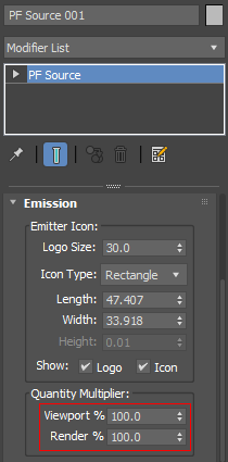

In order to see all particles in the viewport, select the PF Source and set the Viewport % to 100.

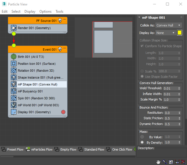

Set mP Shape 001's Collision representation to Convex Hull

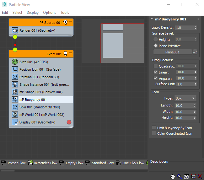

Create a Standard Primitive → Plane.
In the mP Buoyancy Operator, select the Plane geometry as the Plane Primitive.
This plane works as the water surface for simulating buoyancy. Once you are happy with the motion of the falling fruits, you could hide the plane.

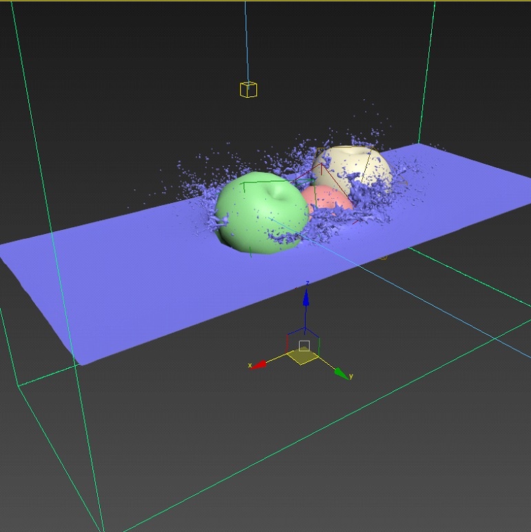

Phoenix Liquid Simulation
With the RBD simulation done, we can continue with the second part of the tutorial.

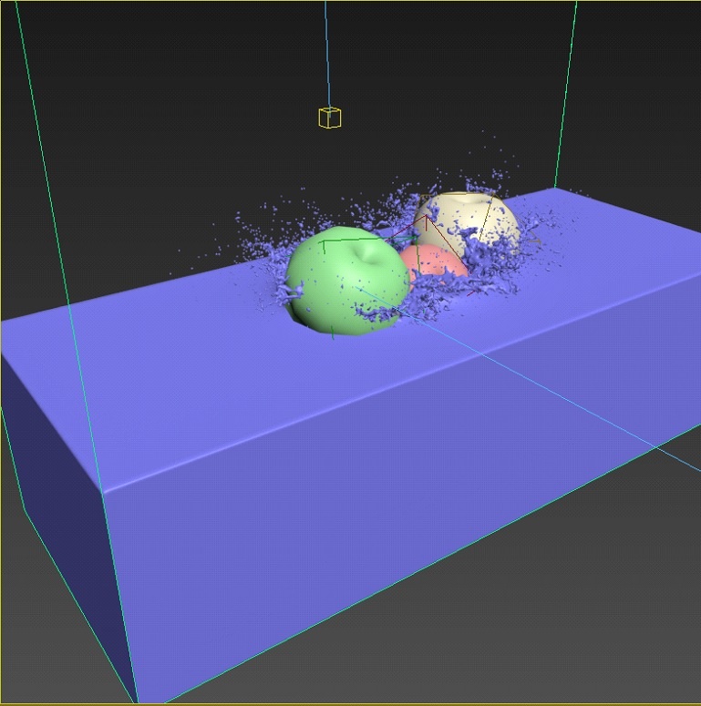

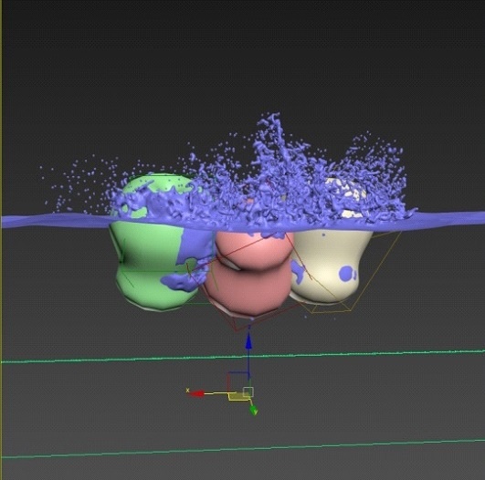

Create a Liquid Simulator that encompasses the animated fruits.
Keep the Container Walls set to Open.
Set the Scene Scale to 10.
Set the Cell Size such that Total Cells is between 500.000 and 2M cells, depending on your machine's performance. Working at a low grid resolution until you've nailed down the general motion of the liquid is a huge time-saver.
The final Cell Size for this example is ~0.12cm.
Go to Simulator → Dynamics rollout and set the Initial Fill Up parameter to 40. This will fill 40% of the container with liquid at the start of the simulation.
Set the Surface Tension Strength to 0.1 (real water has a surface tension of ~0.05 - 0.1).
As the water has to be deep enough for the fruits to dive into and not hit the tank's bottom, and there should be sufficient space for splashes at the top, make sure that the simulator size is adequate.

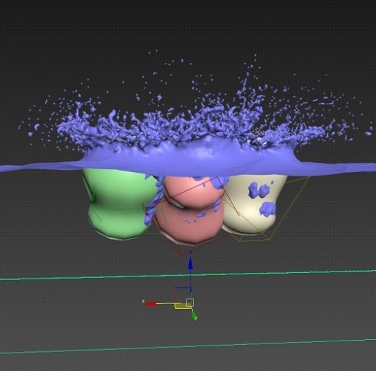

Set the Steps Per Frame to 5.
Higher SPF values will result in a smoother liquid at the cost of increased simulation times. In general, you should try to keep this as low as possible without compromising on the quality of your simulation.

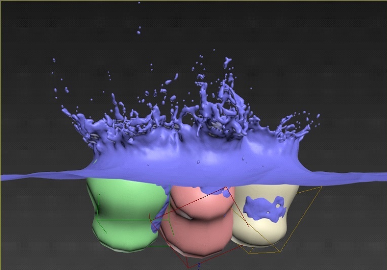

To make the splashes more dramatic, increase the Motion Velocity Effect parameter of the PF Source to a value of 2.
As the name implies, Motion Velocity will inject velocities based on the movement of your geometry, which in turn will make the interaction between the simulated fluid and your objects more realistic.
This value is a multiplier for the strength of the effect.

The following examples show the simulation with different Motion Velocity Effect values.
Motion Velocity Effect: 1
Motion Velocity Effect: 2

Go to the Preview rollout of the Simulator and enable Show Mesh.

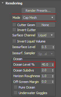

Scroll to the Rendering rollout and change the Mode to Cap Mesh.
Set the Ocean Level % parameter to the same value as the Initial Fill Up % parameter (in the Dynamics tab).
Phoenix's default rendering mode is Mesh - this produces a solid geometry surface. Although it is more realistic, for this example we make an artistic decision to use the Cap Mesh mode instead.
Cap Mesh Mode, on the other hand, won't produce geometry (and thus, reflections and refractions) on the sides of the simulator. Only the upper liquid surface is rendered.

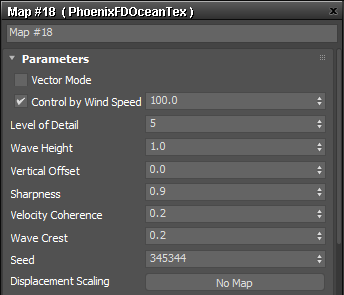

Enable Displacement and pipe a PhoenixFDOceanTex into the Map slot.
The PhoenixFDOceanTex is a special texture map that can emulate wavy water surfaces. It is easier to control and faster to work with than a pure simulation.
Disable Vector Mode on the PhoenixFDOceanTex.
In this particular example, it may produce artifacts in the rendered image if left enabled.

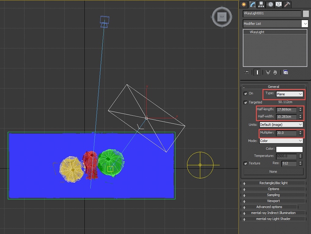

A V-Ray Dome Light is used for ambient lighting.
A V-Ray Area Light placed in the upper left corner of the Simulator is used to boost the reflections and refractions in the water.
Insert → Operator → Material Static Operator.
Enable Assign Material ID and Show in Viewport.
Select the Cycle option and set the #Sub-Materials to 3.
Set the Per Particle Rate to 0.
Enable Loop.
In the next step we will create a Multi/Sub-Object Material and will assign it to the Material slot of the Material Static Operator. This material will be used for shading the fruits.

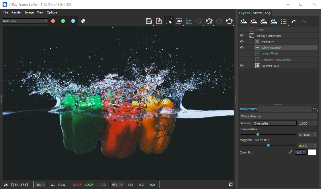

Rendering

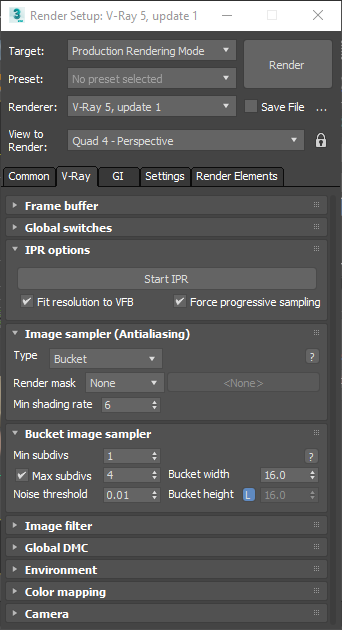

Set the Renderer to V-Ray.
Set the Image Sampler to Bucket and the Max subdivs. to 4.
You can add VRayDenoiser Render Element for your final render to remove the unwanted noise.
The final image can be adjusted in the V-Ray Frame Buffer.
